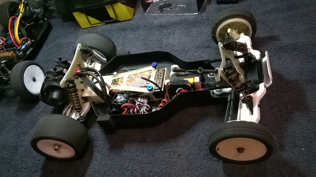

All Quadra arms I have/had are made by I.materialise. Parts are not polished because it's rather pricy process at I.materialise.
Who needs polished arms in a race car? Not me. Quadra parts were made just racing in mind! And after all unpolished surface finish ain't that bad.

Must say, I was quite impressed with RC10-Quadra handling. It's smooth and easy to drive, still fast.
I drove it against my C4.2. Both 8.5T, same gearing, same driver... late at night these were my best results...
Cars: C4.2 / RC10-Quadra
Laps: 16 / 16
Total time: 5:08:76 / 5:14.50
Best lap: 18.69 / 18.81
Avg lap: 19.30 / 19.66
Std dev: 0.355 / 0.358
C4.2 should be faster, I have to do something with the setup :roll: :lol:

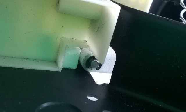

Alright, I got my parts yesterday. I've never dealt with printed parts before and what a weird texture. :lol:
Anyways, it appears the rear bulkhead needs a little notch for the rear arm mounts to fit. Is that correct? Or am I doing something wildly wrong?
Niki
Posts: 524
Joined: Wed Nov 02, 2011 7:32 am
Location: Finland
Been thanked: 45 times
Re: Quadra-symmetric RC10
Post by Niki »
Yes, you need to cut bulkhead corner away.
RichieRich
Posts: 2360
Has thanked: 39 times
Been thanked: 25 times
Post by RichieRich »
Thank you. I went back and looked at the pics on the first thread and now I see it!! :lol: :lol:
JK Racing
Posts: 4619
Location: Placentia, CA
Has thanked: 139 times
Been thanked: 246 times
Post by JK Racing »
I only had to trim a very little bit on my re-re bulkhead to clear the arm.

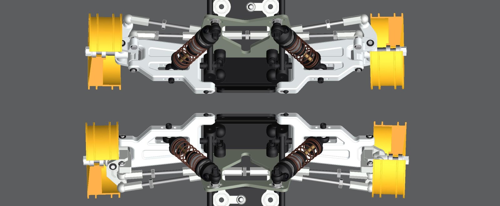

You guys are killing me with all the cool stuff that's out right now!! Question - is the Klein arm setup not quite as long in front as this Quadra arm setup?
- Chris
Lots of cars...so many cars
Niki
Posts: 524
Location: Finland
Post by Niki »
:D
If Klein front arm shares lenght with RPM Worlds Conversion front arm - I would call difference to Quadra front arm... huge!
jwscab
Posts: 6580
Location: Chalfont, PA
Been thanked: 505 times
Post by jwscab »
right, the quadra front arms push a B4 wheel out to ROAR max with the standard length buggy front axles(not the truck axles), using a truck nose.
likewise in the rear with B4 wheels and bones, but b2/10t carriers. then the rear arm and arm mounts are tweaked such that they are the same center to center as the front arms.

Beau S
Posts: 114
Joined: Tue Jan 06, 2015 2:05 pm
Location: little rock
Post by Beau S »
Niki,
So, this design has the front and rear Track width maxed to 250mm, Roar Limit, using B4 drives, hub, hex, and std rc10 front casters with OG inline axles?
I read thru all 4pgs and saw this kinda scattered through comments. I'm just dbl checking the width, and strict need for the front suspension components.
thanks ;)
mk-Zero
Business Member
Posts: 1678
Location: Orange, CA
Has thanked: 4 times
Been thanked: 21 times
Post by mk-Zero »
Beau S wrote:Niki,
thanks ;)
Joey's car was outside the limits, might want to check with him...
http://www.rc10talk.com/viewtopic.php?f=35&t=38746&start=15
Niki
Posts: 524
Location: Finland
Post by Niki »
2nd post "2. PARTS" includes all needed parts. IF rere-Worlds kit #6002 part can't be used, replacement part is listed below.
