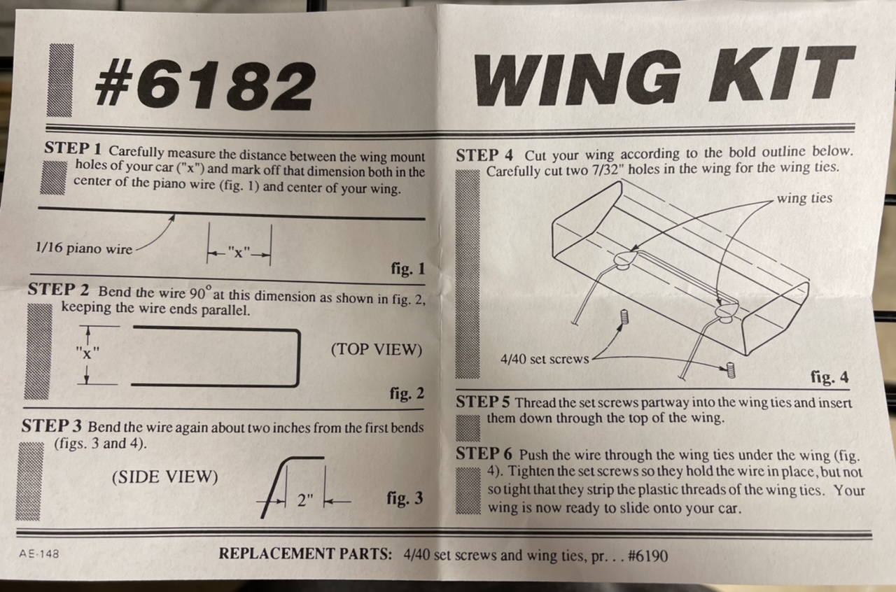

While doing my rebuild, i can't figure out how to attach the wing mount. it wont stay in the tubes. it jsut slides. Is there a water or somehting??? and how do i mount a wing onto the mounts?

if you are talking about wing wire, the hot trick is to put a bit of a curve in the wires that feed into the tube. Either a slight 'C' or 'S' in the wire will allow it to grip the inside diameter making it difficult to remove.
as for mounting the wing to the wire, hopefully you have the wing mounts, also called 'wing things' that connect the wire to the wing. small plastic or aluminum buttons. you drill holes in the wing, pass the buttons through each hole, then slide the wing wire into the button on the bottom side and secure with a set screw.

Are you winging this without any instructions? Page 19 of the re-re manual explains it better than the original.
https://www.teamassociated.com/pdf/cars_and_trucks/RC10_Classic/RC10_Classic_Kit/manual_RC10Classic_2013.pdf
Also, he wing wire will be loose in the aluminum wing tubes. Give the ends a tweak with some pliers so they stay in snug.

Ahh now i understand. Oka, thanks a bunch! now i just got to make sure to drill the holes straight and all. Buut seems soooo inconvenient to do all that for the wing. but what evs. My rebuild is coming along beautifully! got the rear wheel conversion to 2.2 rims and works perfect! also switched out the old yellowed rear arms for my whitened ones i soakedin peroxidie but now i should find arms with a hole for a rear sway bar! i noticed my old ones had a sway bar mounting hole and the newly whitened ones don't! but its fine, im soaking the old ones in peroxide now so im gonna look at them when i get back from school.

The RC10 manual refers to "instructions in the wing bag".
Does anybody have a copy of these instructions?
In particular I wonder if those instructions give measurements for where to bend and cut the wing wire.
- Does it give specific measurement for where the bends should be in relation to one another?
- Does it give instructions on how long the "legs" of the wing wire should be for correct wing height?
Or is the builder supposed to make their own measurements and determine their own wing height?
Thanks!
Thanks!
-dldiaz
- morrisey0
- Posts: 1804
- Location: Richmond, VA
- Has thanked: 87 times
- Been thanked: 1853 times
Re: How do you mount a wing??
Yep, you just "wing" it.
