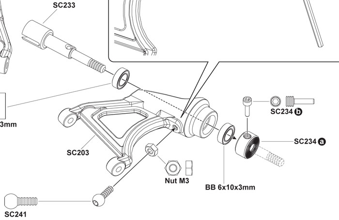

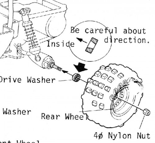

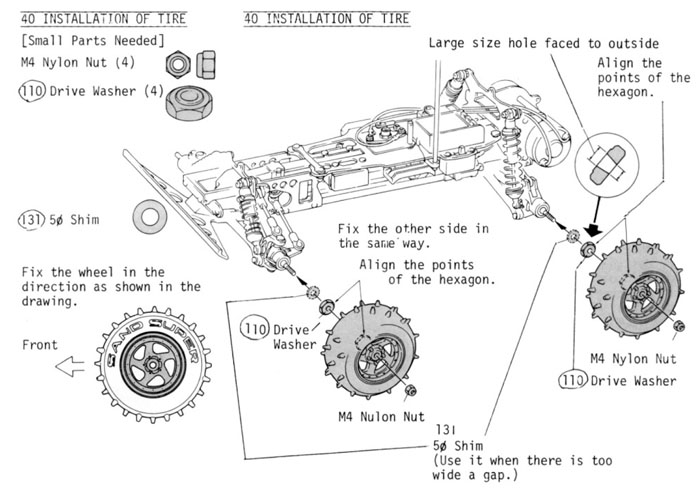

Yes, they did. The rere Scorpion's "drive washer" has a locking pin, while the old one rely on a "conical" lock, or what ever it's called.
The original Optimas did already have a hex "drive washer", and not the same pressure "drive washer" as the Scorpion, although it still had that "conical" lock like the Scorpion. So since they dropped the "conical" lock for a locking pin on the Scorpion, it will be very strange if they didn't do the same on the Optima.
Scorpion old
Scorpion new
Optima old
