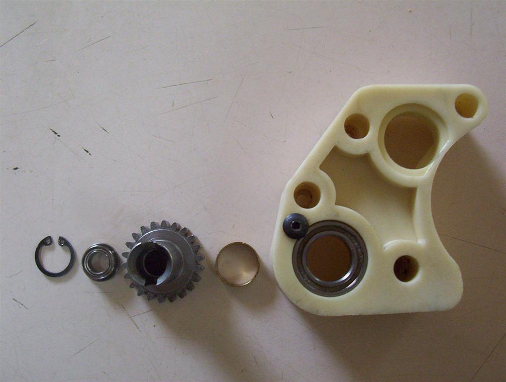

I worked over a 6 gear last summer that I had assembled with inner bearing races for the out drive bearings also, along with 3/8 x 5/8 outer bearings.
Previously I had assembled both bearings on the shaft without the out drive, then cut the shaft until it sat just below the second bearing race. I wanted the button head to really secure the inner races. What I found upon close scrutiny was that the flanged bearing was not tight in the out drive, and rocked against the c clip. This was on a thorpe 48p set, so this poor tolerance may not be present on the AE parts. I felt it needed further experimenting.
What I did this time around was to omit the inner races. Next, as before I cut the shaft (on the spine plate) so as to be flush with the flanged bearing, then just a bit more so the button head would secure the inner race firmly. It was necessary to cut the internal threads a bit deeper with a blind tap, and also cut the button head bolt very short (green loctite). Next I had to secure the outer race to the out drive. To do this I used an oilite bushing 3/16 x 5/16 plain drilled out (size was 1/4" by memory) to clear the button head bolt, which had to have its button reduced in diameter as well for clearance. A shim was placed between the bearing and the bushing to take up play. Finally, a 1/4" rear axle shim was used to secure the flange of the bearing against the C clip. I sanded the thickness of this shim until the C clip had to be forced into it's groove, ensuring a secure fit. It was a lot of work, but it resulted in a rock solid assembly, and the brass shims are not necessary. In theory the brass shims should ensure perfect alignment between the two bearings, but this assumes a perfectly square tube can be cut, and would ideally include a method of pressing the 3/8" bearing against the shim, like with a wave washer and c clip installed in the 3/8" bearing bore.
I hope you could follow all that, maybe it would have been faster to tear down the tranny and take a picture!

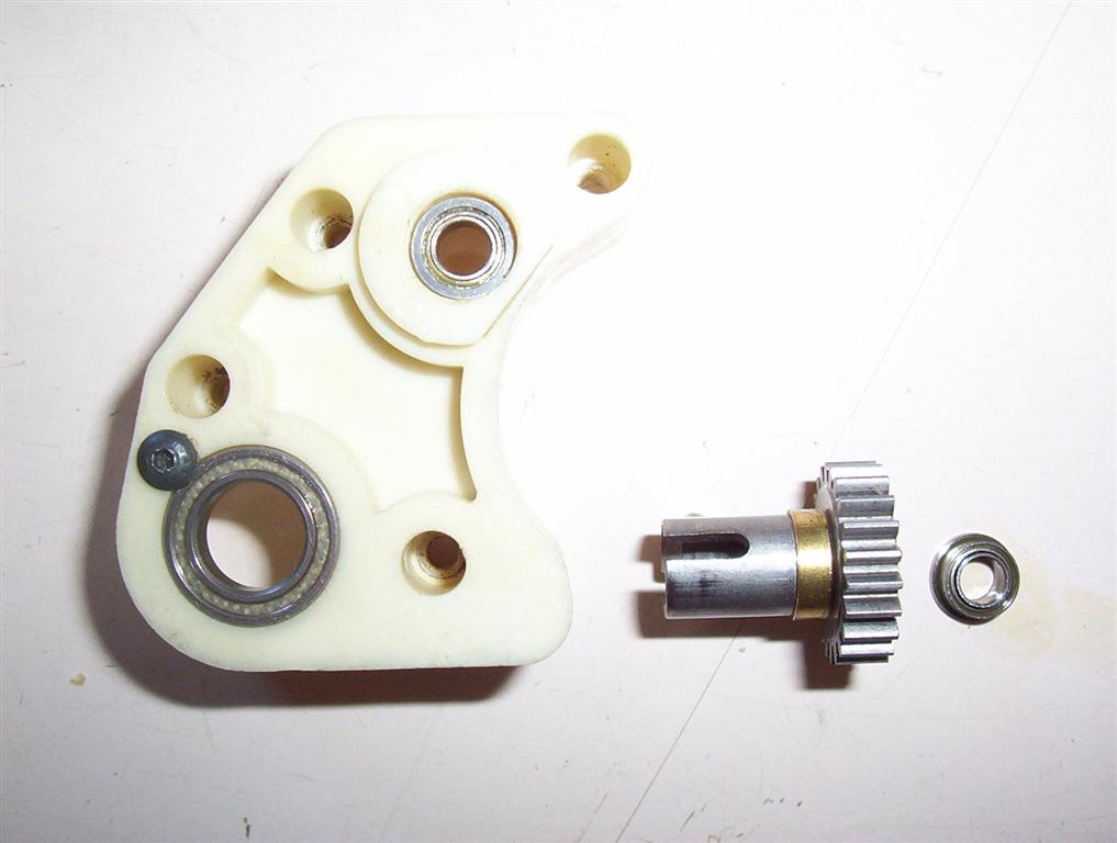

One thing I found when building a 6 gear, was the four bolt holes for securing the cases to the motor
plate.
They can be out of alignment, so I held the cases together and re-drilled the 4 holes, so the bolts can
pass through the cases and not pull it out of alignment.
I think you are right about the tolerances, I believe the out drive bearing conversion, is simply to keep
the out drives in alignment with the idlers, thus making the idlers last.
With the mods I have run my 6 gear Oval racer on the street on rubber tires, using a 6.5 turn Brushless
system, with no problems.
I am using the ASC6614 black idlers, but I would think the re-release idlers should be as good.
Here is a pic, I won't be using the circlip.

The outdrive bearing mod is good for a couple reasons. One, the bearing is larger and stronger. Two, you spread the contact bearing points making angular misalignment much less initially and over time.

You don't need brass spacers to replace the bearing on the bottom outdrive gear, just dismantle the existing ball bearing and just use the inside and outside races.
I use white lithium grease or wax (chapstick) for lubing gears.

Hi,
The brass spacer is not replacing a bearing, it is a shim to stop the out-drive moving outwards.
Here is a pic with the spacer fitted and all the needed parts.
