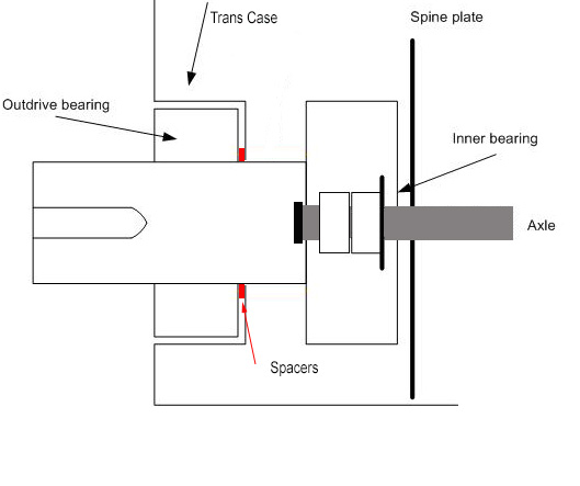

Opening up an old one here. I am getting into an outdrive bearing mod as I put my 6-gear back together tonight, and I thought I was just slapping a bearing where there was a felt pad and a cap, but it is more than that as I read further.
So, the brass ring (or bearing inner race) is installed to hold the outdrive in same lateral position because the non-flanged bearing was removed from the outdrive. So, was the bearing removed and brass ring installed so you could dial in the depth and keep the bearing flush to the outside of the trans case? I am just not seeing the forest through the trees on the bearing removal and brass ring install. And is it not just as simple to leave the inner bearing in and just space the bearing out so that it is flush? Is using the trans case as spacer support not a good idea because of wear? TBH, my bearing is super tight going on the trans case, so I really can't see it moving in and out anyways.
Oh well, I am sure I am missing something obvious here. Just not sure what it is right now.
jwscab's awesome diagram:
spacer diagram:
In looking at my diagram again, the spacer could be pressed against either the inner or outer bearing race, so maybe against the outer would be better.

There is a big gap in the case where the outdrive is. If you don't add a spacer, the outdrive can wander in and out. The spacer or bearing race keeps the outdrive centered. You can build it without and see what I mean.
In the normal assembly the stacked bearings ride against the bolt you install inside the outdrive and keep the outdrive secure.

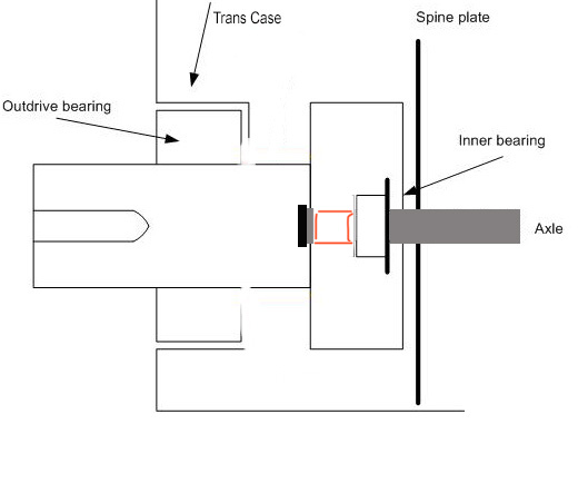

Posts: 11312
Has thanked: 818 times
Been thanked: 2398 times
Re: Rebuilding the 6 gear transmission.
The reason for removing the non flanged bearing to install the outdrive bearing is because the tolerances are not good on these cases, you are basically allowing the outdrive to sit off axis as necessary. Three bearings over constrain the assembly. The screw used to hold the non flanged bearing so the outdrive can’t walk. Without that inner bearing and screw you need that brass tubing.
One thing I haven’t tried yet but in my head would work is to remove the outer portion of the unflanged bearing leaving just the inner race. Reassemble using the outdrive screw and that inner race as a spacer. If it holds in place like original (but obviously will now wobble around until the outdrive bearing is installed) then you are golden. The load will still be on the inner bearing like stock, vs on the outdrive bearing using the brass tubing
Embarrassingly terrible sketch showing what I mean…

jwscab

Yep that works nicely.

GoMachV wrote: Fri Sep 02, 2022 3:34 pm Three bearings over constrain the assembly. The screw used to hold the non flanged bearing so the outdrive can’t walk. Without that inner bearing and screw you need that brass tubing.
Okay, a little clarity hit. With the new outer bearing, you now have three bearings trying to center the outdrive, and all of them working perfectly together isn't going to happen. So the non-flanged bearing is removed to make it a simpler two bearing system.
Posts: 2976
Has thanked: 229 times
Been thanked: 1742 times
GoMachV wrote: Fri Sep 02, 2022 3:34 pm One thing I haven’t tried yet but in my head would work is to remove the outer portion of the unflanged bearing leaving just the inner race. Reassemble using the outdrive screw and that inner race as a spacer. If it holds in place like original (but obviously will now wobble around until the outdrive bearing is installed) then you are golden. The load will still be on the inner bearing like stock, vs on the outdrive bearing using the brass tubing
This is the method that I use. I actually have a stash of worn 3/16 bearings just for this (to cut the inner race from).
