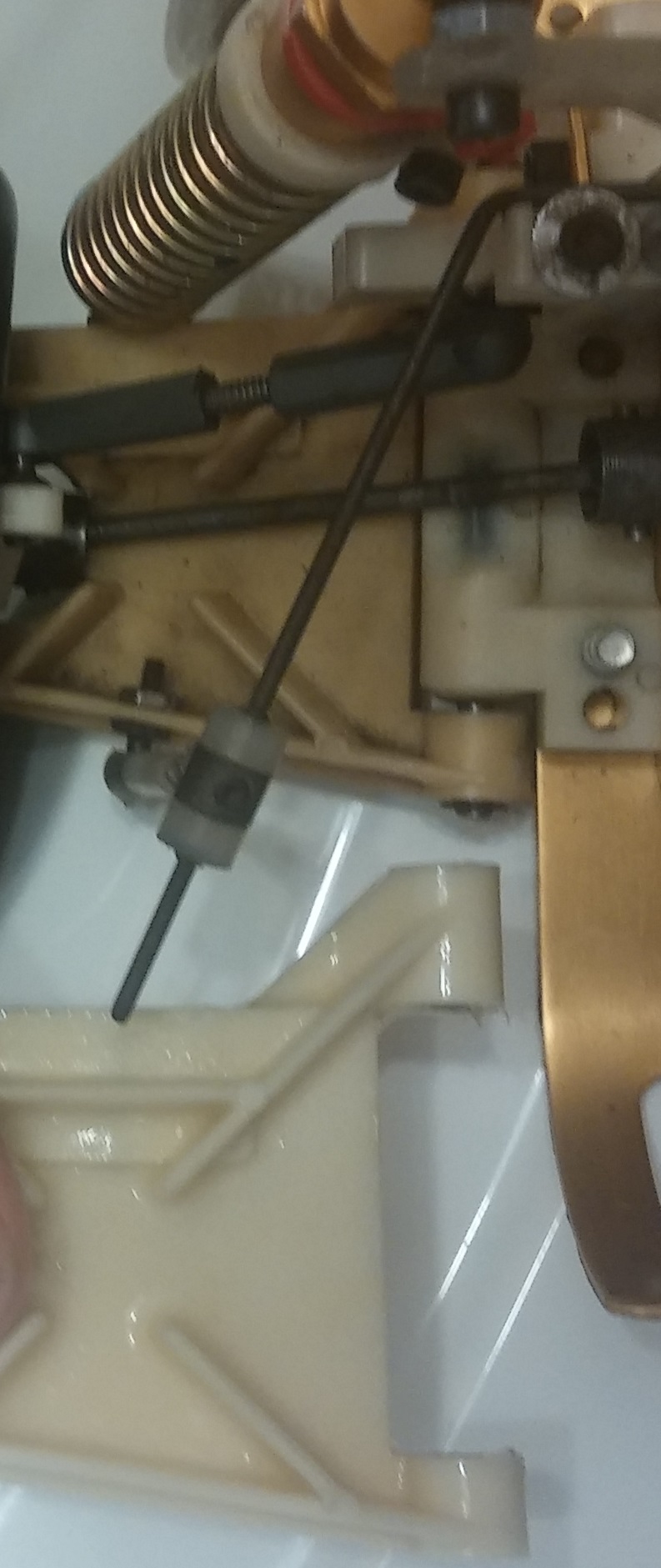

So, im reading all the way to the last post, and i cant figure out what to do now. I do have extra parts id like to really try this on. SO what exactly do i do? Do i just Soak in Peroxide for however long, then rinse? I dont want to boil to prevent harm to the parts and re-yellowing them. how would i be confident enough that i can put them on my Gold pan?

if you are patient, it should be fine.
soak in peroxide, and add some UV, sunlight takes a bit more time than a UV bulb, its a slower process but probably a little more gentle. to be honest, this is a pretty brutal reaction taking place, the uv breaks down the h202 leaving active oxygen, which is pretty aggressive no matter what. Once you have achieved the desired color, then transfer to a warm water bath, or wash, then leave in another fresh batch of warm water to thoroughly remove all traces of h202. the longer you leave it in, the better, and be sure as Marlo mentioned before, pop all the air bubbles and really try and flush the nooks and crannies.

Okay, so a UV light, if its a regular blub, I have a bulb. But if not- it's okay- I'll use sunlight. During the process, do I cover with plastic wrap?After I have the color I want, do I rinse them in a warm water bath first? Do I use any soap? Then After that, a second bath? I understand popping the holes and all. So how long would you guestimate the second bath? I'm planning on using these parts on a car I'm going to restore for my father or if I happen to break a part on my Gold Pan, I'll use it for a replacement part. I'm going to really be using my car when I finish my car.jwscab wrote:if you are patient, it should be fine.

You can cover just so you don't lose liquid to evaporation. I would say a good 24 hr soakbut whatever you feel comfortable with. Just rinsing with tap water is fine.

so i did it for probably 12 hrs cause it was cloudy. but kept it under a light. What a difference... That moment, when the test parts you used, that were gonna be replacement parts for when you break a part, looks better than what is on the car now. lol. after the peroxide, i rinsed them all with warm water and now they are sitting in a warm to hottish water.

Okay, so im more than pleasedwith the results i got on my parts. was able to have some more partssoak in peroxide in the bright sun. And bot i wish my car was in pieces so i can make all the parts like this. lol. when i do get any chance, ill do it piece by piece. But anyway, Ive had the parts soak in warm baths for just about 2 days. Constantly brushing the parts, and cleaning them, then re-soaking again. i just did it again. when can i be sure that the pereoxside is fully out of the parts? one of them is a battery holder so i want to make sure its COMEPLETELY peroxside free.

I tried this with my AE parts. Used a UVA light, incandescent. This is after ~16 hours. The gear is for comparison. I'm pretty pleased. They don't seem brittle or have their strength affected in any way.
I put them in a heat resistant glass over the light, and put a loosely fitted lid on. The peroxide got hot, but not boiling.
Ignore the Worlds Car, its untouched. The Andy's and RPM pieces are new, but all of the AE stuff other than the front suspension mounts is vintage and had this done to it.
