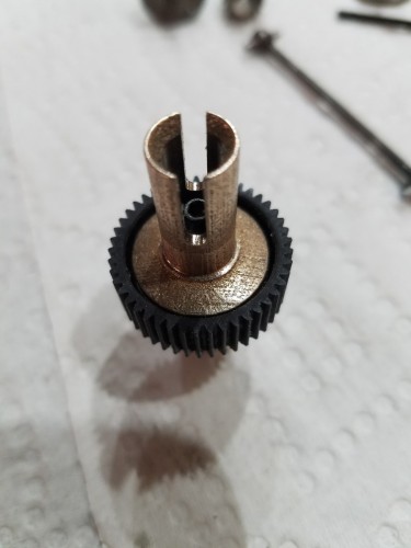

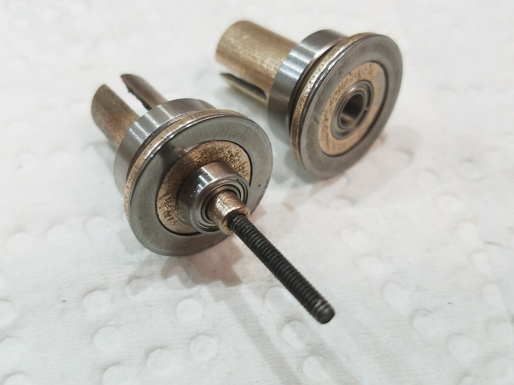

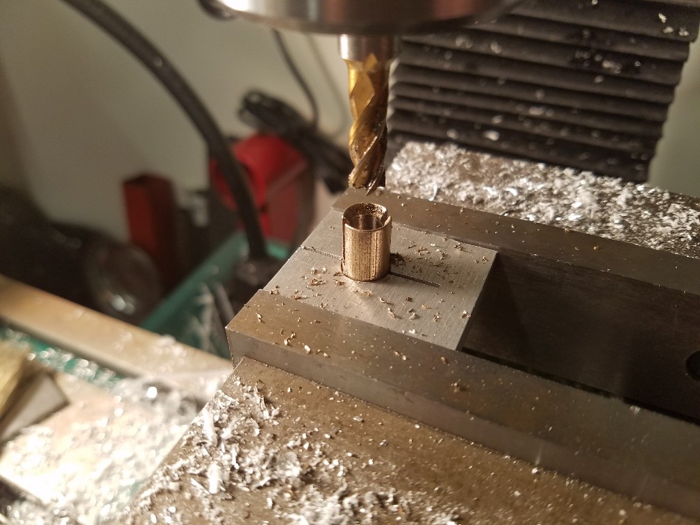

Shapeways says +/- 5% + 1 layer, so as far out as some of the features are, they are within their stated tolerance. I will probably adjust the models some though, and then ideally just clean them up on the mill and lathe.
Tonight I got them all sorted out except the drive pin slots. Those were my mistake, I accidentally made the slots .080" wide, should have been .104", but then they printed undersized on top of that, at like .070". I had to order an end mill bit to slot them, it's arriving tomorrow. And last night I made a fixture to hold them in my mill vise.
Everything except the slots fixed By this weekend I will have the slots fixed and have them in my RC10M, and then I'll abuse them on the street and see how they hold up. Then we'll go from there.

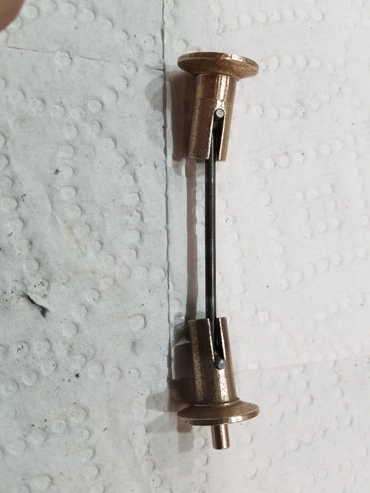

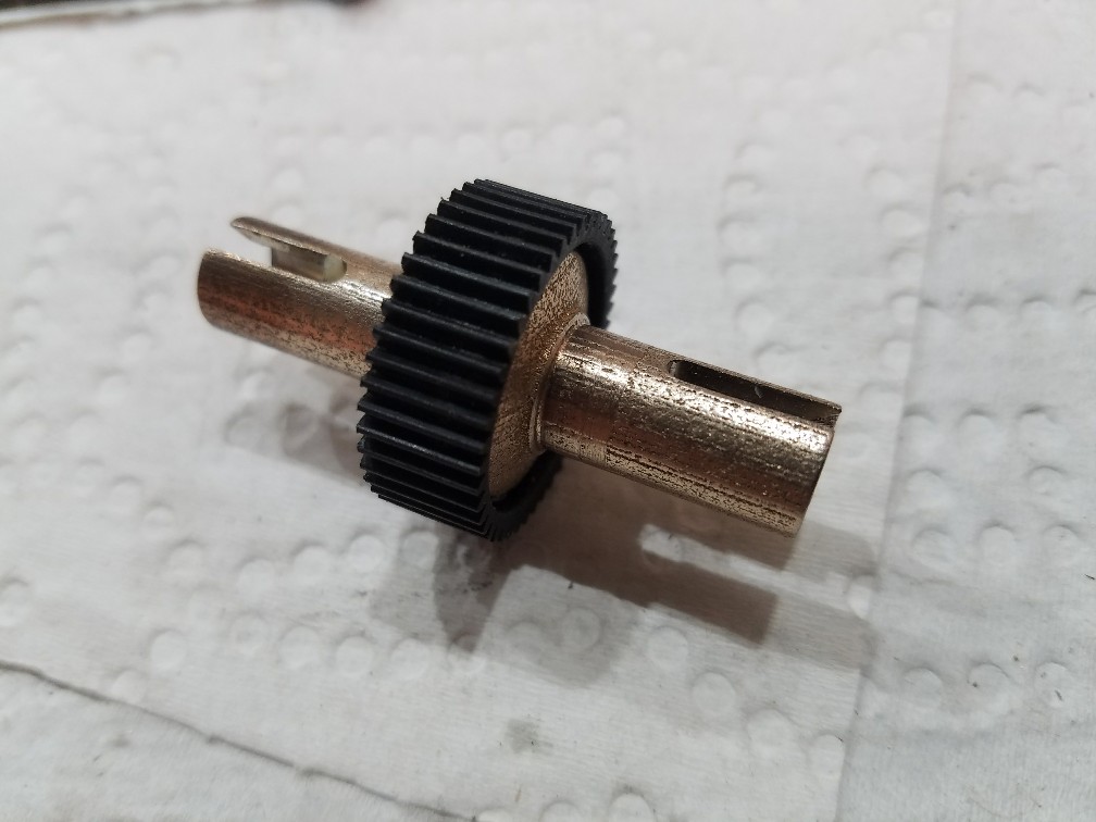

So tonight I machined out the grooves. The bones fit in them really nice now and spin and articulate smoothly.
Then I went a head and assembled the diff. Went together nicely. The feel is a little inconsistent, I think I am going to need to flatten out the raised areas that the drive rings sit on. That will be easy once I have my lathe.
In the mean time, I'll put this diff in the car and start abusing them, see what they do.
