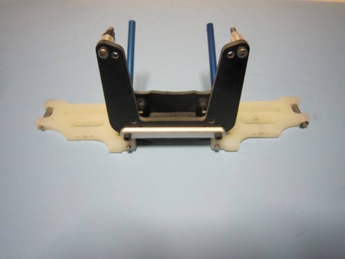

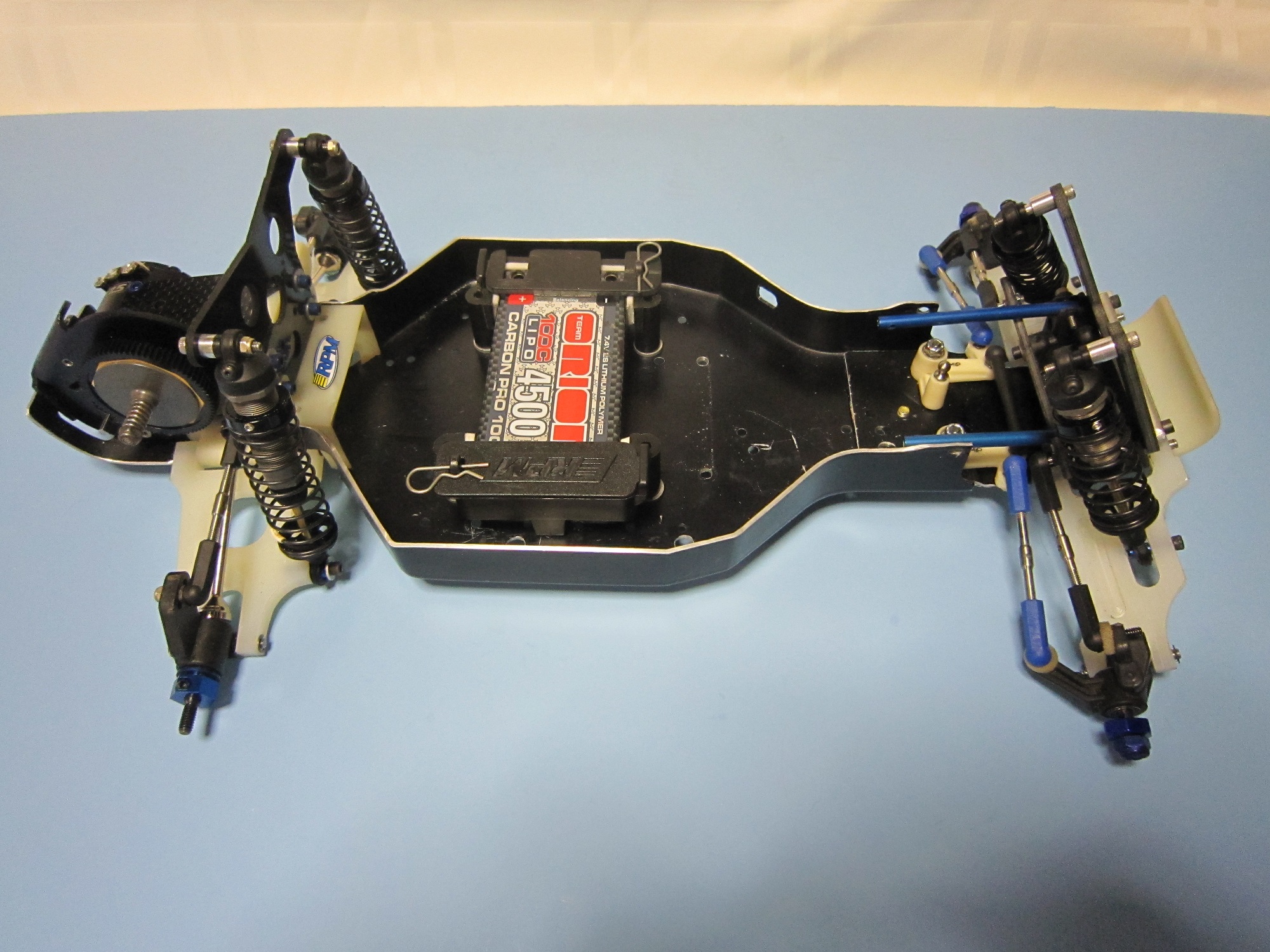

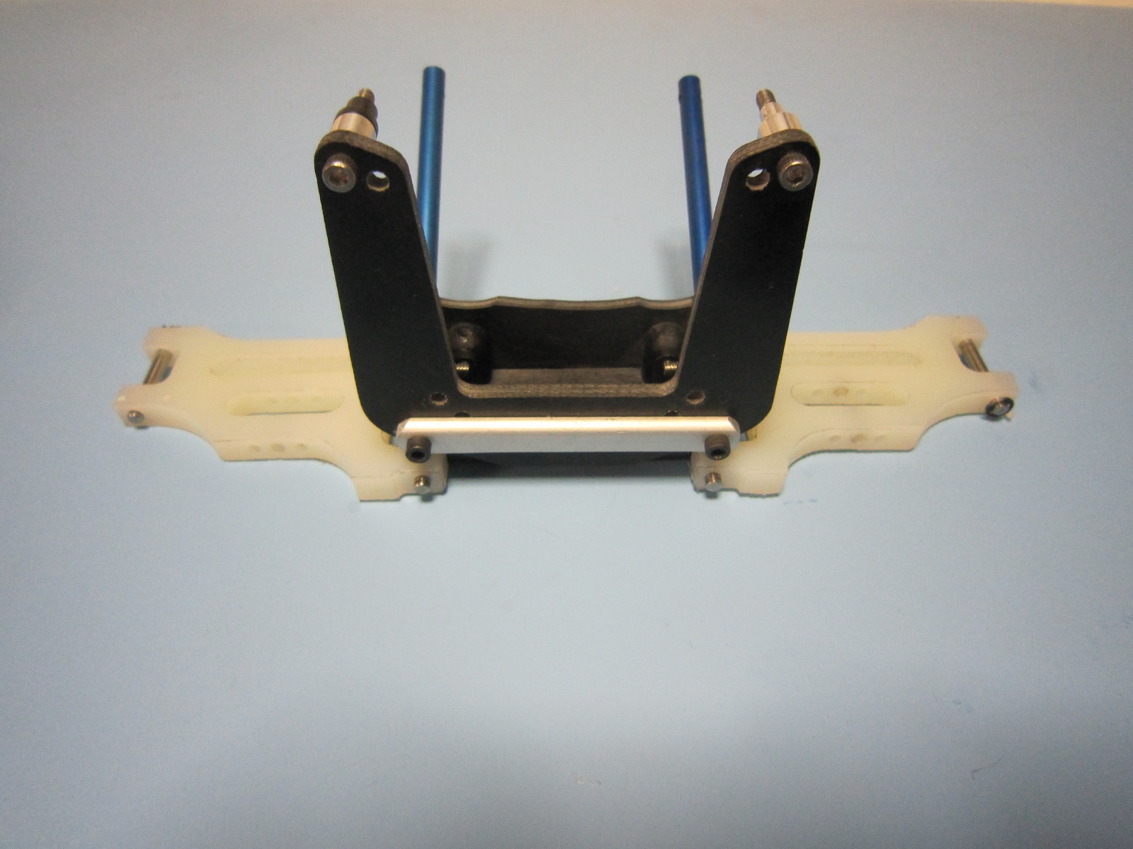

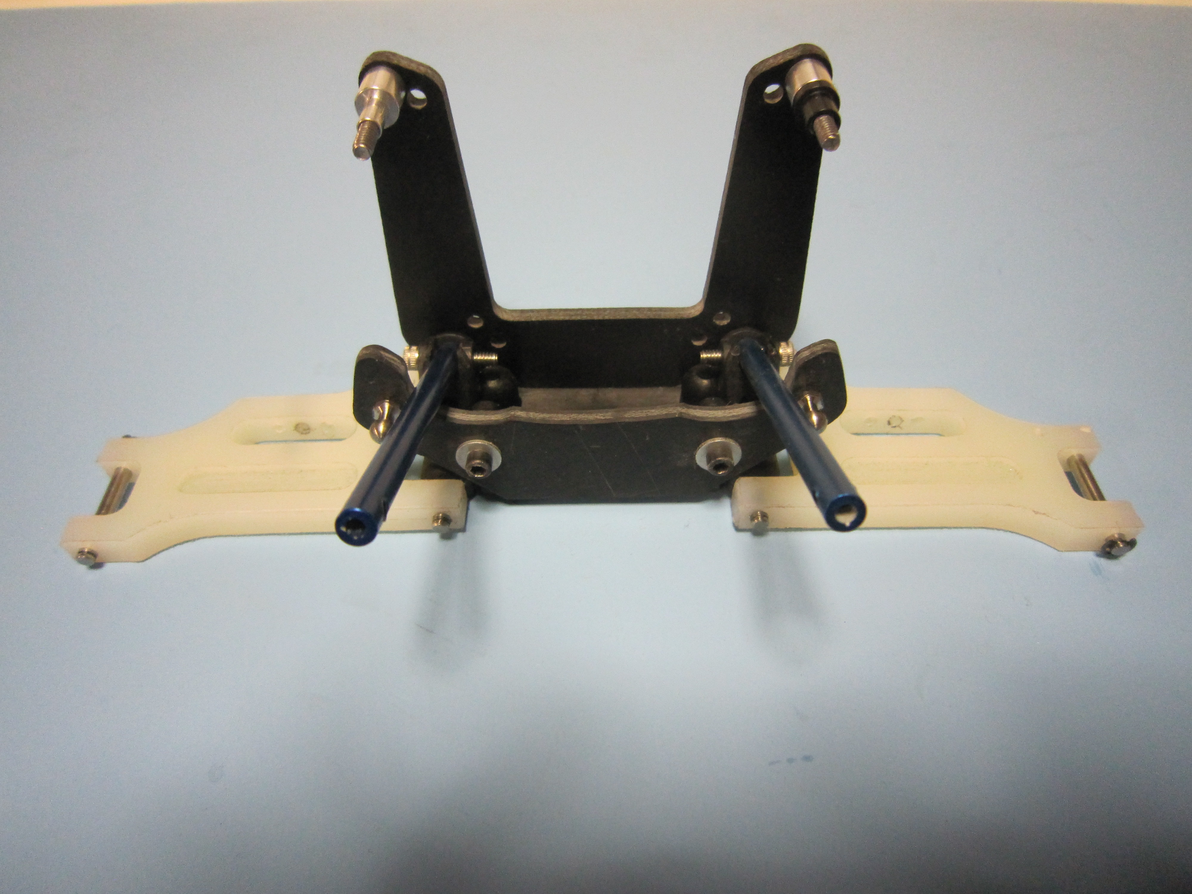

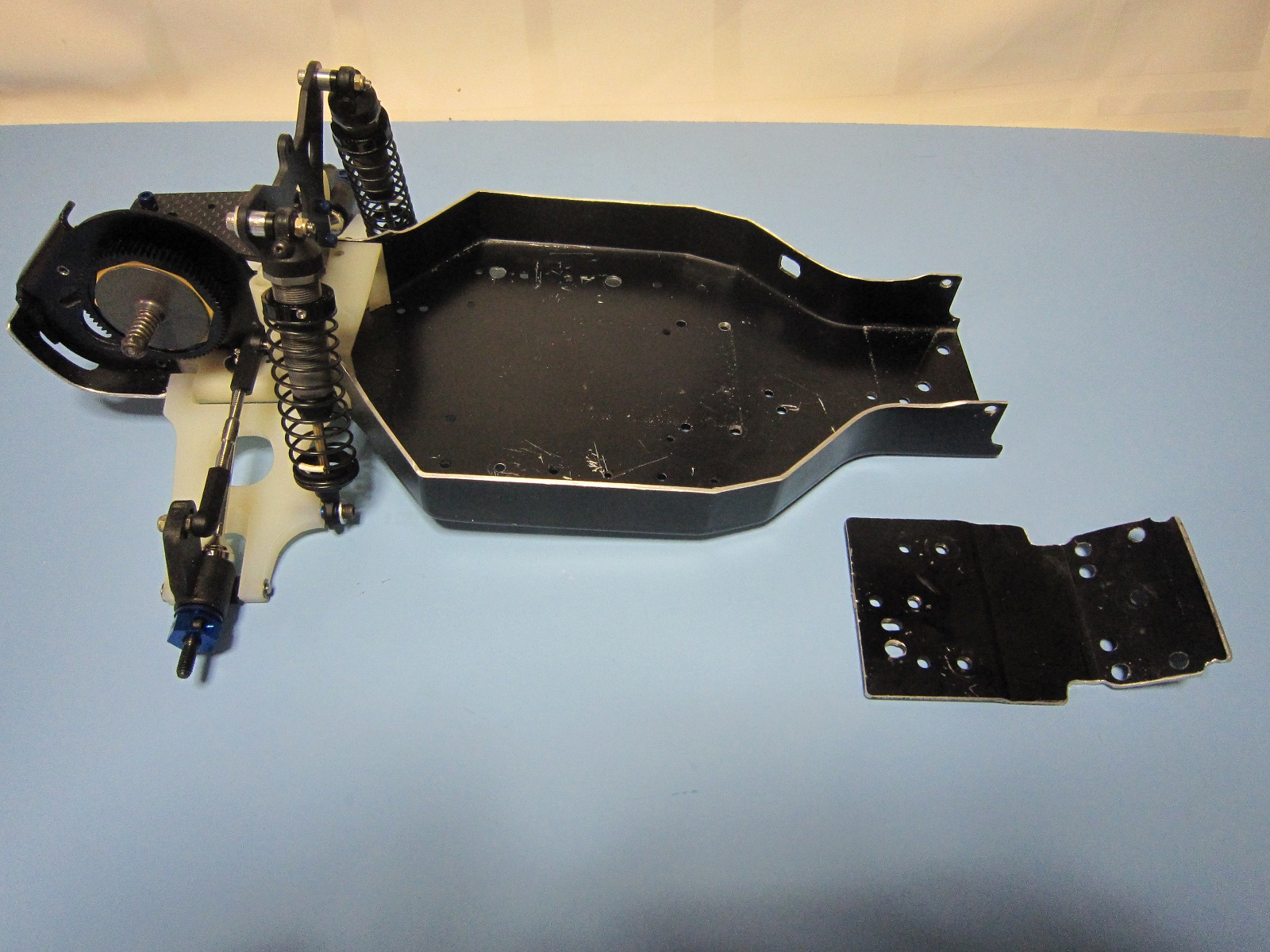

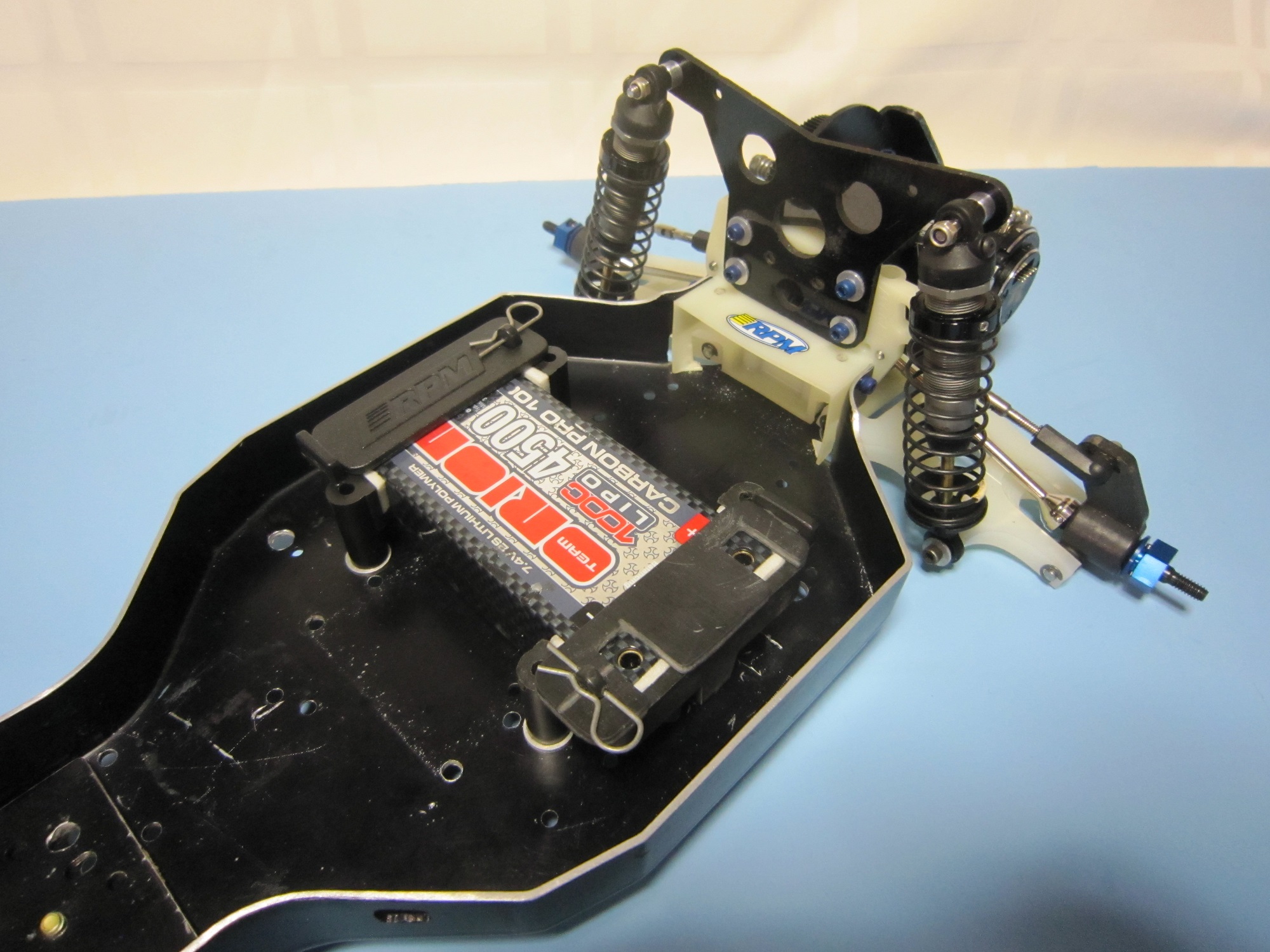

Been wanting to build one of these for a while now. Meeting with Jason & Joe at our local track a few weeks back and seeing their nice builds running , it inspired me to finally get going on this. I'm trying to keep costs down so will be lot's of used bits and pieces. Chassis is a one that has plenty of extra holes and scratches but straight. I took about 3/16 off the sides. I didn't have a used 10T nose plate so I cut one from a buggy plate. Out back I'm using Jakes arms with RPM worlds mounts, RPM rear bulkhead, RPM copy rear tower(may change this out), V2 shocks with Avid 12mm spring adapters( Might be changing these to big bores), B4 hubs and B4 cvds. So far so good with it all working together.
Out front I'm going with a B2 shock tower, homegrown cross brace as well as a camber link mount I cut from a old graphite chassis. Using .89 shocks with the avid 12mm spring adapters but like the rears, I may go to big bores that I'll rob from a B4.2 scrapper I have. Other parts are B4.2 blocks/axles with jconcepts hexes. This is where I'm at so far.

Looks great Ed! Loving the flipped front end. Nice combo on the rear.

Interesting idea for the camber mount, simple but effective

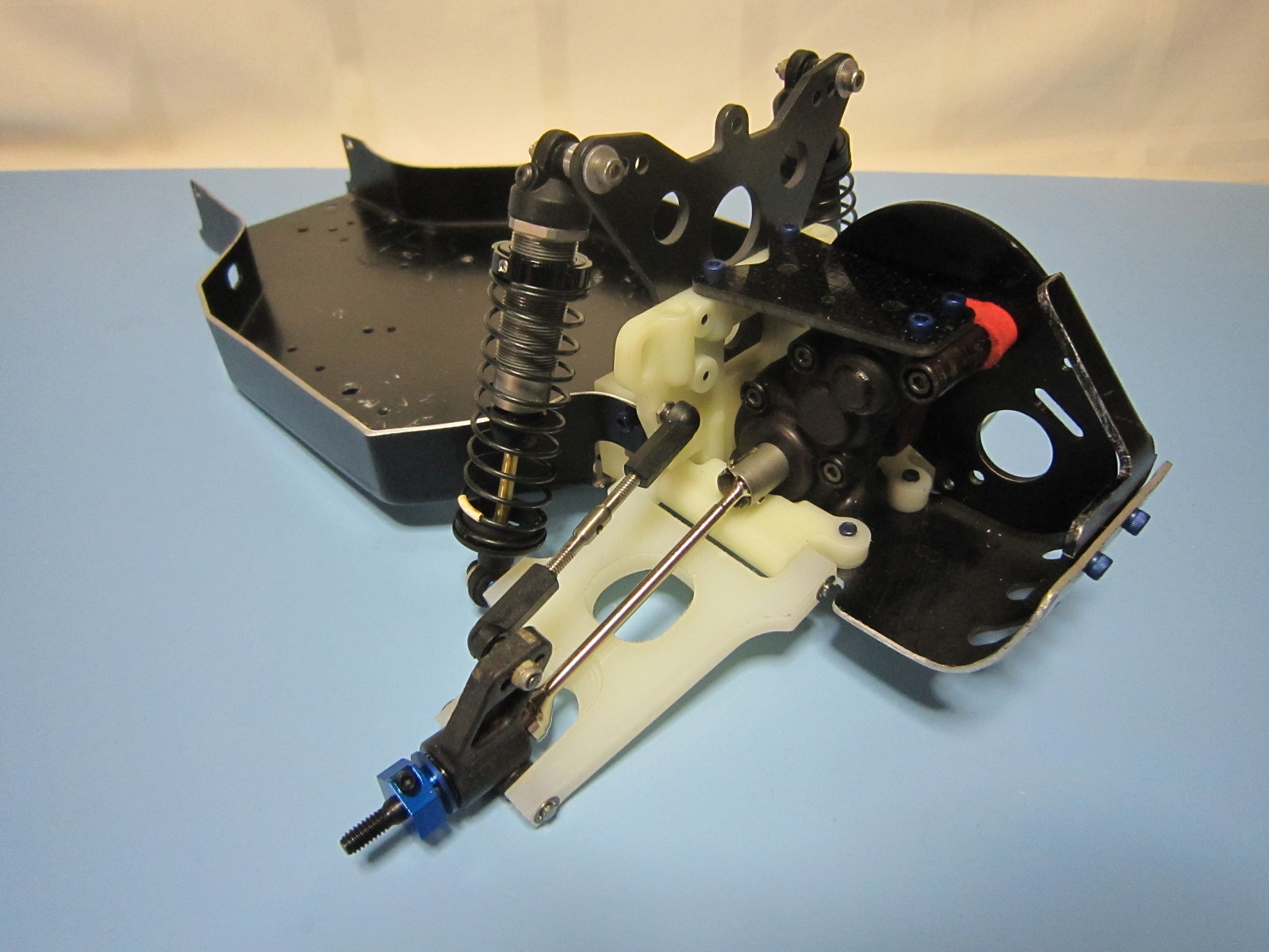

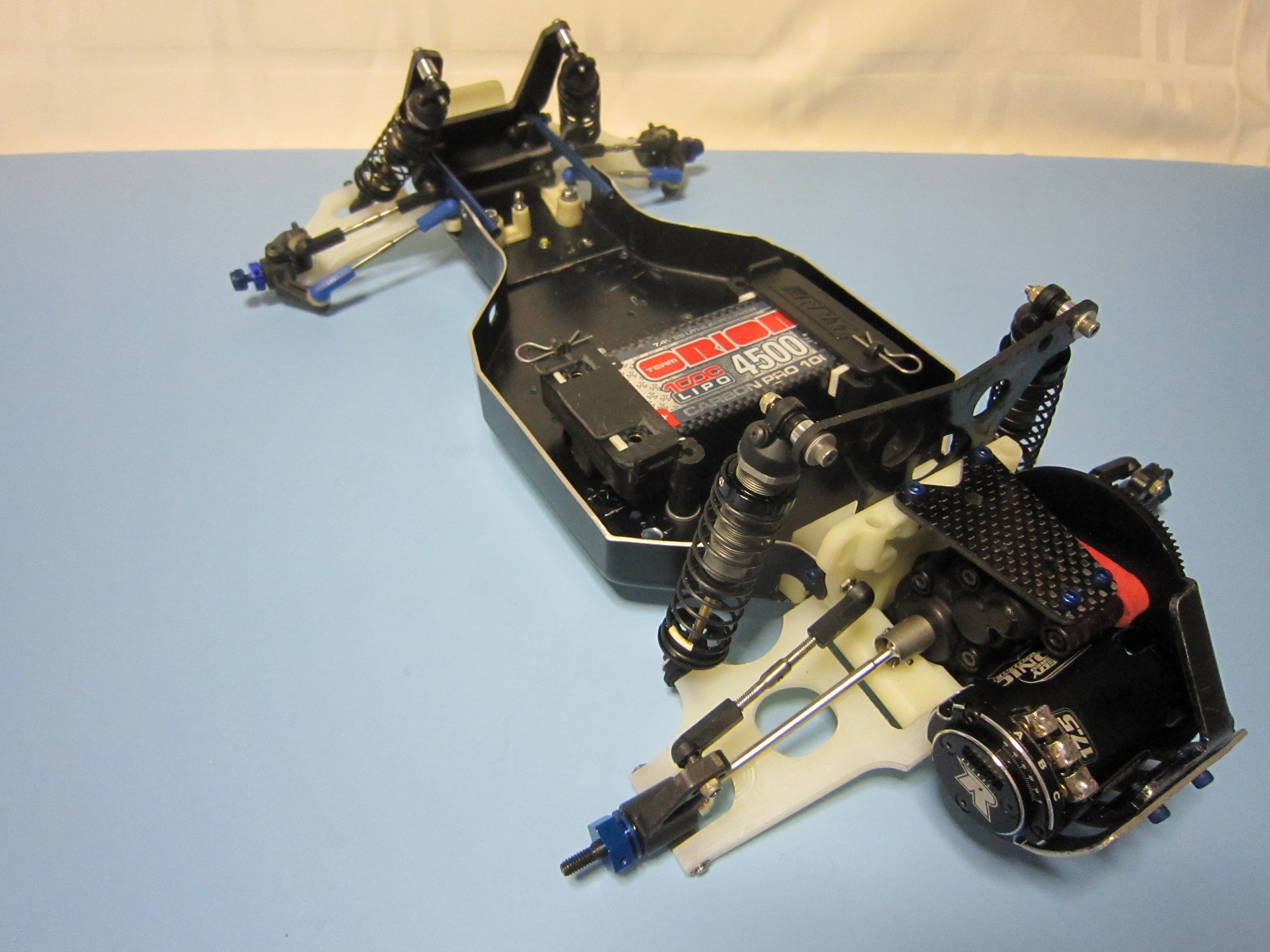

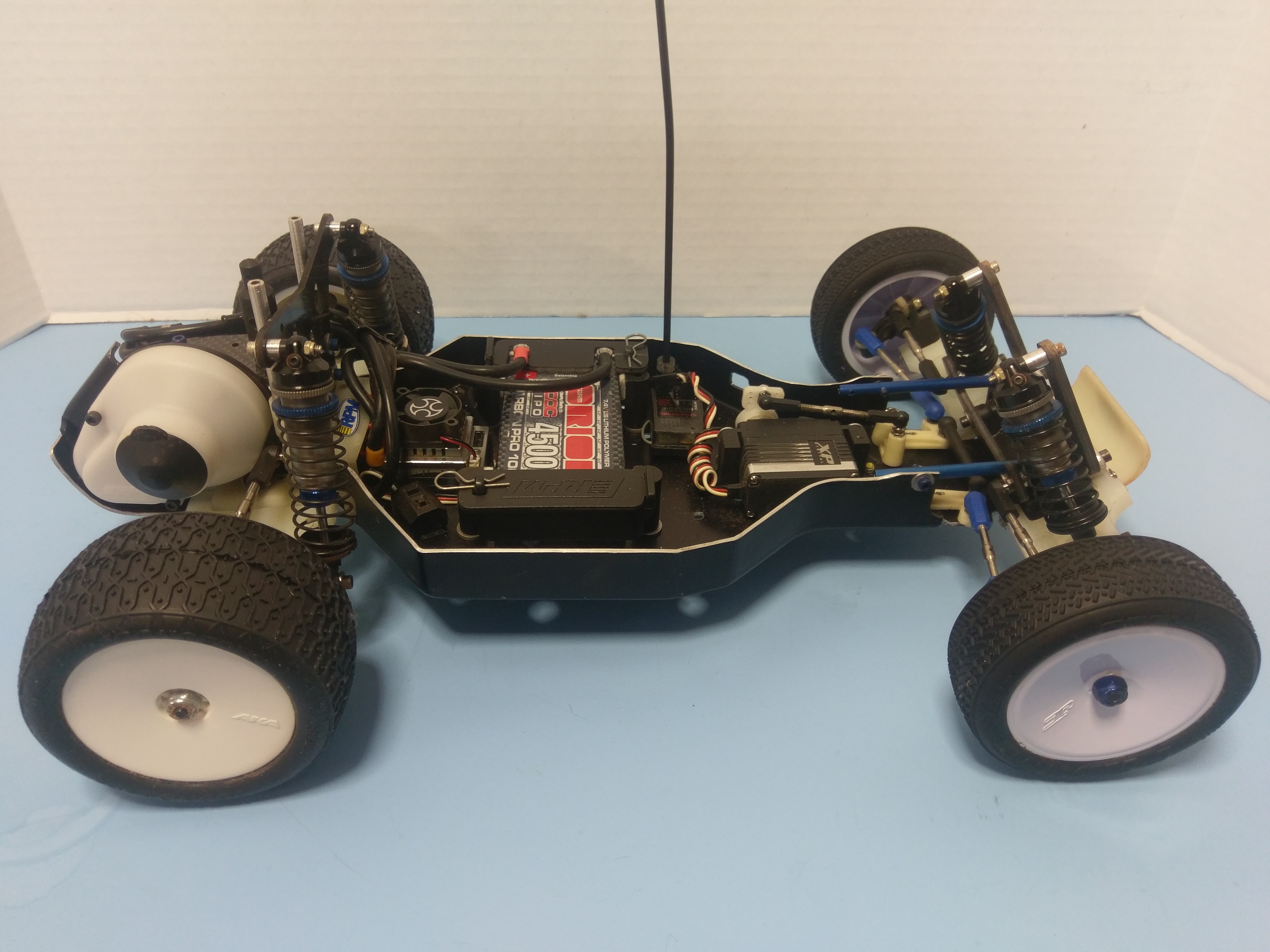

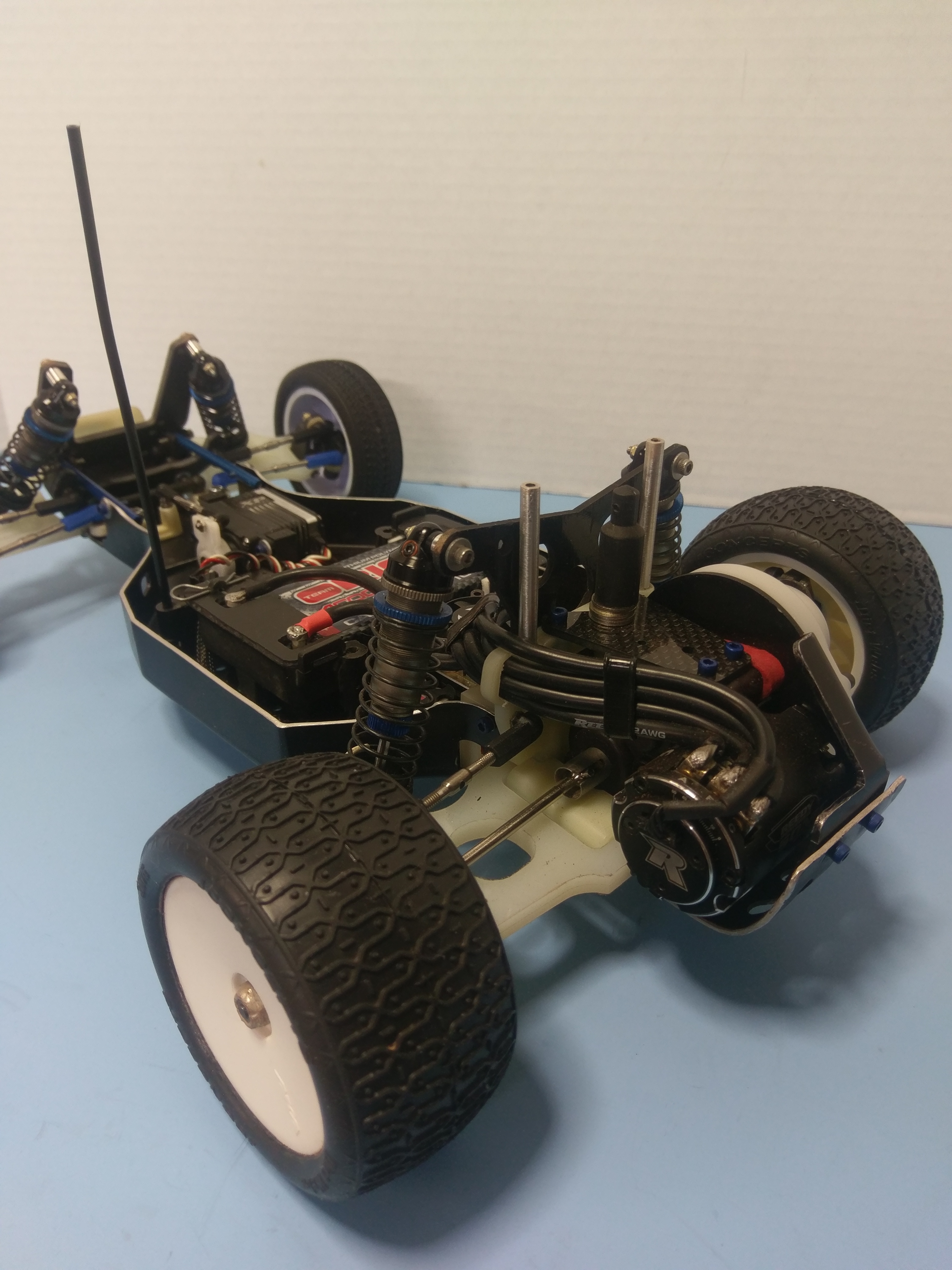

Getting some more done on this. Added a mip bellcrank. Need to drill new holes for the nose tubes. Changed the rear tower back to a standard tower for now and will see how it handles with that. Will probably add a inner hole on the tower and move to there as the shock angle seems a bit off. I Used two rpm battery boxes for the shorty pack and cut a new brace for the one to accept the wires. Currently wiring up the esc and will be shopping for a steering servo unless I go analog as that's all I have at the moment. Getting there. :)
mikea96
Posts: 3599
Location: Puyallup, WA
Has thanked: 659 times
Been thanked: 878 times
Re: Old Is New Now Old Runner Project
Post by mikea96 »
Looking good Eddie! I need some of those RPM worlds rear mounts.
transamman908
Posts: 770
Location: East Coast
Been thanked: 5 times
Post by transamman908 »

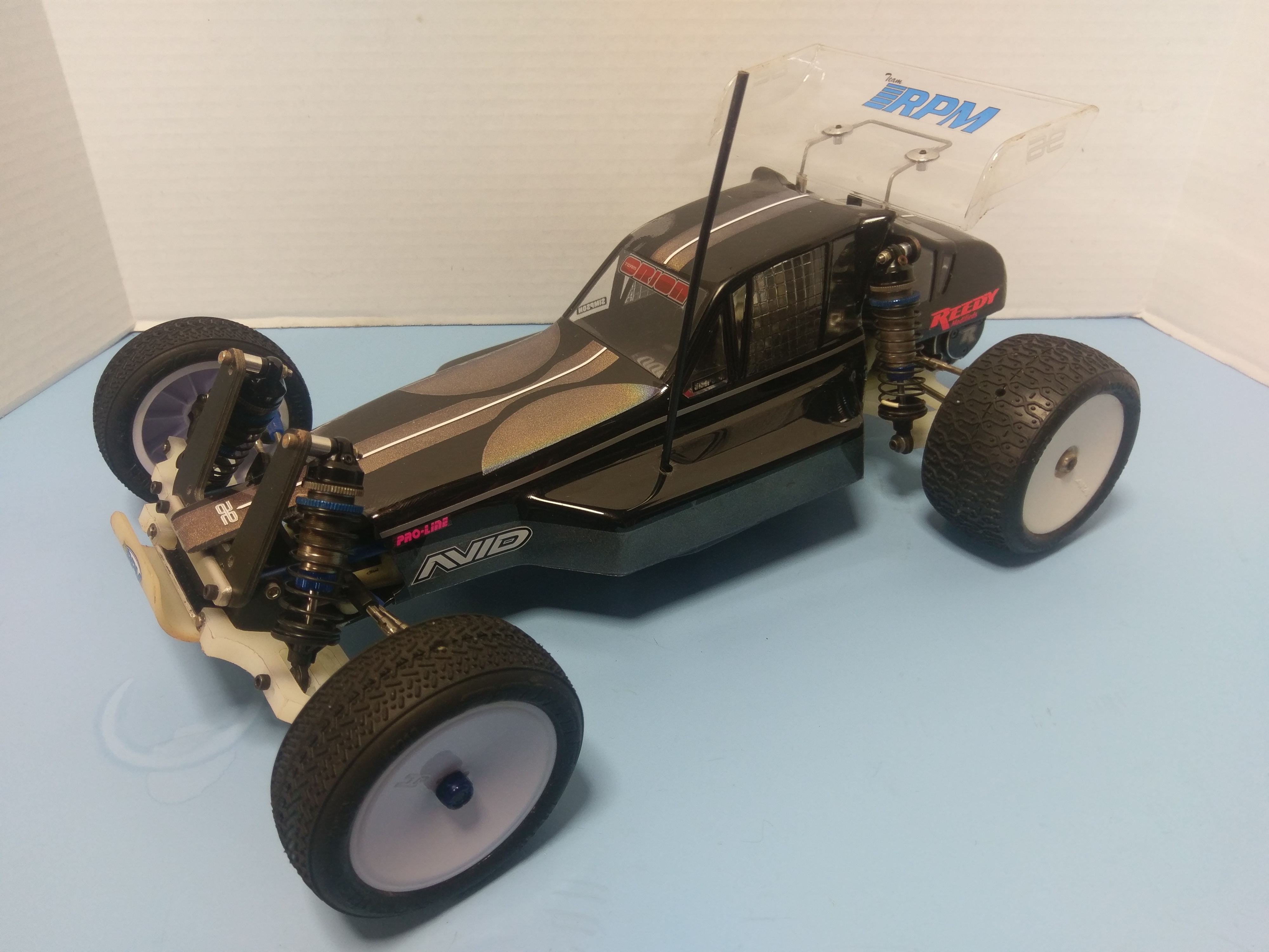

Finished this up. Took it out last Sunday to test it out and it ran well for first time out with it. Got attacked by the rental short course trucks but was fun. Will need to adjust the gearing and get different tires but other than that I'm happy with the outcome.
