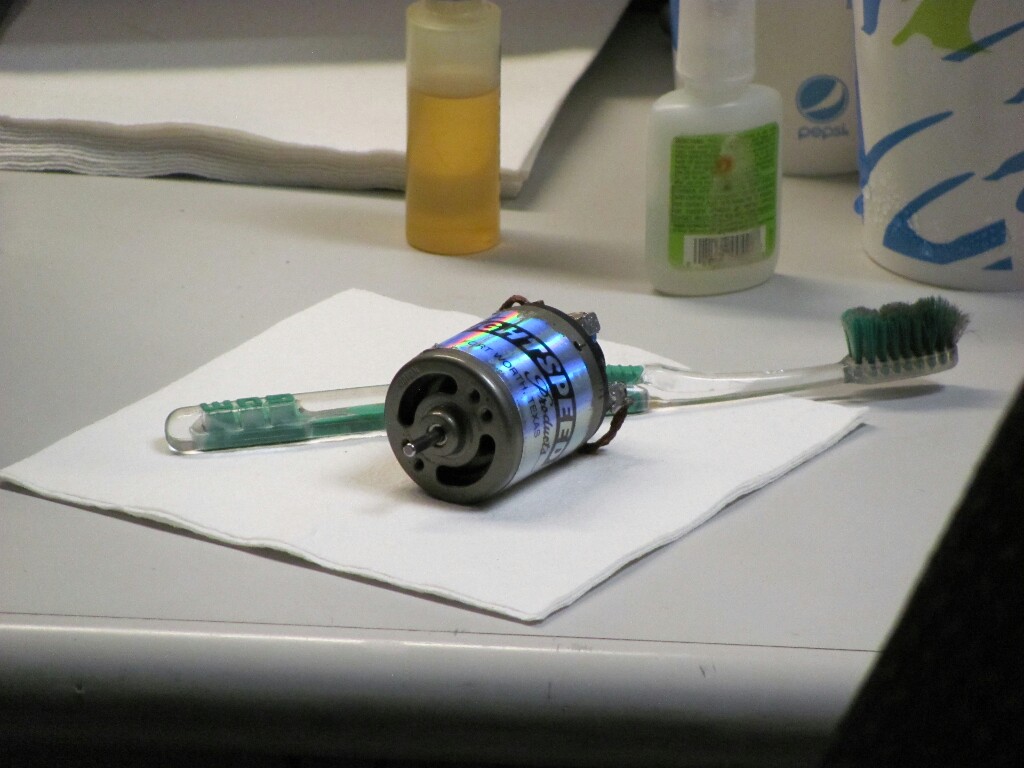

Phin, you are correct. After looking closely at The manual for the LSO, I think that is what I have. Even the shock has the correct black cap. You may be correct on the axle being titanium. I compared it to my bolink steel axle and it feels not as heavy. I will check with a magnet to verify. It also took the hammering quite well and hardly marred the end of the shaft. Took some sandpaper on the end with the shaft in drill and it cleaned up nicely. Ordered up some rear pod parts so while waiting for those to arrive, I took apart the motor for cleaning and inspection. I really dig the old brushed LightSpeed motors. The windings are so neat and motor is very well balanced. Its a screamer when I hooked it up to my power supply.
