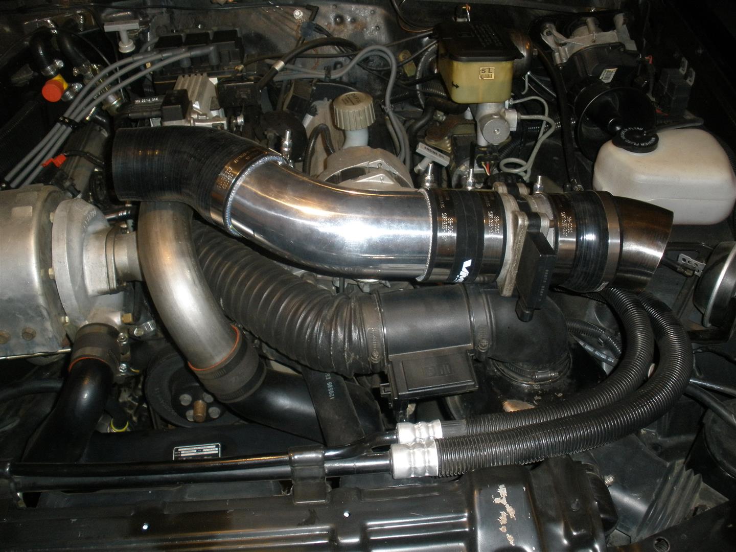

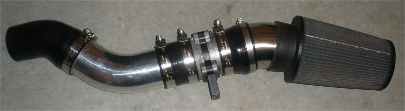

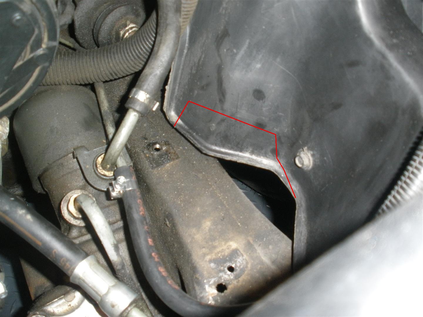

Installing custom air intake
This summer, I wanted to complete my project of building and installing my own custom air intake. There were 3 reasons for building my own, certainly there are already retail kits available...I'm upgrading the stock 3" MAF sensor with a 3.5" LS1 MAF sensor, and I'll be replacing the stock air-box with cylinder filter with a long 4" K & N cone filter. The aftermarket intake kits I've seen are almost all either 3" (which requires a half-inch reducer right after the bigger LS1 MAF sensor) or 4" (requires removal of MAF sensor entirely). I wanted to keep the pipe 3.5" from the LS1 MAF all the way up to the turbo inlet, which seems less restrictive to me. That was the first reason for fabricating my own. The second reason was cost; after all was said & done & bought, my intake probably cost about half of what a retail kit costs. Lastly, there's something to be said about doing it all yourself. It was a lot of work, test-fitting, measuring, cutting & filing, etc. but well worth it.
Anyway, last fall I'd pretty much finished assembling the intake, but couldn't install it because you need a new MAF translator and computer chip to let the ECM work with the increased airflow from the larger MAF sensor...with the USD-to-CAD exchange rate not too favorable for Canadians these days, those parts ended up costing just shy of $400 CAD. I picked up some valve-cover breathers and an EGR block-off plate, might as well do some engine bay cleanup & dress-up while I'm at it.

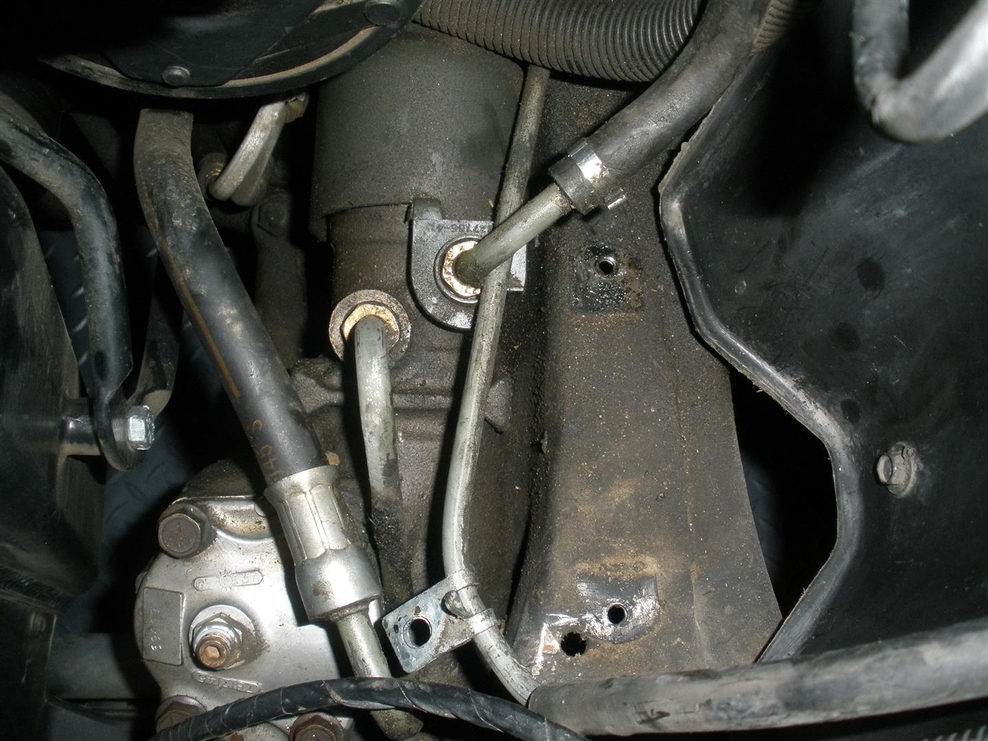

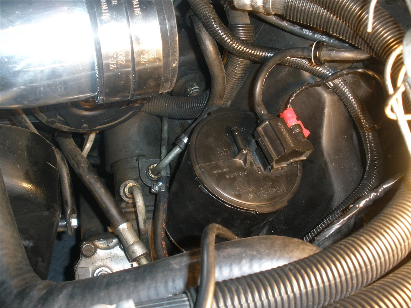

Here's the assembled intake: Compared to the stock intake: This mod usually requires relocating a charcoal canister, it's located right about where the cone filter would go. I decided to relocate mine beneath where the new intake tube will go. There's a V-bracket down there where the stock air-box bolts down onto; once removed, I figured I could stick the charcoal canister in that location. It took a bit of work to make it sit flush down there because the steel line/rubber hose going to the canister, and the plastic fender shield on the driver's side both obstruct it. I got out the tubing cutter and removed a section of the steel line and reattached the hose with a clamp. I then cut out a notch in the plastic shield with a Dremel and some filing. After that, the charcoal canister sat down real nice and polite-like, using one of the existing V-bracket mounting bolts to hold it down.
Area where the V-bracket bolted down: After cutting the steel line, and showing approximately where I notched the fender shield: Charcoal canister relocated, nice and snug:

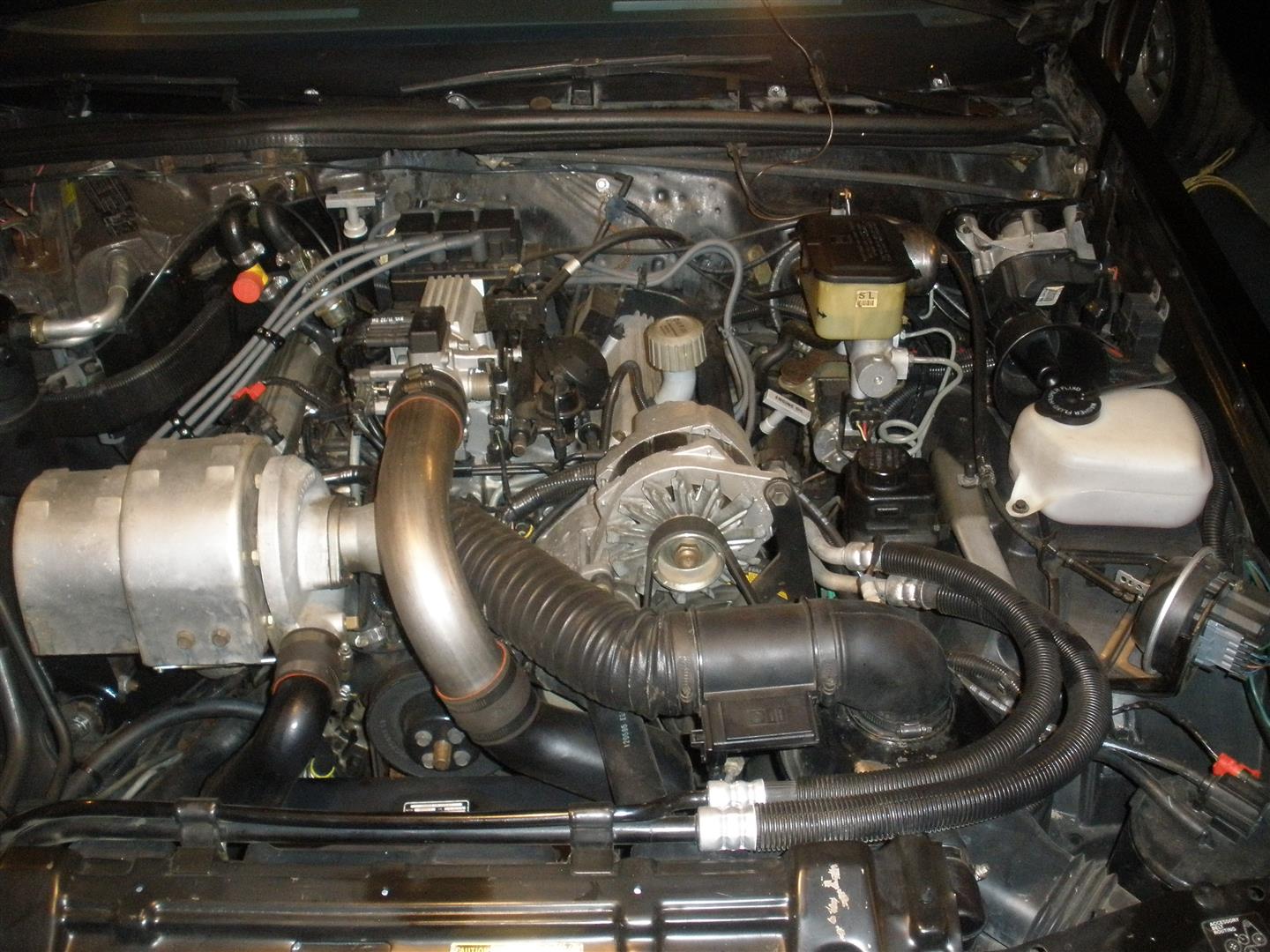

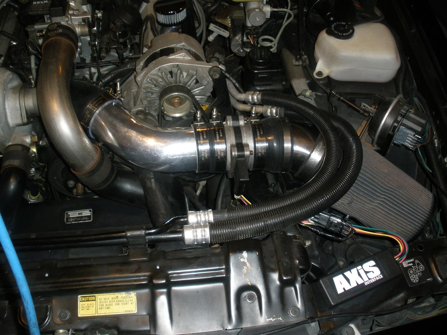

Custom air intake installed
Before picture of the engine bay. Note the charcoal canister at the bottom right, with the red connector plug and 2 hoses running to it, and the stock intake/air-box assembly, a rather restrictive design with all the pipe bends and accordion-like intake tube up to the turbo.
Picture after installing the custom intake and AXiS Interface (new MAF translator). The new translator and computer chip (ECM is located beneath the passenger side kick-panel) are calibrated for the stock injectors (for now) and allow the car to run properly on modern unleaded gas. Back in the 80's, gas had lead in it; modern gas doesn't work so well with old, early OBD computer-controlled cars. The new chip also removes the 124 km/h engine limiter. The AXiS interface allows spark advance and fuel adjustments at low & high load.

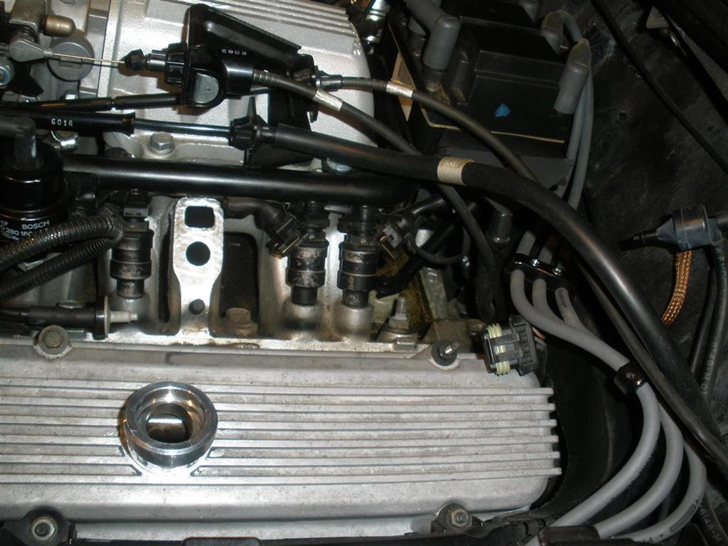

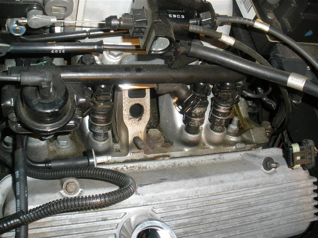

Got rid of the EGR today. Since the new chip isn't programmed for EGR, it just clutters up the engine bay.
Removing the EGR block: 2 nuts
1 connector and disconnect hose from T fitting on firewall:
EGR solenoid & block removed:
EGR surface on manifold all cleaned up:

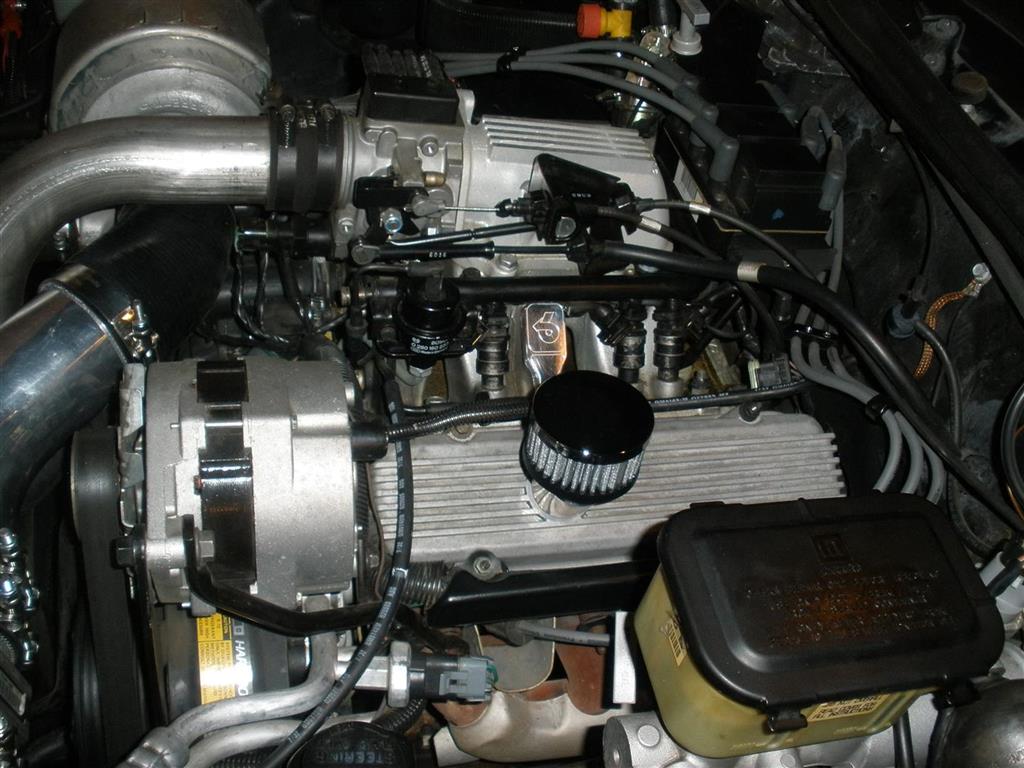

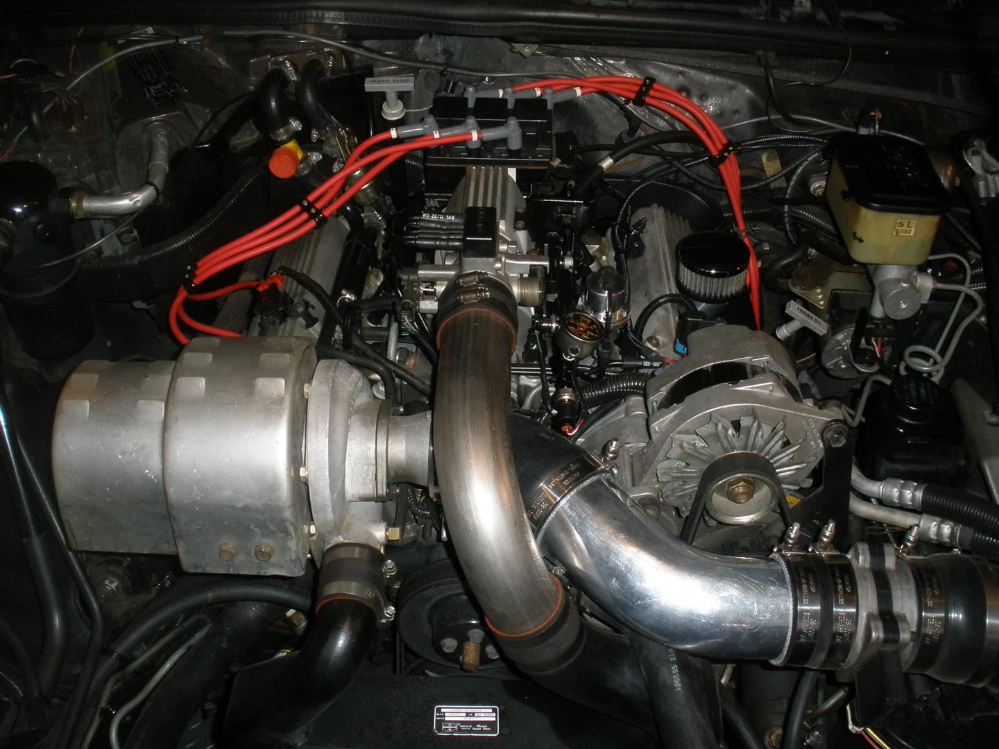

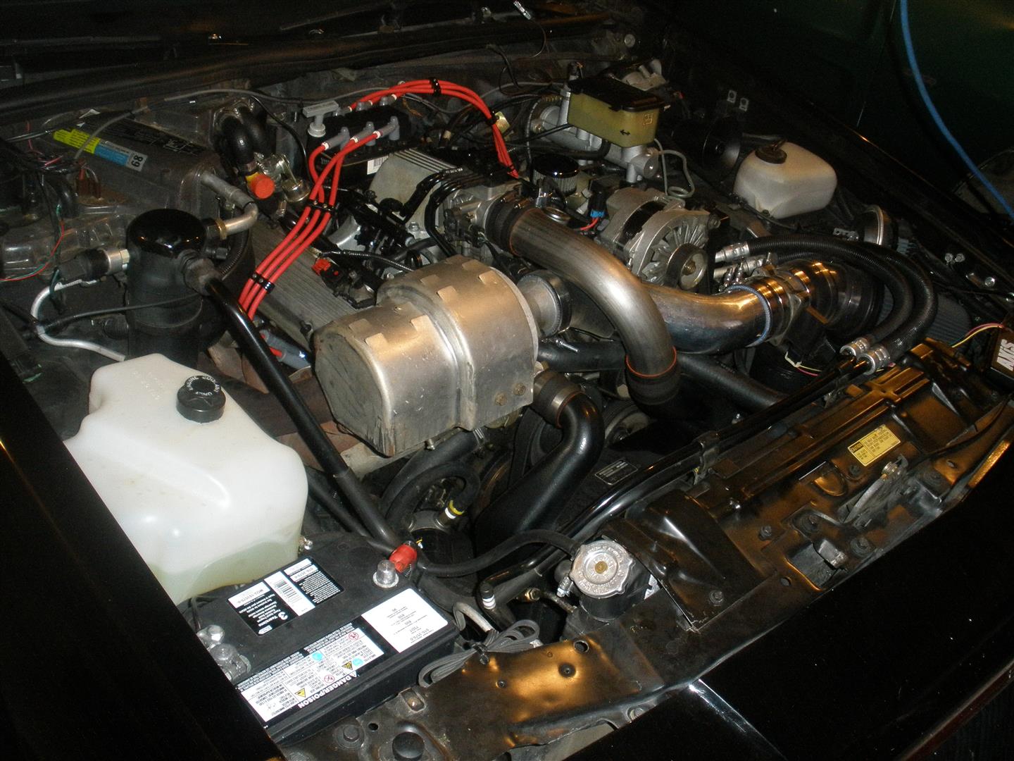

Re: Waking up a Grand National
Some pics of the EGR block-off plate installed (a dab of black RTV compound will do ya) and the dress-up breather; simply ran a hose from the check valve on the left of where the solenoid was, to the T fitting on the firewall:

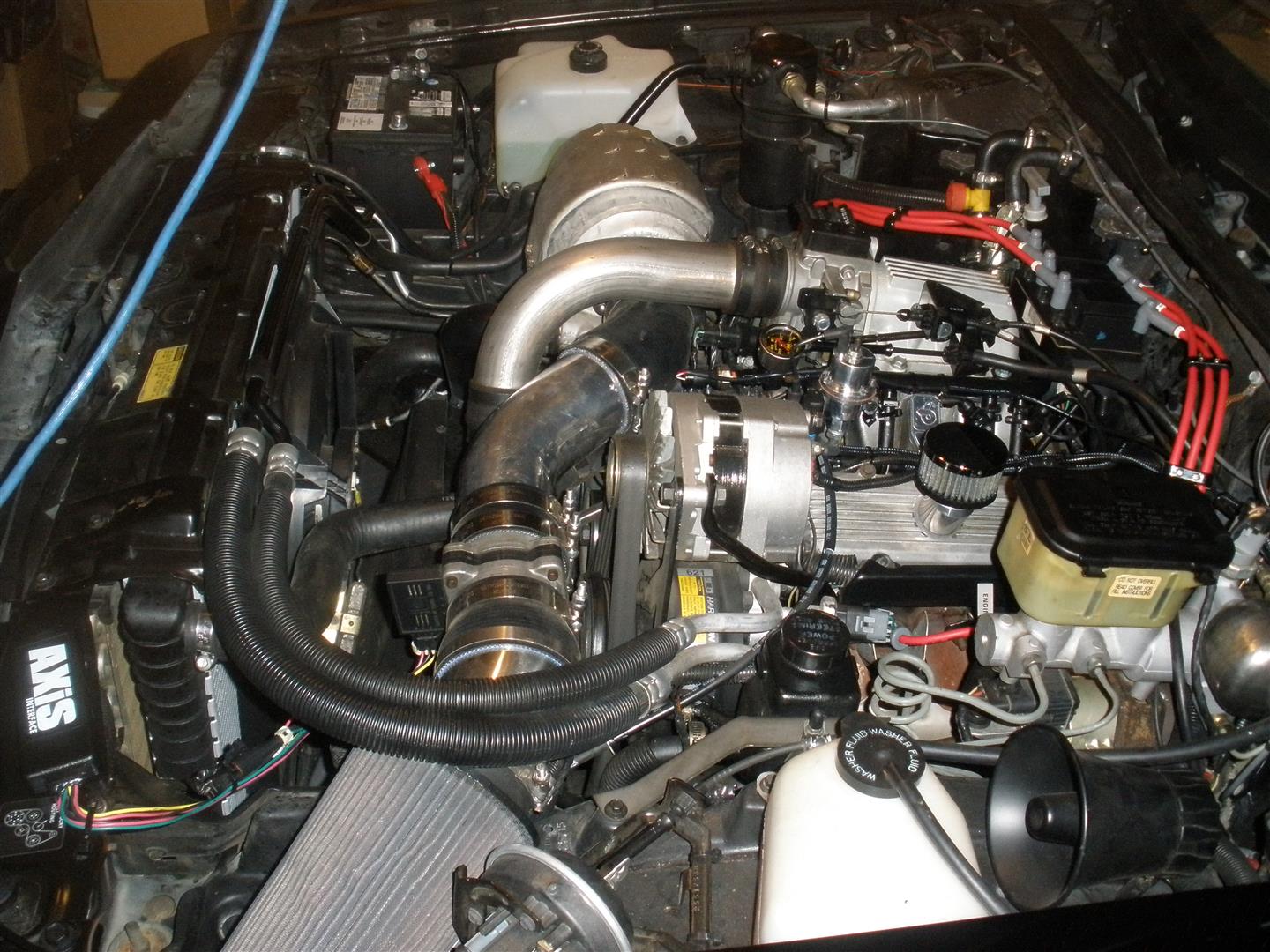

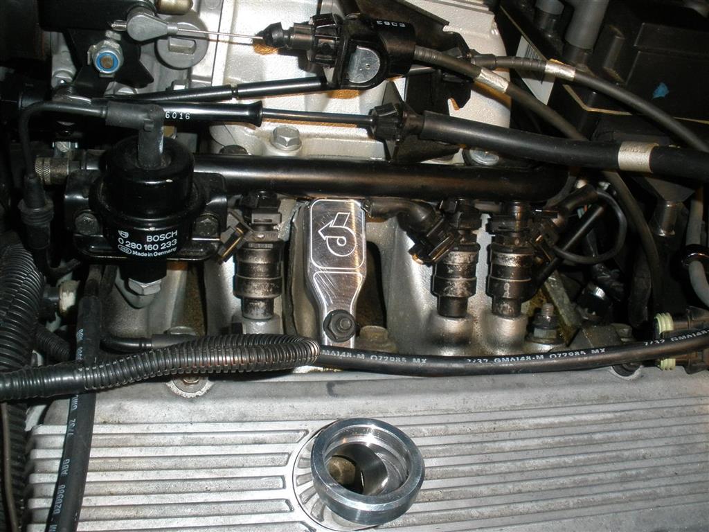

Here's an update on my work on the GN this season...I haven't even driven it yet!
I got a pretty nice tax refund this year so I'm putting about a grand into the engine and several frame braces and body bushings to stiffen the ride.
I just got finished a pretty big upgrade, replacing the stock 28# injectors with 60# injectors and a matching TurboTweak chip. Had to flip a DIP switch in the AXiS interface to recognize the new chip. While I was at it, I put in new spark plugs and an MSD 8.5mm wire set.
I'm waiting for my big parts order to arrive, which will include a bigger and much less-restrictive one-piece 3" downpipe, 3 sets of frame braces and a body bushing set, a plenum power plate which is supposed to even the airflow into the intake--it's not to increase power, per se, but with the more even airflow distribution to all the cylinders, it reduces or eliminates detonation and lets you run higher boost. I also have a manual boost controller to install, so I can get the stock turbo to run 19 or 20 pounds of boost (stock is about 14-ish). That should make things a tad more interesting.
