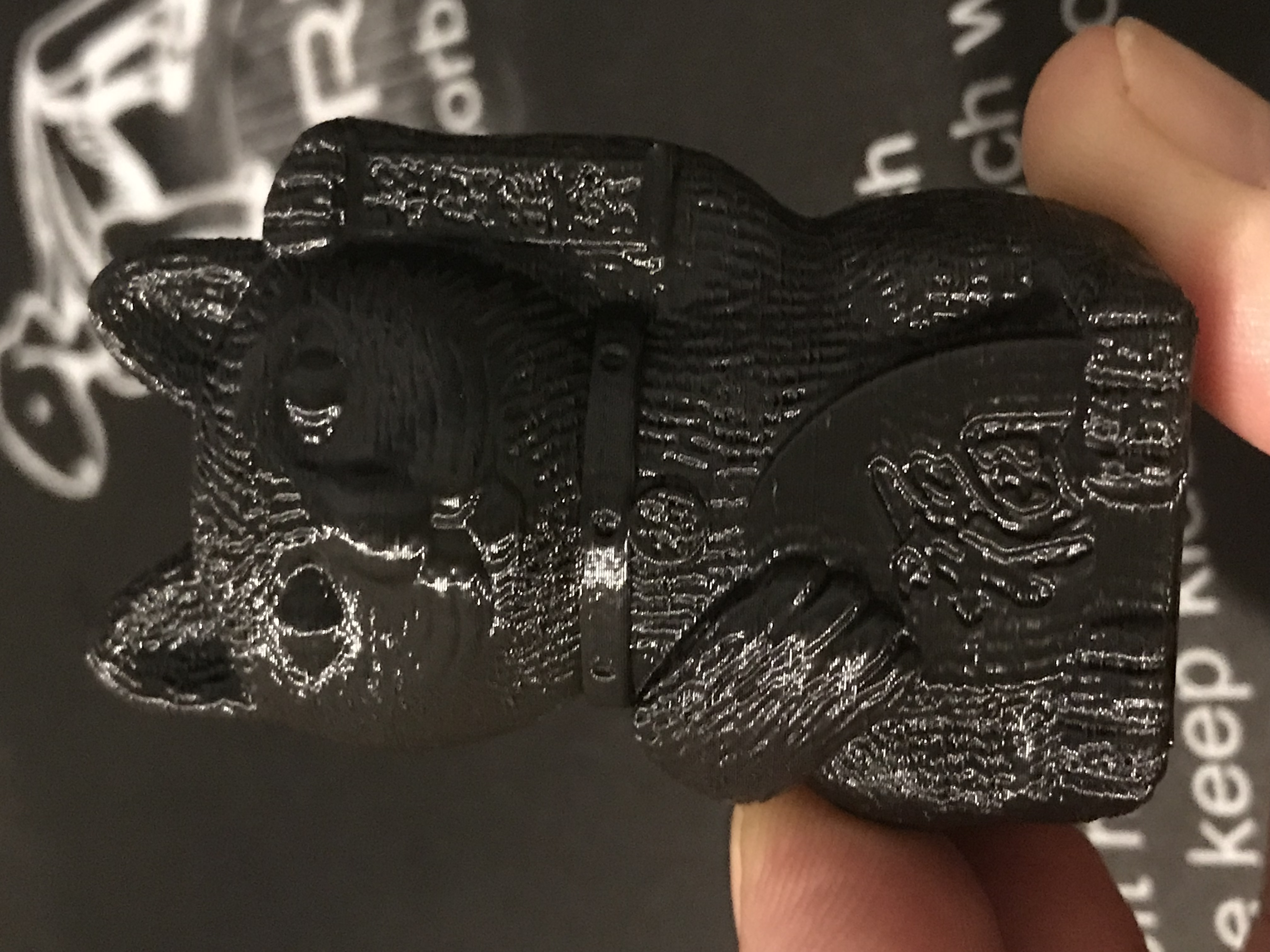

I finally had some time to spend on my Creality machine. I was taking it slow and trying to make sure it was perfect- and I’ve been fighting it every step. My prints would end up starting at 0,0 even though I was telling it to start at 150,150 in cura (come to find out I had to uncheck a box to make it work correctly). The when it did print in the right spot, it would not get the first layer down. I tried adjusting the bed up and down, nothing worked. The material was coming out round but very thin- like it had a nozzle that was smaller than it should be. About 1/4 of the original filament diameter. I checked and rechecked my settings (even though they were from the official cura database) and even tried some google supplied settings. Nothing worked. Finally I grabbed the original Sd card that came with the machine and decided I would try the cat. Without tweaking anything besides the bed temp (they had it down at 40*?!) it printed beautifully.
Now I’m at a crossroads. Figure out cura, and deal with their constant updates and changes. Learn something new- I have already downloaded and played with Ideamaker which seems cool. Or, and I’m leaning towards this one, paying for Simplify3D and being done with it. I’ve watched plenty of videos and read plenty of reviews, it seems like for the money the worst it prints is still as good or better than the best of the others. Decisions decisions.
Here’s what it was doing with a simple box shape
Printing underway with the supplied cat file
The finished cat. The detail is great. Very pleased.
Here is the cat alongside my test cat from my monoproce mini
