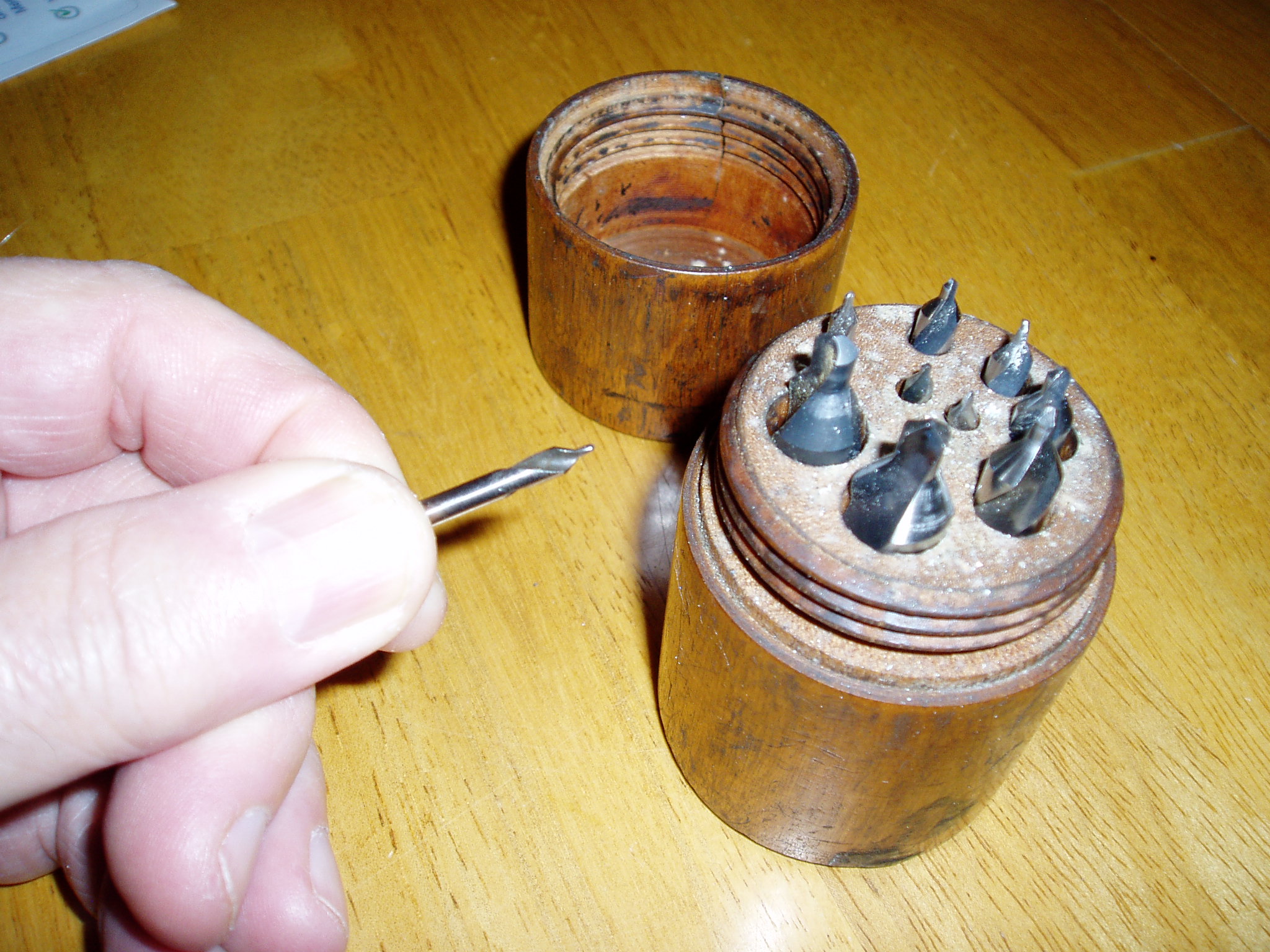

I don't know what these are called but this is what my Dad had in his shop.
He was an amazing guy; without any formal machinist training, he could make anything on a lathe and a bridgeport.

Those are center drills, and you appear to be holding a #1. They are generally used when making a 60 degree pilot in the end of stock so it can be supported in a tail stick with a center.

jwscab wrote: Tue Nov 20, 2018 10:25 pm Those are center drills, and you appear to be holding a #1. They are generally used when making a 60 degree pilot in the end of stock so it can be supported in a tail stick with a center.
Yes, center drills and a nice vintage looking set. They'd look good in any tool chest. :mrgreen:
Sometimes you have to use the tools you have to do a job, like using a center drill to do a chamfered hole. Is it the right tool? no. But it'll get the job done.

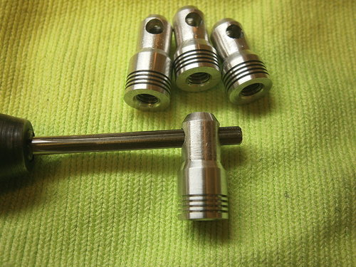

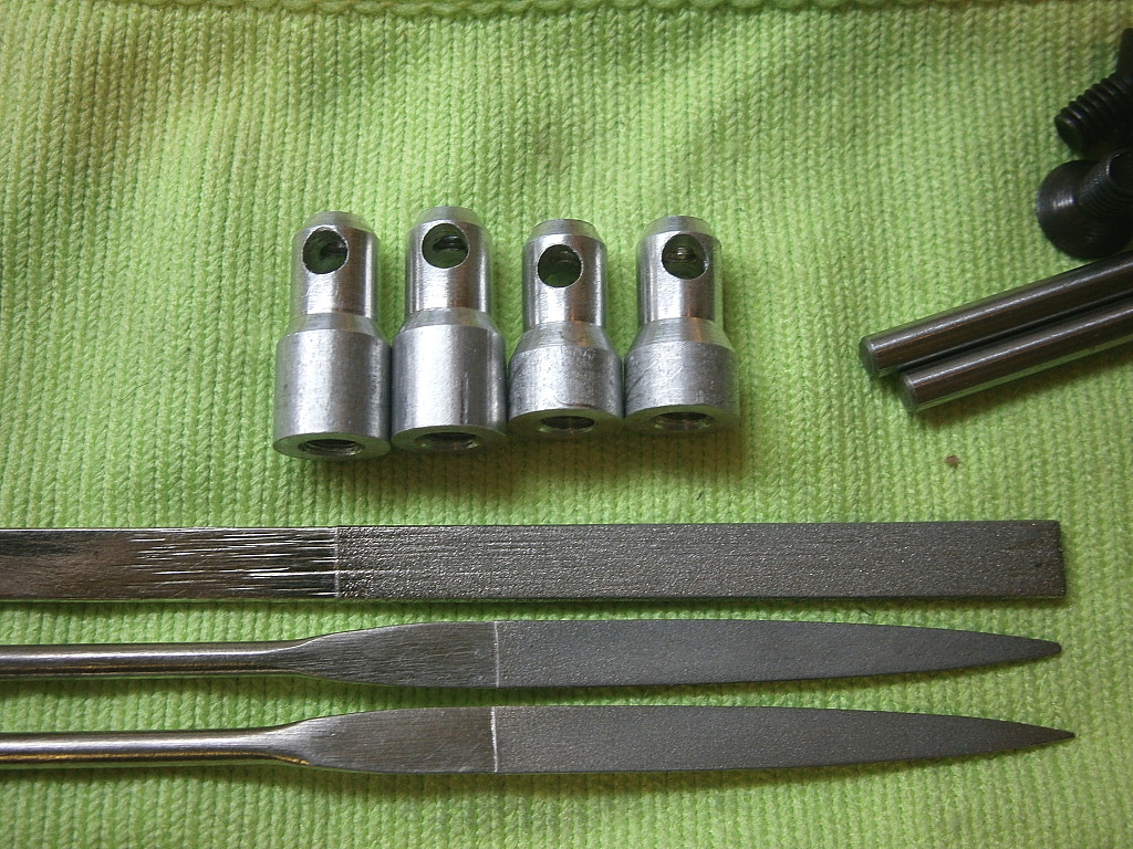

Small update for today, working on the trailing arm pivot post...
The first thing I do is remove any flashing from the posts. This is so they fit in my ER16, 1/4" lathe collet nice and true. I use diamond coated files to get the job done.
Now, I head to the machine shop for some "groovy action". First, I turn the post to make it true. This is done with light cuts, 0.001-0.002" at a time. Next the grooves. I come in 0.050" from the end and cut four grooves, 0.030" spacing, 0.060" deep. They look pretty good to me. Finally, I use a 1/8" hand chucking reamer to remove any internal burs in the hole. I'll continue working on the posts till they are all nice and shinny, well, not a true shine, a sort of fine brushed finish is what I'm after.

Where did you get the cool nose tubes?
NomadRacer
Posts: 1467
Has thanked: 81 times
Been thanked: 79 times
Re: Factory Works 180* Steering Bellcrank Build
Post by NomadRacer »
orangemazda wrote: Wed Nov 21, 2018 12:05 pm Where did you get the cool nose tubes?
I made them myself.
