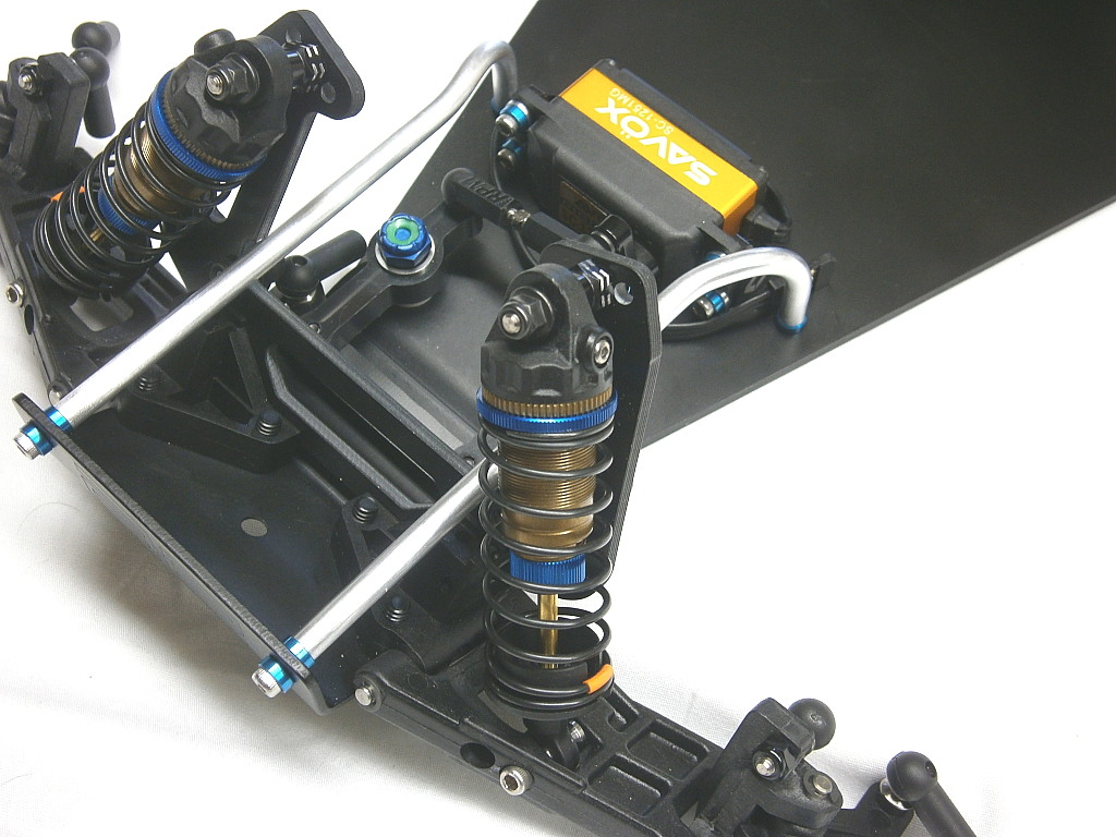

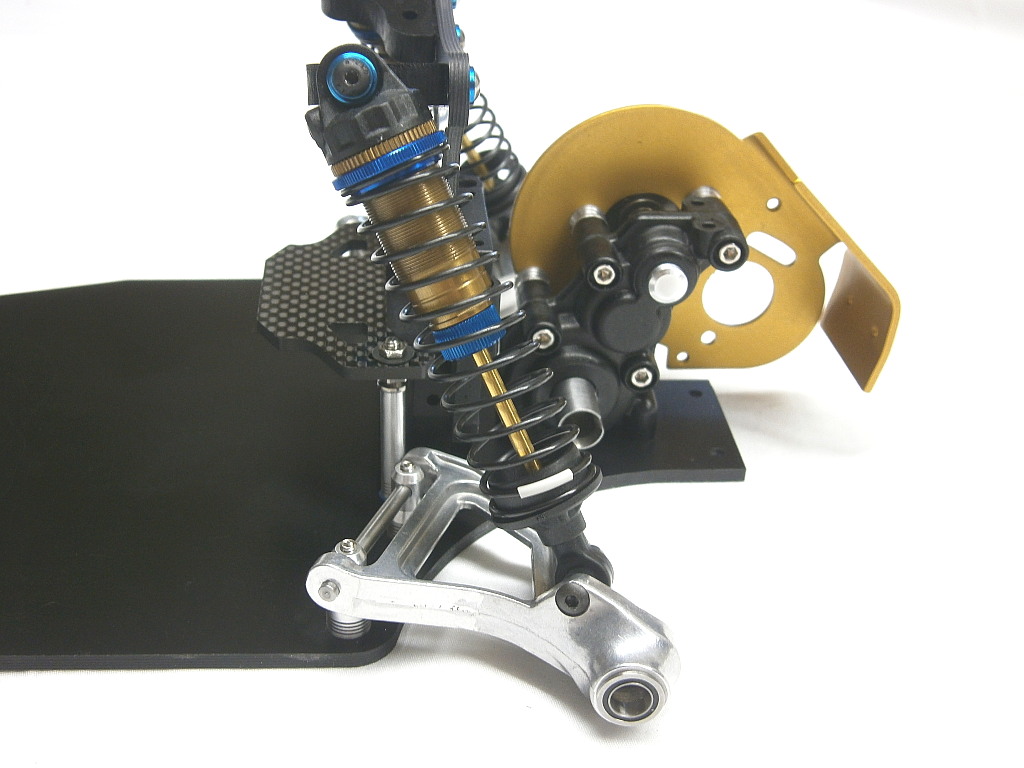

Over the holiday, I got a lot accomplished...

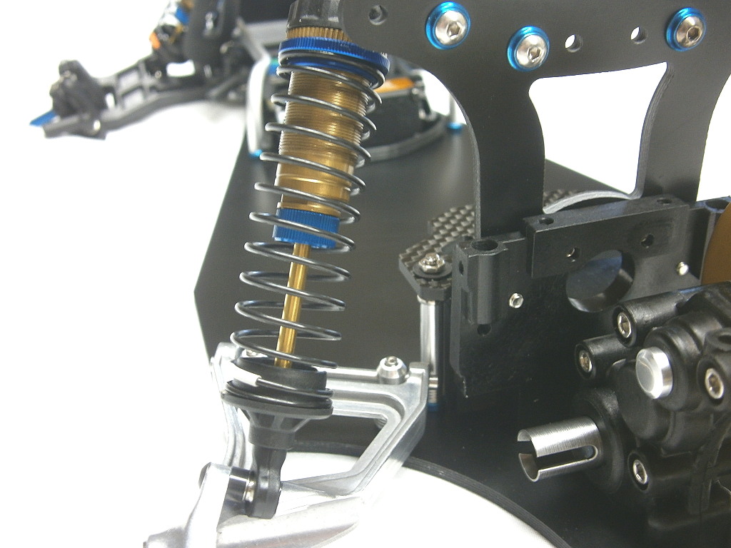

Freshly built Stealth transmission with AVID metal/ceramic bearings, AVID diff balls and sanded diff rings make it slick as snot. FOX Kashima coat B6 shock bodies that I got off of eBay for a great price, along with all the internal shock parts. They are built with the X-Ring seals. The grooves in the trailing arm posts really set it off!
I haven't decided whether to use 1/4" axles with dog bones or 1/4" CVA's. the CVA part number seems to be no good anymore or maybe I'm missing something. :?

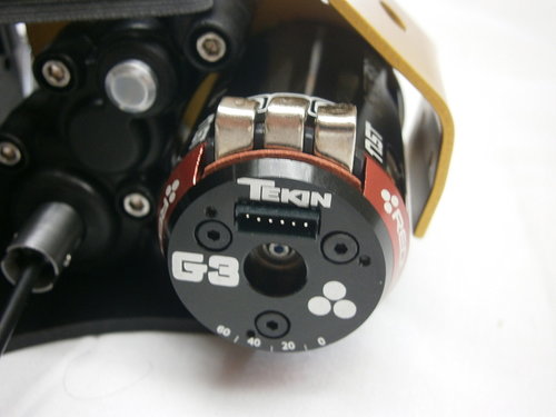

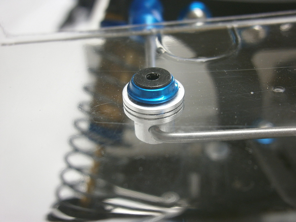

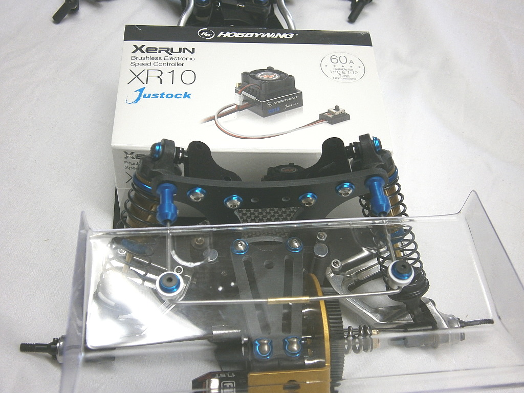

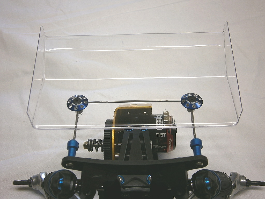

I picked up this Tekin 17.5 at a good deal from another forum. It's new in box (I cut the seal) so no worries there. I also got an ESC in yesterdays mail. Working on the wing mounts while waiting on some wing buttons to arrive via USPS. I used my last bit of 3/8" aluminum round bar to make the wing mounts. They are not exactly right, need to get some more alum. and do them over. :?

The grooving is kind of wonky, the cutter was dull. :( Now, I'm low on cutting fluid and metal! Time to re-stock on essentials. I have a cup full of things that are "out of spec" :wink:

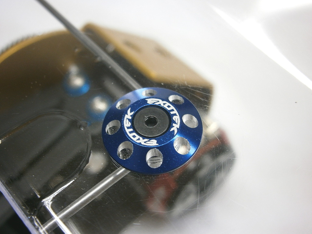

Make my day USPS! :D
Wing Buttons arrived a day early from NY... EXOTEK 168BLU. I"m digging them :mrgreen:

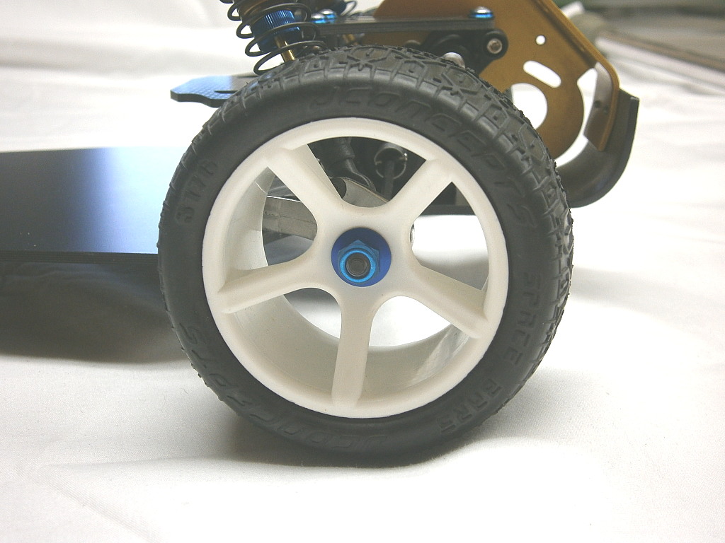

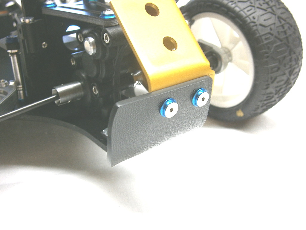

I decided not to track down an aluminum motor guard/rear bumper and use the Factory Works kit supplied Kydex. I cut it off with a dremel and re-shaped it with a heat gun and a wood block. if you get the temp and pressure right, you'll get an imprint of the holes in the motor plate in the Kydex... easy drilling that way for the 4-40 screws. :mrgreen:
I got some JC Racing RC10 Vintage wheels for the build from the UK. I went with white as I might die them light blue. JC Concepts Space Bar tires for now, may change later to something more aggressive.

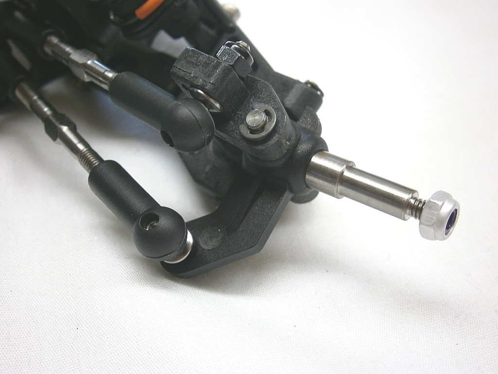

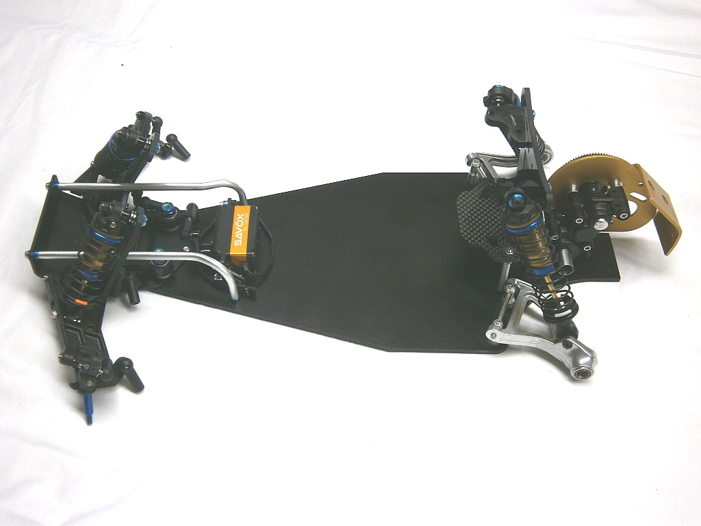

Yesterdays USPS delivery brought some Lunsford Titanium goods, RC10GT Wide Front Axles (not listed @ Lunsford, you'll have to ask for them), and some Super Duty, 3.5mm Turnbuckles. I used 4.8mm Lunsford ball studs and Super Duty Rod ends. The servo connection uses 3mm x 16mm Punisher turnbuckle with cut down RPM rod ends. Tight quarters there but everything works out perfectly with the Factory Works 180* bell cranks.

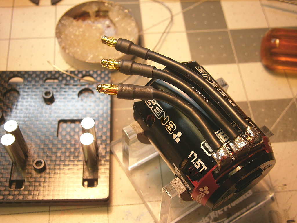

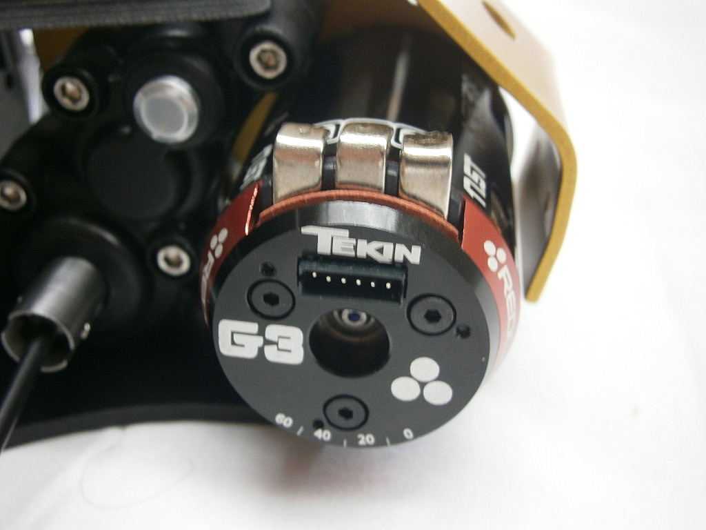

Pigtails soldered onto the Tekin motor. Next is the speed control wires. I'm going to shorten them up some.
