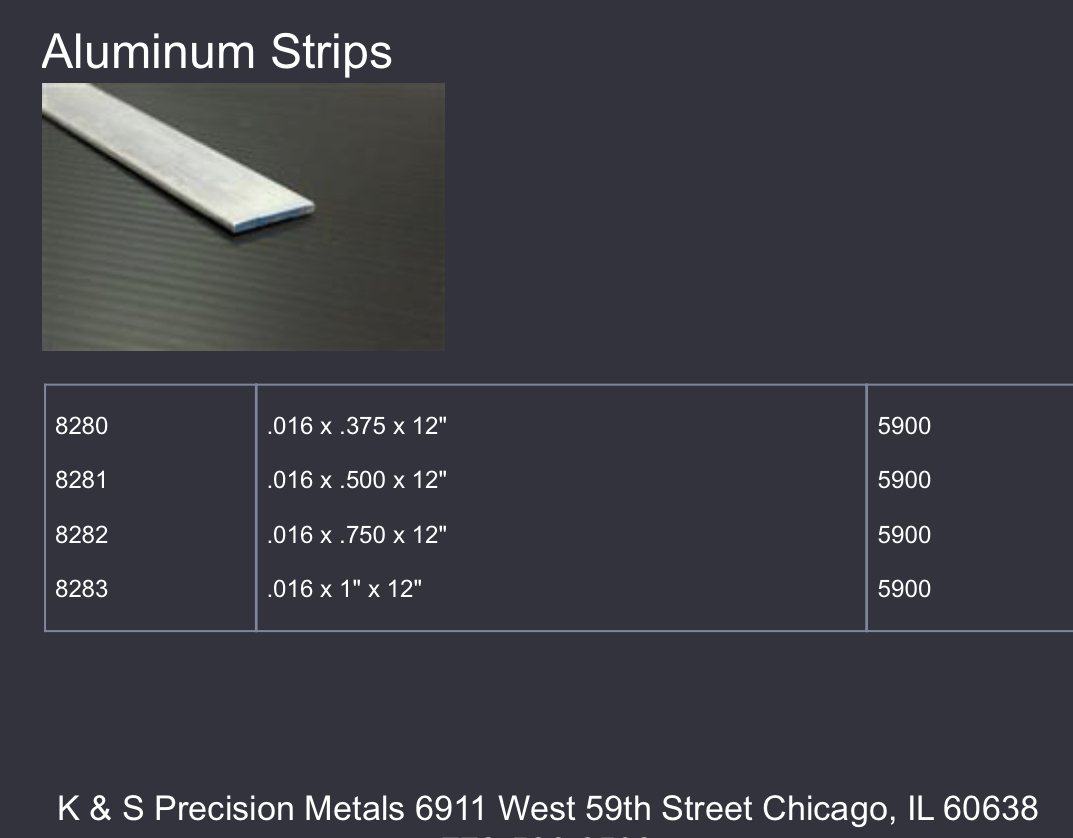

Most larger hobby shops and some hardware stores carry K&S metals. They have some that might be close to your requirements. If nothing else you can usually get them from tower hobbies or other onlines

So, I paid a visit to the local Hobby Lobby this afternoon and found K&S 0.016” 4x10 sheet aluminum. I’m hoping this thinner material will also be softer and easier to cut and deburr than the previous metal. I’m going to try cutting it with a metal rule and utility knife as before but this time laying on the iron top on my table saw. Hopefully the hard backing will allow for a cleaner cut and less burr to remove. If this doesn’t work, I’ll just go with the decals.
