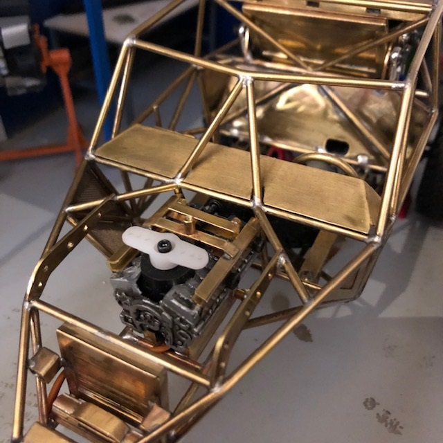

Fabricated a new steering rack with a 3mm ram just to be on the safe side and started on a mount for the rack on the front axle. Also managed to get started on the engine/servo mount. Cables will run in a loop from the servo in under and be clamped to the link arms. Through the front axle up to the steeruing linkage.... at least in theory :? :lol:
Tried to upload photos, but they all uploaded upside down so I'll get back to you on those...

A few pics

Again, very nice work - you are a master craftsman sir. 8)
BTW - love seeing the 996 in the background. I've come very close to buying a 1:1 on at least a couple occasions -- what a great bike!

Yes, superb work my friend . Digging the steering servo enclosed within an engine block, very slick!

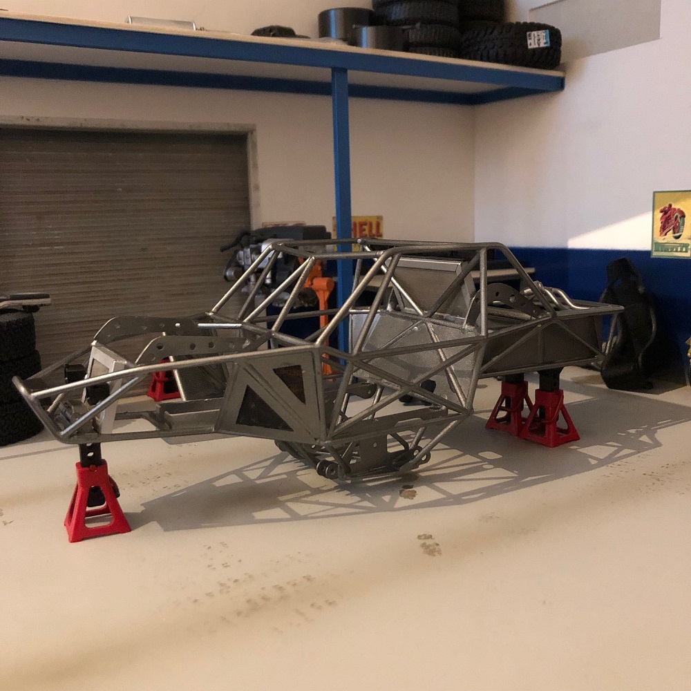

Small update on this.
Got the chassis painted. Time to put it all together.

Paint job looks nice, did you use a "sealer or topcoat"?

NomadRacer wrote: Sat May 18, 2019 8:50 am Paint job looks nice, did you use a "sealer or topcoat"?
Thank man,
At this time its only primer and paint. Have some ideas of waterslide decals and after that it will be a semi gloss layer or two.
