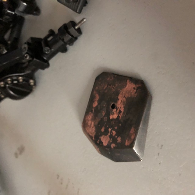

It's been awhile. I disassembled the hole car/truck to prepare all the individual parts for final finish.
Got delivery of the M1.4 countersunk screws for the body panels and have started the transformation from brass bling to steel gray with JAX pewter black.

No matter how I pre-treated och after-treated the brass the oxidation just wouldn't stick. It was fine the first dat and the day after I could smear it off with my thumb.

Re: RC4WD 1/18 Gelande 2
That's a shame about the surface finish but it still going to look awesome !
Paint job looks nice, did you use a "sealer or topcoat"?
Thank man,NomadRacer wrote: ↑Sat May 18, 2019 8:50 am Paint job looks nice, did you use a "sealer or topcoat"?
At this time its only primer and paint. Have some ideas of waterslide decals and after that it will be a semi gloss layer or two.
