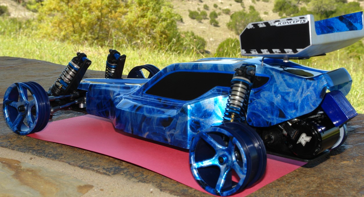

I did dye the wheels for the Houge before I painted them.
Totally forgot about that until just now
They took dye as well as any other nylon I have done.

Thanks Chuck, that’s good to know. I could order a few sets in white then dye them later to the appropriate color.radioactivity wrote: ↑Wed May 15, 2019 11:23 pm Doug
Chuck
Btw, your car looks awesome -- like it’s been carved from a chunk of blue marble. Just amazing!
