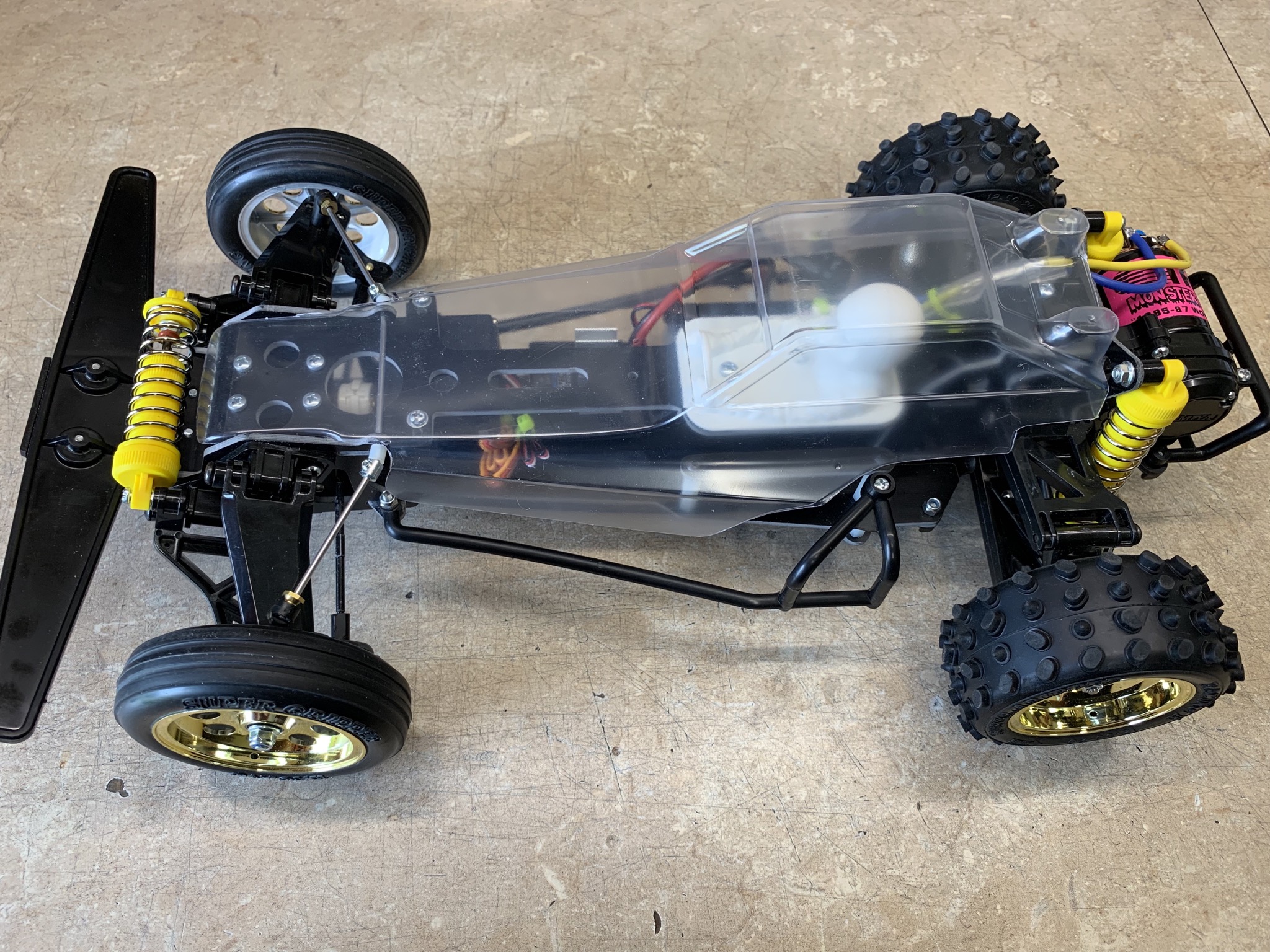

This is our new chassis set for the Fox and Nova Fox. It took us a while to come up with this design. We use a similar interlocking setup as our Hotshot. We have two sets of servo mount holes, you can leave it offset or center it up. We designed it to reuse the driver figure because, well, its kind of a Tamiya thing. Still plenty of room to run a standard or shorty lipo in the standard location, or you can move the electronics and run a shorty down the center.

Spent some time the last few weeks making the Factory Works Fox chassis better. I was never completely happy with version 1, the wonky stock steering was carried straight over and the crazy Ackerman just drives me nuts. The v2 now has our ball bearing steering kit slid in there with the entire front end worked over to accept it. Really excited to see the terrible novafox sway bar actually functioning and the body fitting without any trimming or redrilling.
It will still take a while to get the instructions written up but overall I am very happy with the way this new version is working out. Hopefully within a week or so I will have these listed on the Factory Works website.

I like it way more in natural GRP , excellent job .
- Posts: 12214
- Has thanked: 1084 times
- Been thanked: 3762 times
Re: Factory Works “no Fox given” chassis set
Same here. I did one in black too but it all just blends together.
