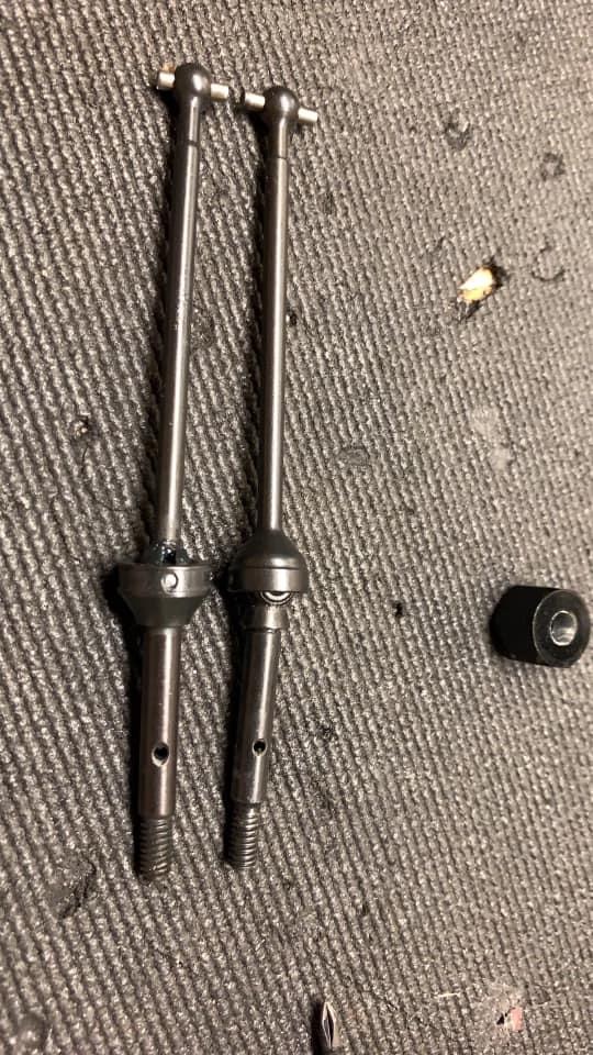

So I got the B4 CVA axle in the mail today, and when compared with the Custom Works Medium Lenght CVD, it’s the same lenght, the problem is, with the b4 hub and Klein arms, it’s too short, and with GT hubs and Klein arms, it’s a tad too long,
For it to work properly, I used a 2.5 mm of shimming or spacer behind the B4 hub, and added limiters in the 1.32” shocks and it works perfect, I still ordered 1.18 shocks to replace the 1.32 shocks.
are B44 dog bones the same length as B4 dogbones?

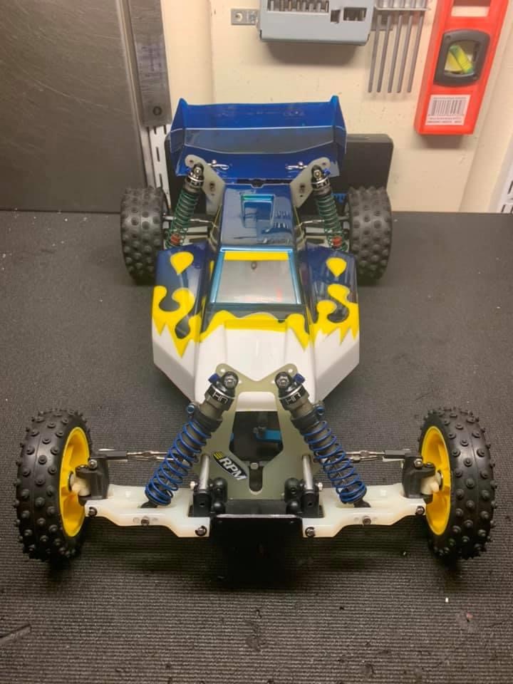

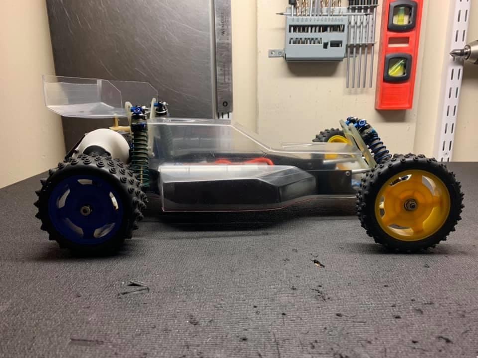

Hacked and Mocked the body I got from eBay, not my favorite thing in the world, but it’ll make a good runner/basher body😁
tecnica2001
Posts: 1047
Has thanked: 19 times
Been thanked: 29 times
Re: Tecnica’s RC10 — 2020 VONATS BUILD (maybe)
Post by tecnica2001 »

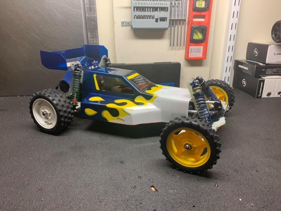

Here it is, all painted up😁
I wish the yellow paint matched up better with the wheels, but that’s Ok👍

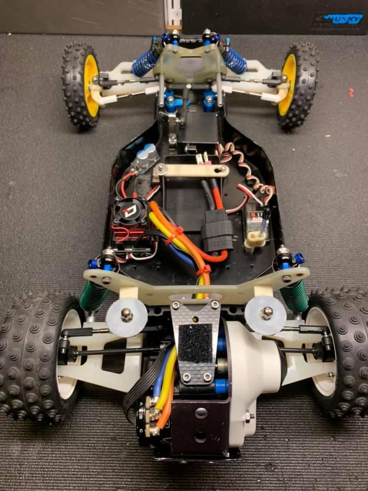

XLR8
Posts: 3019
Has thanked: 1273 times
Been thanked: 913 times
Post by XLR8 »
I think your under-body electronics should run very cool. :wink:
Anyway, the car is unique and I think it looks great!! :D
Good luck at VONATS.
tecnica2001
Posts: 1047
Tell me about it😂😂😂
I’ll be on the lookout for a Viper body, it’s a lot tighter against the chassis....this will do for now😁

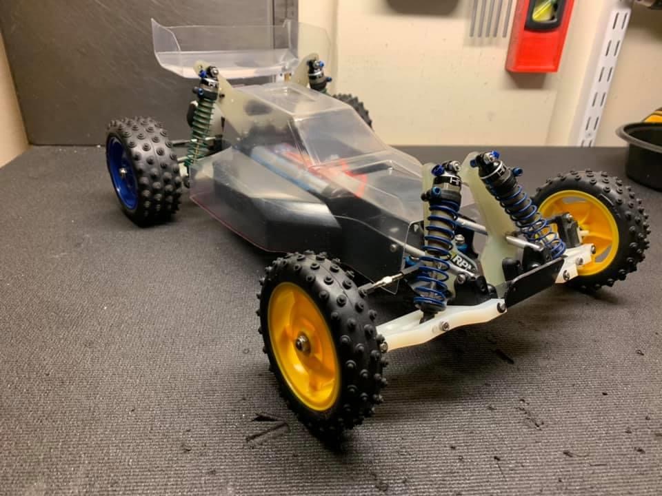

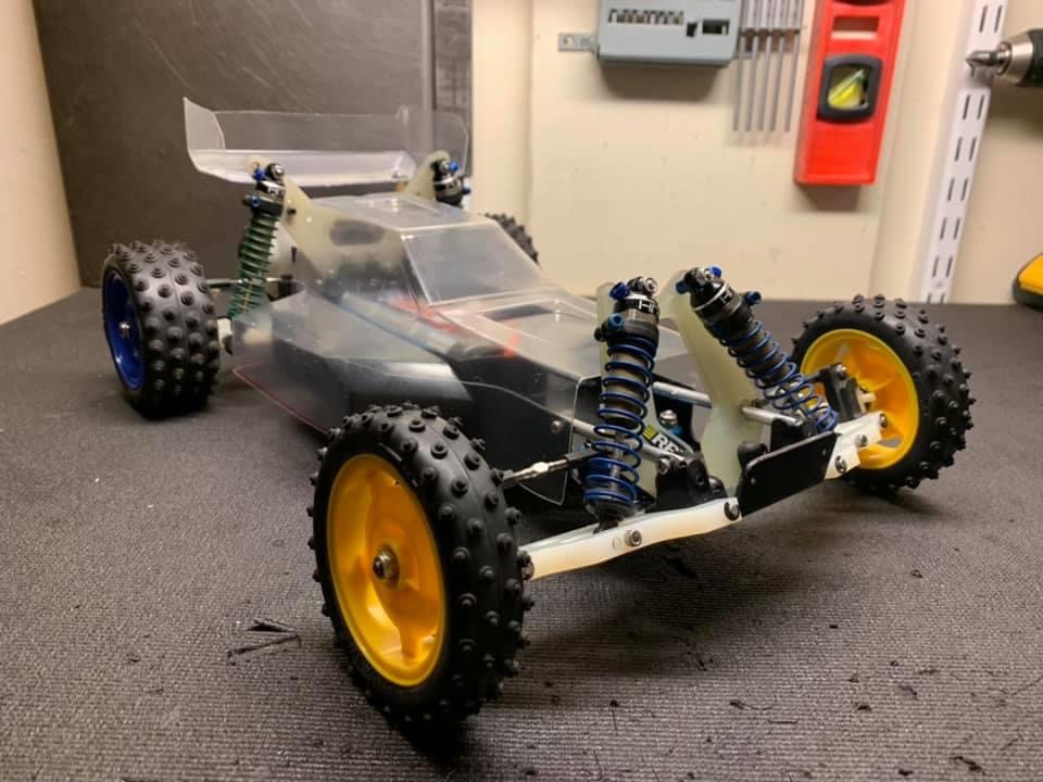

Gave it a bit of a nose job, it was feeling self conscious, so it got a bit of plastic surgery😂

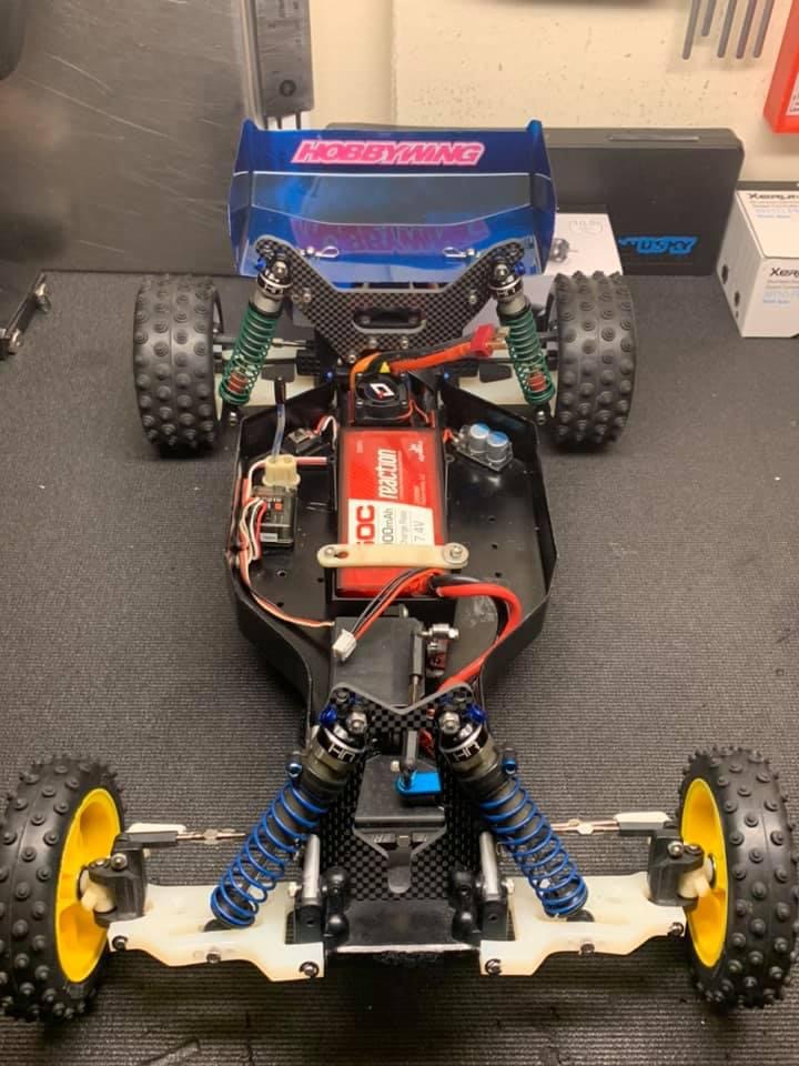

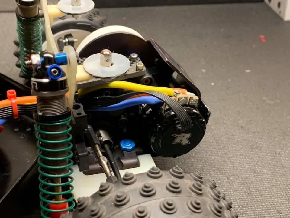

Added Electronics:
Hobbywing 13.5t Brushless Juststock Combo

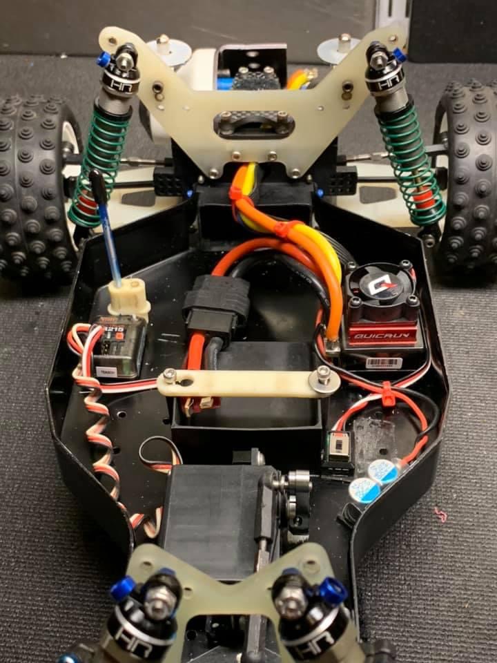

tecnica2001
Posts: 1047

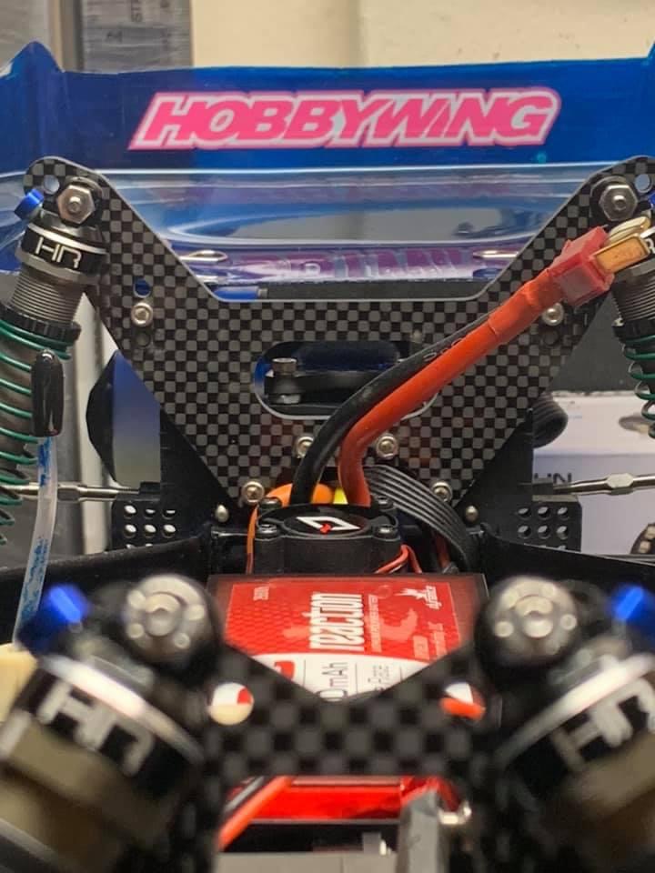

New Carbon Shock Towers
Re-arranged the electronics 😁
