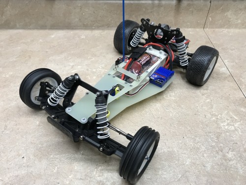

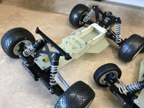

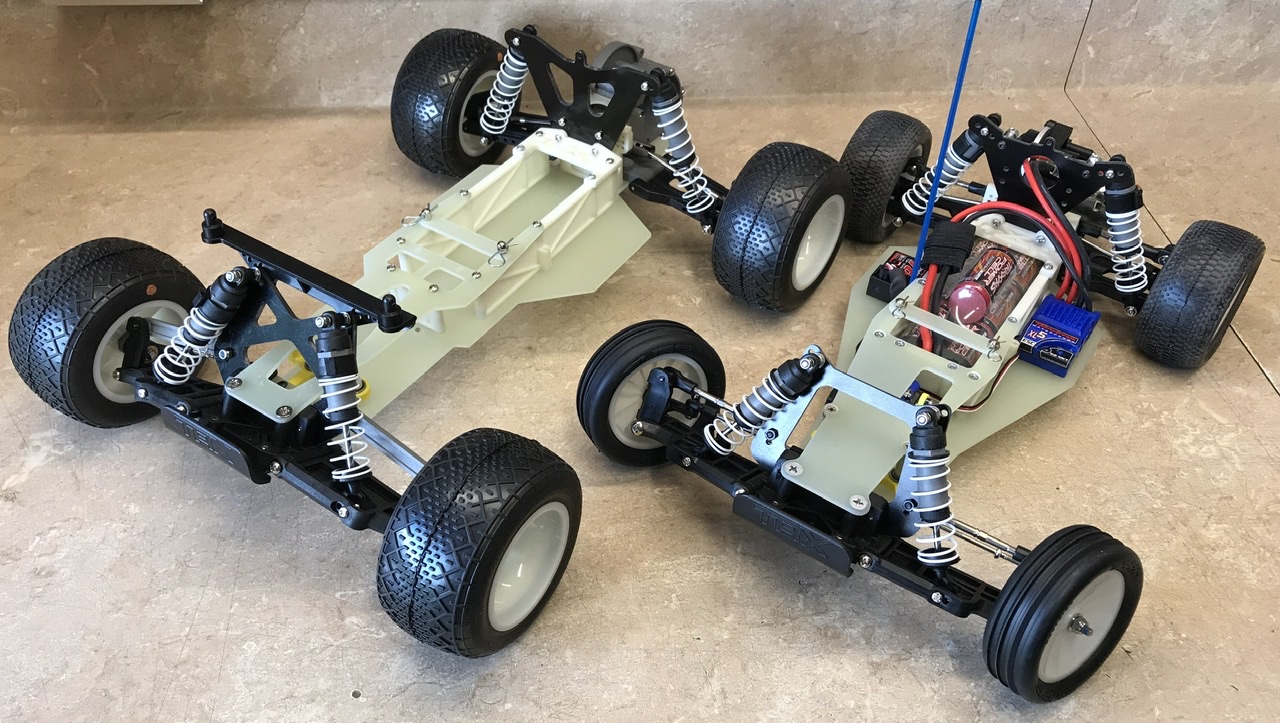

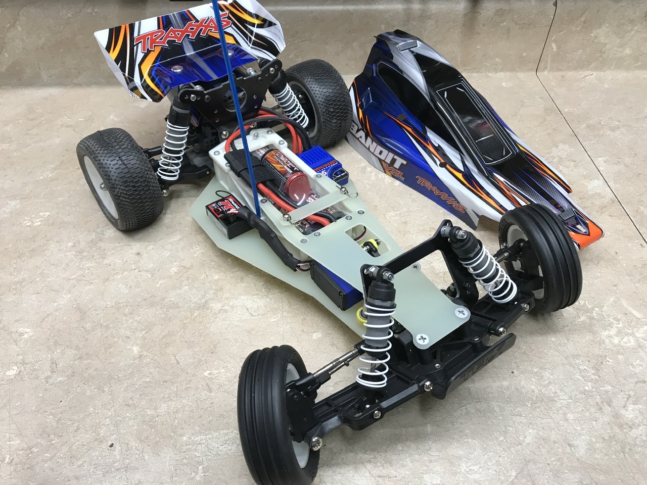

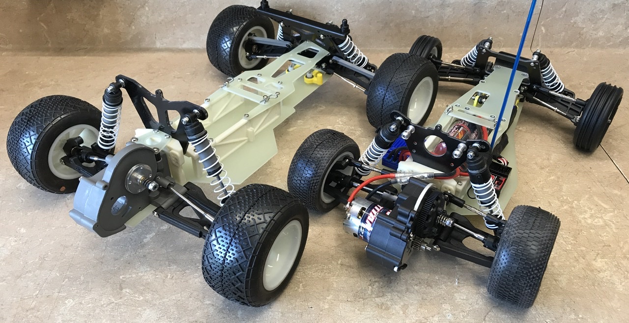

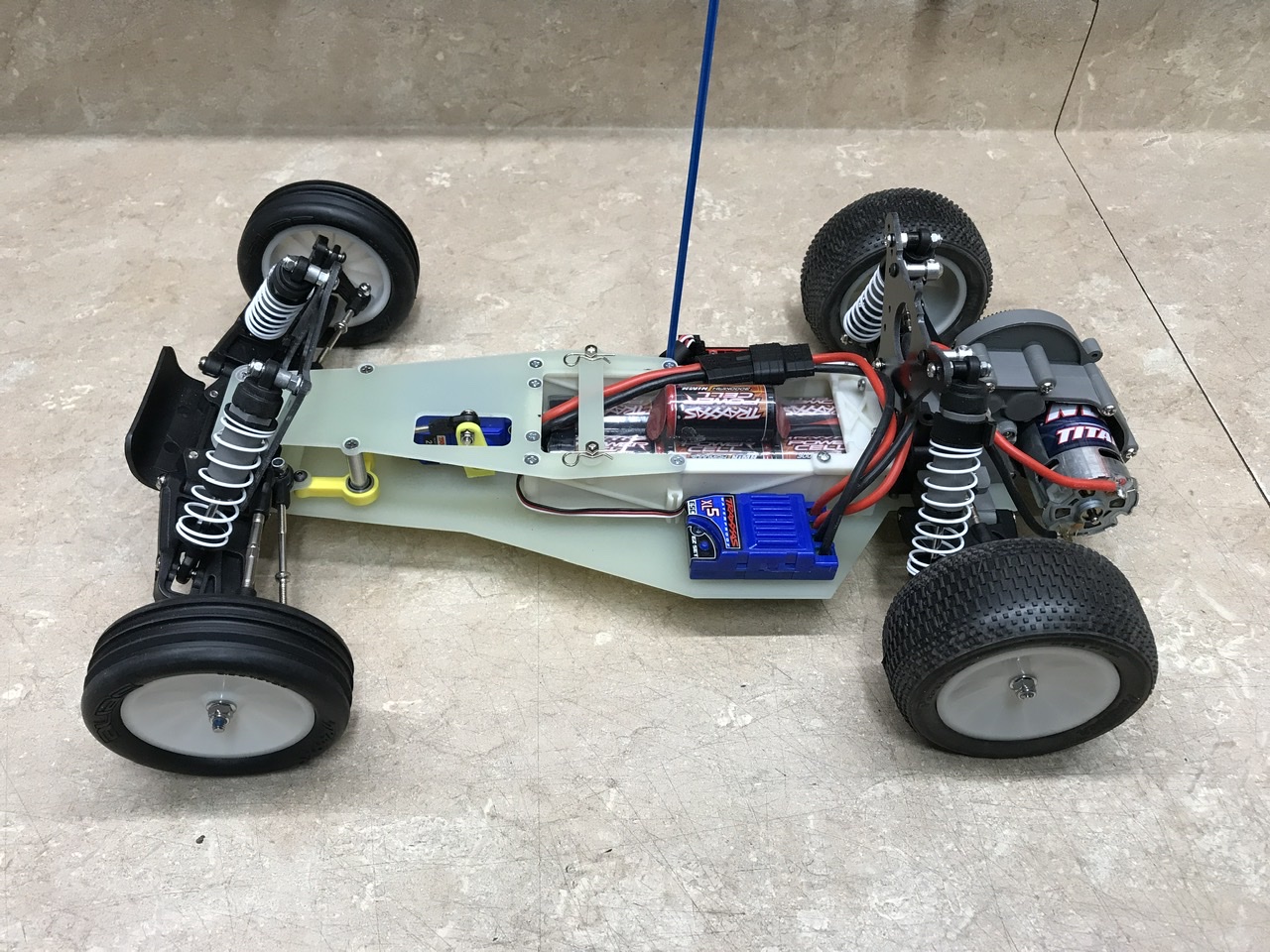

It’s a lot different. The front bulkhead is wider on a bandit, front tower incompatible. Front caster blocks and steering is all different. The trans and arm mounts are one piece so you have no adjustability and it’s narrower. Trans internals are different as well as the ratio. The rear arms are the same.
I (Factory Works) make a conversion chassis to do exactly that though. It looks like a TRX3 but uses the Bandit components. We use a nitro stampede rear bulkhead and spacers as the old TRX1/3 are impossible to find (in the pics are original pieces). It took a lot of work to create the conversion, several revisions to get it right. We have a SRT style Rustler as well.
