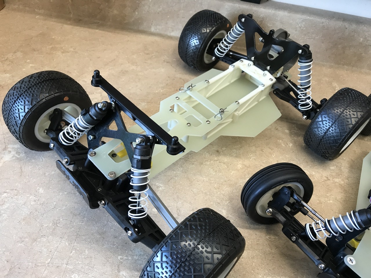

I've always had a soft spot for old Traxxas stuff like the Bullet. When the TRX-1 came out BITD, I was really intrigued. I'm not overly knowledgeable on Traxxas stuff, but how much of the TRX-1 DNA made it into the Bandit we know today? I have this strange idea for a project to add some type of fiberglass chassis (or make one if one isn't available) to a Bandit, make some upgrades and top it off with a repro TXT-1 body. In the end, would the resulting buggy be somewhat on par with an old 6 gear RC10 or even a JR-X2 or am I dreaming? Thanks for any Traxxas insight.

It’s a lot different. The front bulkhead is wider on a bandit, front tower incompatible. Front caster blocks and steering is all different. The trans and arm mounts are one piece so you have no adjustability and it’s narrower. Trans internals are different as well as the ratio. The rear arms are the same.
I (Factory Works) make a conversion chassis to do exactly that though. It looks like a TRX3 but uses the Bandit components. We use a nitro stampede rear bulkhead and spacers as the old TRX1/3 are impossible to find (in the pics are original pieces). It took a lot of work to create the conversion, several revisions to get it right. We have a SRT style Rustler as well.

Yes and I think the MIP goodies (for the 272 "Magnum") are still somewhat "widely" available.....
And a guy could always shear the rear arm mounts from the gearbox assembly and use the separate mounts if the chassis is drilled for them. I THINK.

RPM makes a trans case with a metal motor plate and separate, replaceable inner arm mounts. Proline used to make a whole trans but I think its discontinued. The trick is getting donor Bandit cheap. Folks on my local C-List and Marketplace are asking far more for their used examples than a new one from Traxxas. The new one is relatively cheap, but by the time you start adding in all the cool parts, I'm getting into re-re Ultima money and I'm not sure a hopped-up Bandit is better than or even cooler than an Ultima. I do have a Stampede I could gut but there's quite a few Bandit specific parts I'd need to get. Decisions decisions.

You could go for one of the used Rustlers if they go for less and just swap out the arms, Traxxas or RPM. The chassis is identical, not like everyone else, where the truck chassis is longer.Saito wrote: ↑Sat Jul 25, 2020 1:49 pmYeah, I know. It seems like Stampedes and Rustlers are more popular but the prices on these used Bandits around me are nuts. On my local trade sites there's 3 ATM. One is a used XL5 for $235 but comes with an extra battery and charger. The second is a used VXL for $260 and the third is a used VXL with 2 extra batteries for $400. Come'on people, a brand new XL5 is only $159 and a new VXL is only $269. Prices have been up like this before Covid too. I guess I shouldn't be surprised. Some fool is trying to get $100 for an old used Parma Gravedigger body with a huge hole cut in the hood and windshield. Hey, it even comes with extra holes drilled in it in various locations! What a bargain!
