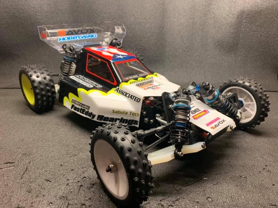

A couple of body off photos of this Monstrosity of a car😁
tecnica2001
Posts: 1047
Has thanked: 19 times
Been thanked: 29 times
Re: 4wd RC10 — 2021 VONATS Entry
Post by tecnica2001 »
Sabula Tech Jammin Body and B6.2 Wing
