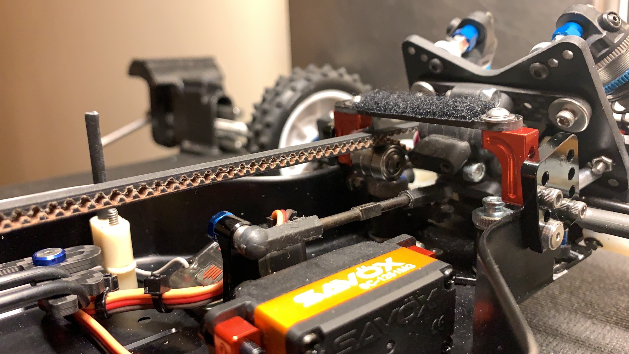

romulus22 wrote: Sat Nov 21, 2020 2:50 pm Cool project!
And just a question about cars like these. Is belt slap ever a concern? Where the belt cogs hit each other and cause wheel lockup or just momentary loss of power?
How dare you question my design🤔
It’s possible, there is a lot of flex and twisting in the chassis, especially in the rear, so in my case, I’m planning on bracing it to help eliminate some of the flex.
Another thing is tensioning and belt spacers, which are possible solutions and safeguards against the belt running into each other 😁
Posts: 12214
Has thanked: 1084 times
Been thanked: 3762 times
Re: 4wd RC10 — 2021 VONATS Entry
A simple piece of lexan works well to keep em separated too ;-)

GoMachV wrote: Sat Nov 21, 2020 3:54 pm A simple piece of lexan works well to keep em separated too ;-)
Genius😳👍

Haha, no bad intentions in my questioning. I was actually going to mention exactly what Jeff did if you hadn’t already made a plan for it. It just looked really close in the pictures I saw

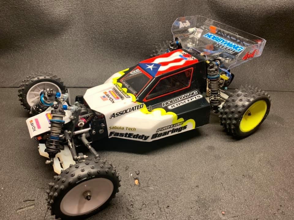

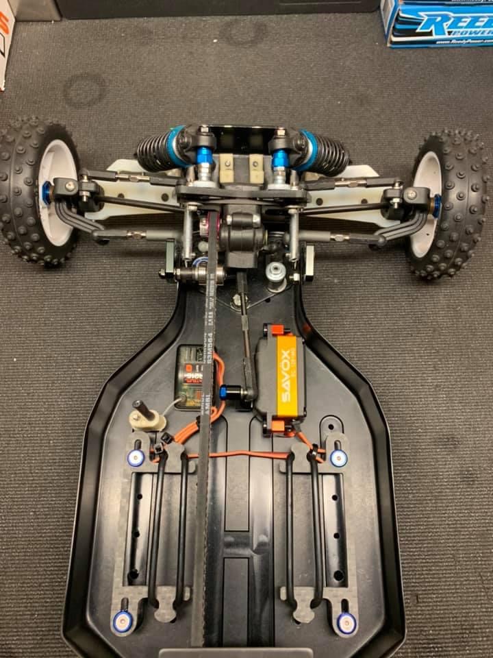

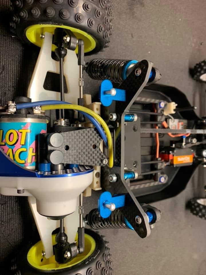

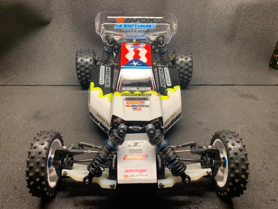

A couple of body off photos of this Monstrosity of a car😁
tecnica2001
Posts: 1047
Has thanked: 19 times
Been thanked: 29 times
Post by tecnica2001 »
Sabula Tech Jammin Body and B6.2 Wing

How did the pulley/ratio work out?
tecnica2001
Posts: 1047
Re: WOIN 4wd RC10 — 2021 VONATS Entry
jwscab wrote: Tue Jan 05, 2021 3:32 pm How did the pulley/ratio work out?
I’m using a 15t front pulley and a 13t rear pulley
