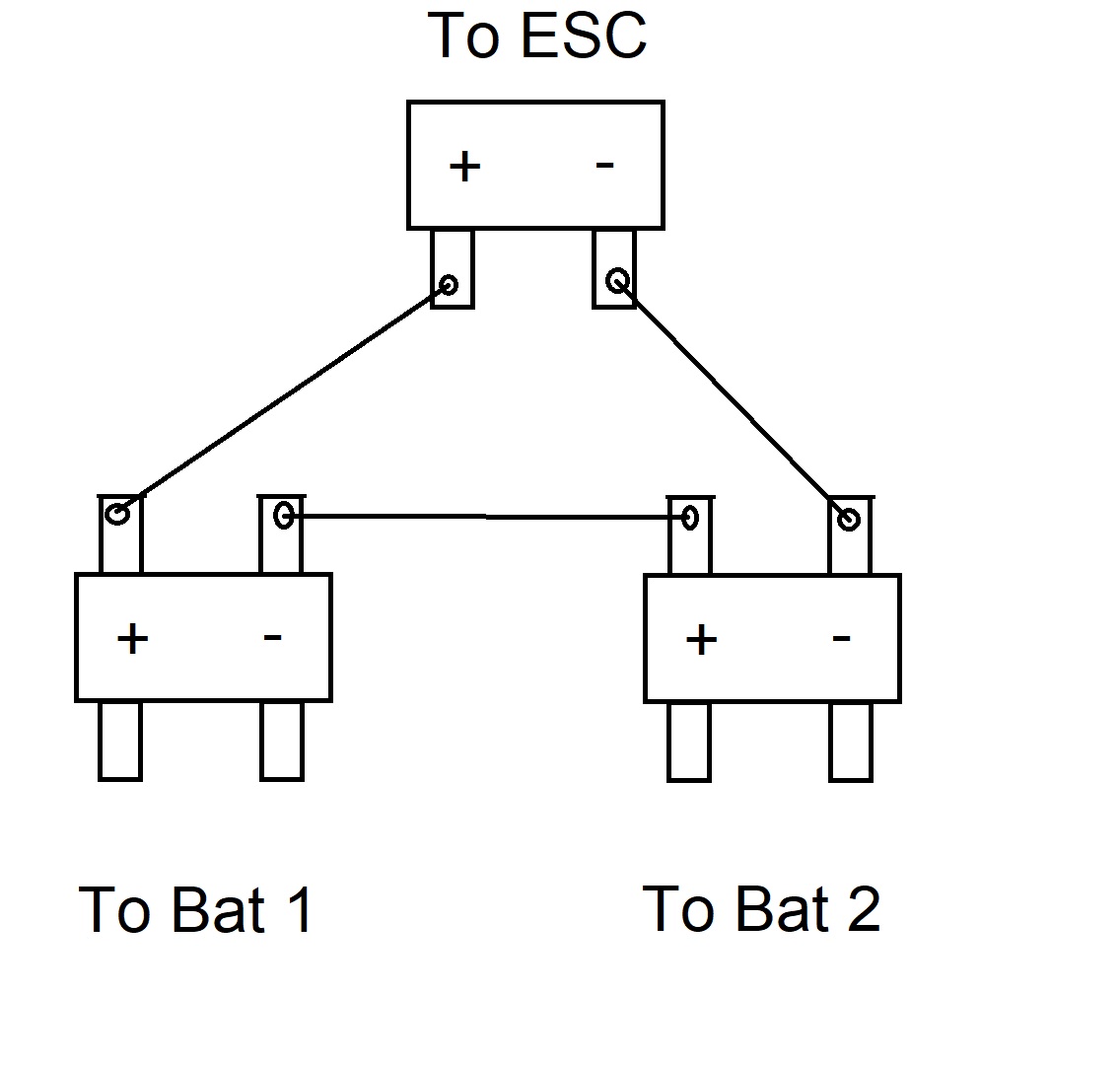

So, dumb question the first:
I need to get 8s power and there are two connectors attached to the ESC.
I have 4 x 2s batteries so I'm thinking that I can make two adapter cables as shown below.
Could someone please confirm that I am wiring this correctly? This should be simple but I've never done it before and I'd rather not burn down the house. :oops:
Thanks!!
Also, what gauge wire should I be using for these adapter cables?
thanks again!!!

correct....i would think 12 gauge would be ok

can the esc handle 8s?
12 gauge is probably fine as mentioned. be sure to heatshrink and insulate every thing very well. a short circuit anywhere there could cause major issues.

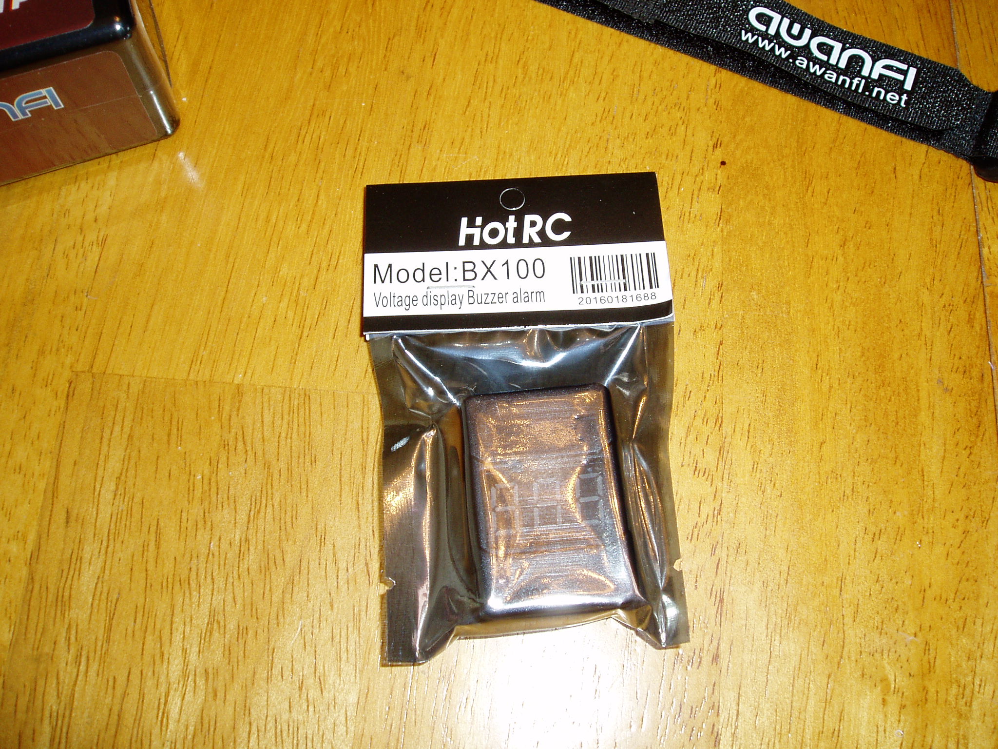

So the 3s batteries arrived today. I'll get those Deans connectors swapped to IC5 next.
One of the packs came with a voltage checker:

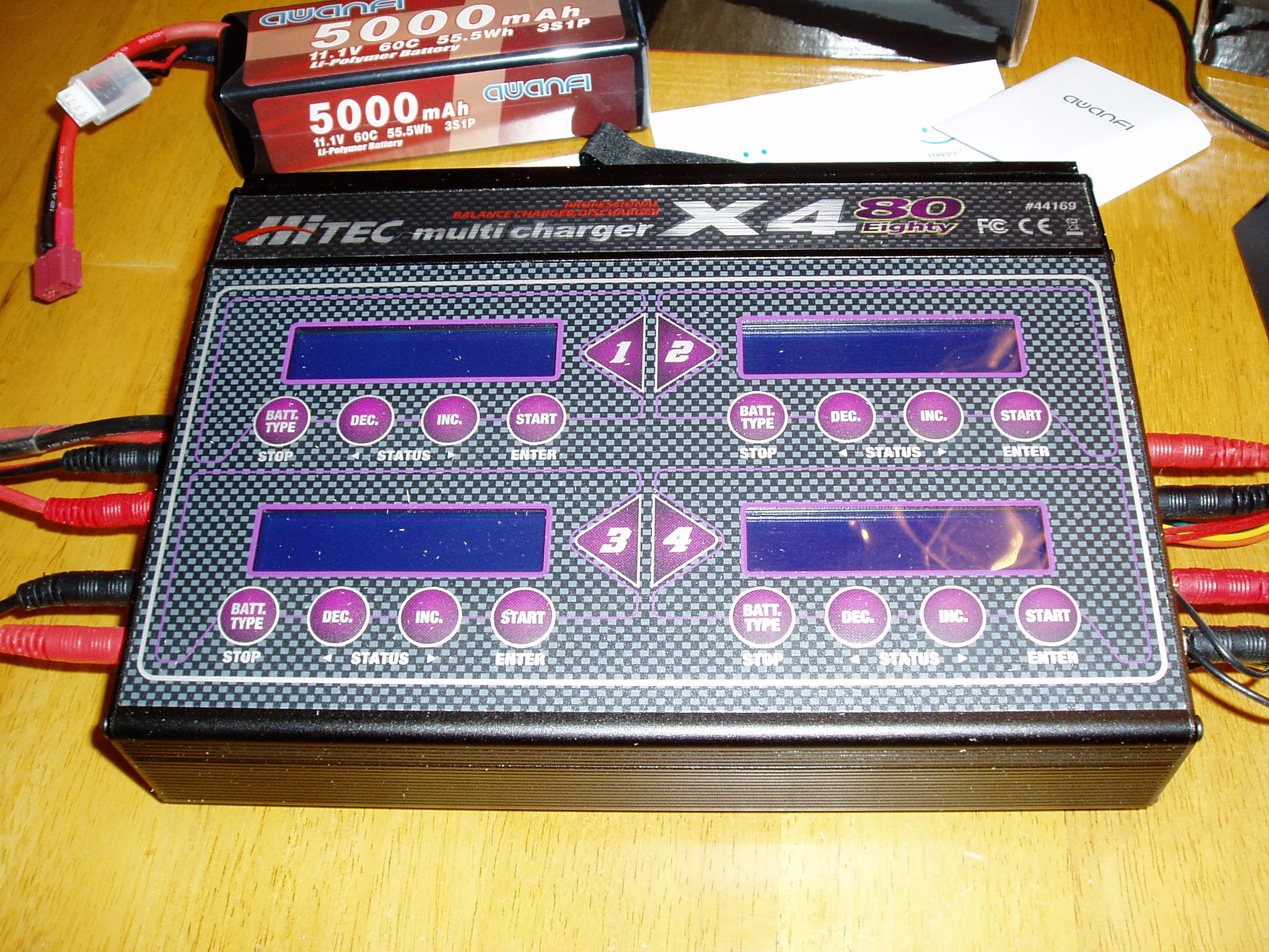

I've been using a Hitec Multi Charger with 4 independently programable charge stations...

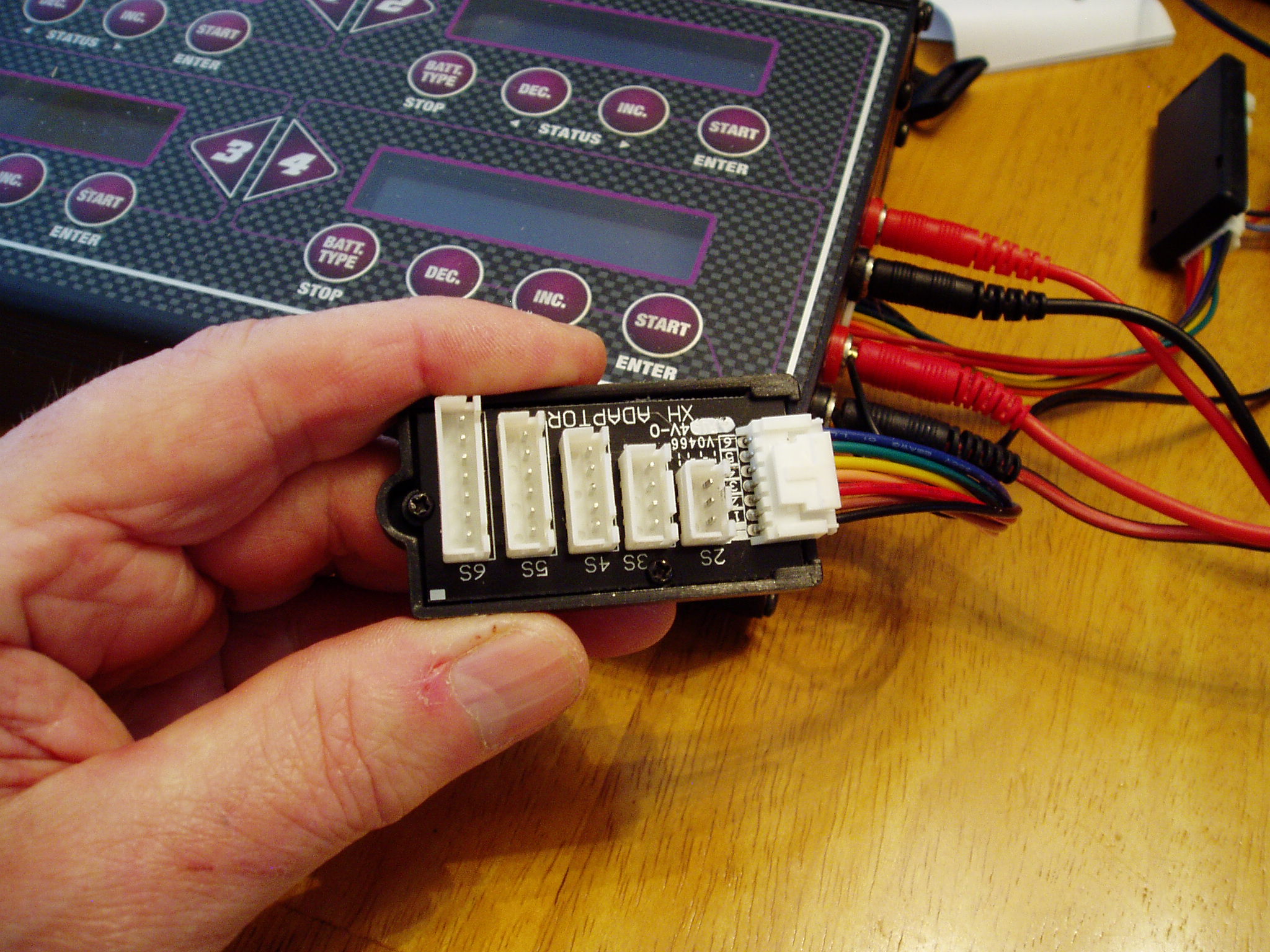

... that can balance charge 6 cells per station.
I prefer to balance charge my 2s packs. In fact, I've never charged them any other way.
I believe I could make a serial connector to charge both 3s packs from a single station but I'm curious about balance charging them. Is it possible to alter the charger's balance port configuration so that it can connect with all 6 cells from both packs?
