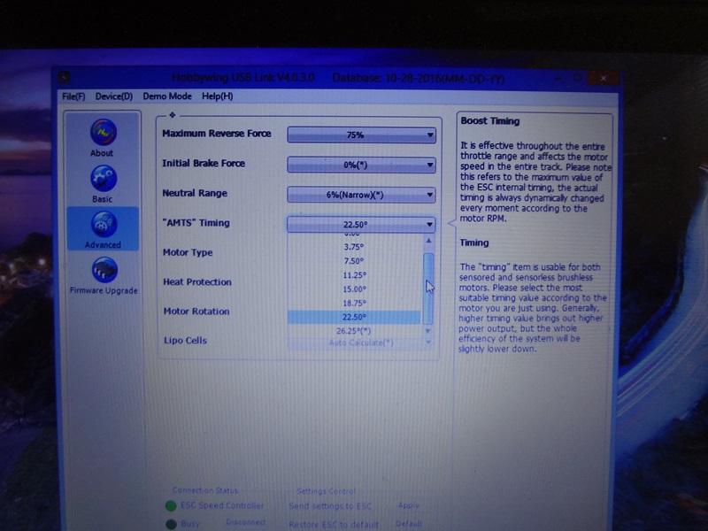

The boost, or timing advance through the esc is adjustable in increments as you can see here. This is my truck attached to my laptop with the interface.

I just can't remember what programming options were standard , the best option was to go to the hobbywing home website and flash it with the most up to date version of the software , it's a free download , then you have the full range of tuneing options .

cheers guys - what the above shows lets me think this is the original "xerun" platform, so no variable timing which appeared on the V2.
I mean, you can adjust the controller timing, but you can't adjust it as a function of RPM, which was the revolutionary feature that made the V2 series (and speedpassion derivatives) so popular.
You can't flash the variable timing software there either - too old a platform.
For the record, this feature was first introduced on the Advanced Electronics Black Diamond a decade or so ago... the speedo was like $300 or 400
then came the Team Wave RB series (which I had one of... and still have it! $200 with the LED programming card sounded like a bargain), then Hobbywing did the V2, sold bucketloads of them and this was over for everyone else
Net - great speedo for $12, I will still take a $30 X-car V2.1 clone instead
