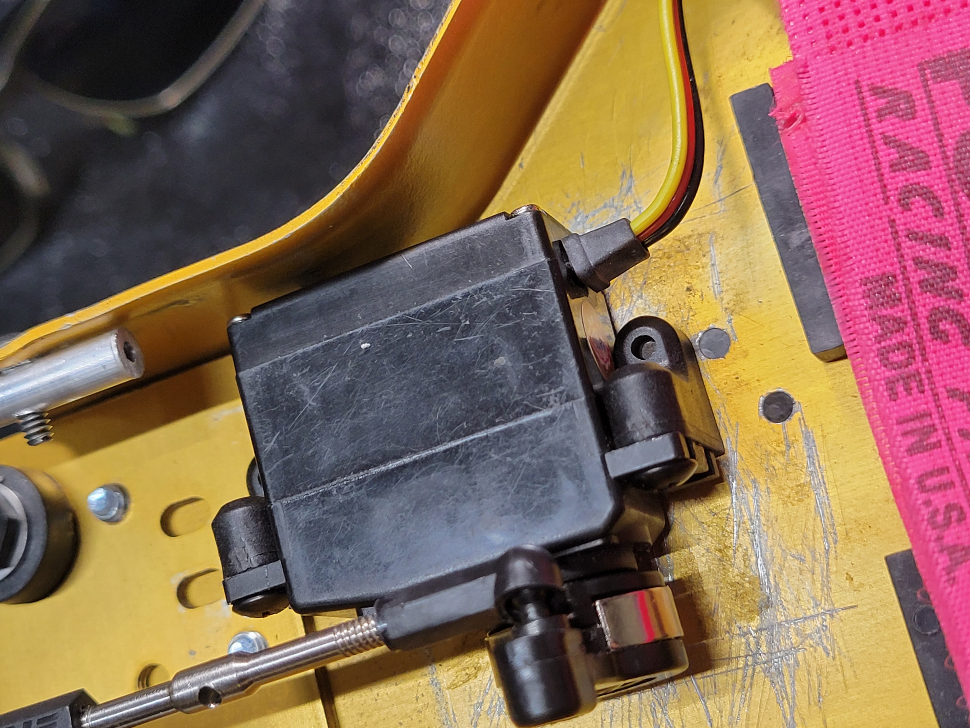

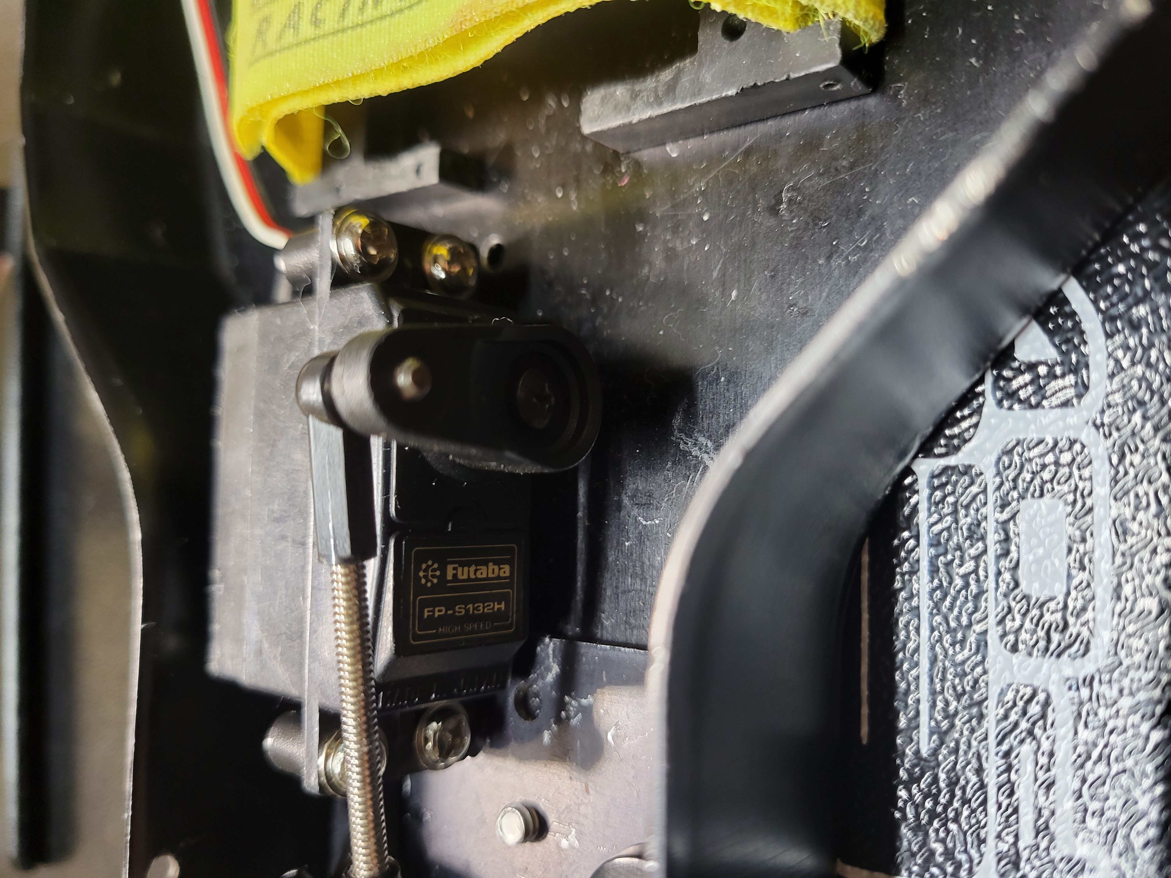

A Futaba S132H fits perfect, if you can find them. They pop up on eBay fairly regularly. Futaba had some others in that size but I don't remember the numbers.

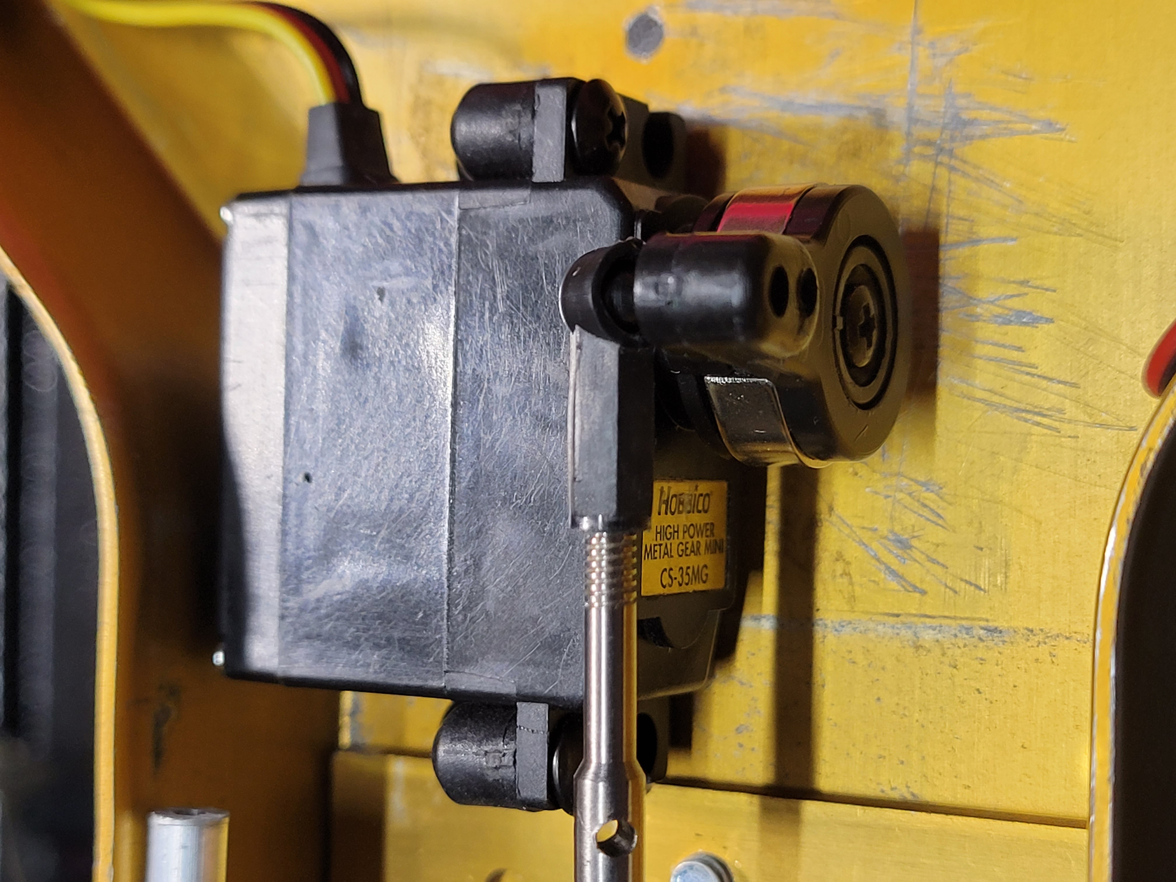

If you are willing to drill a new hole, a Hitec 225MG fits and offers even more room. The Hobbico servo in the gold pan is a rebranded 225.

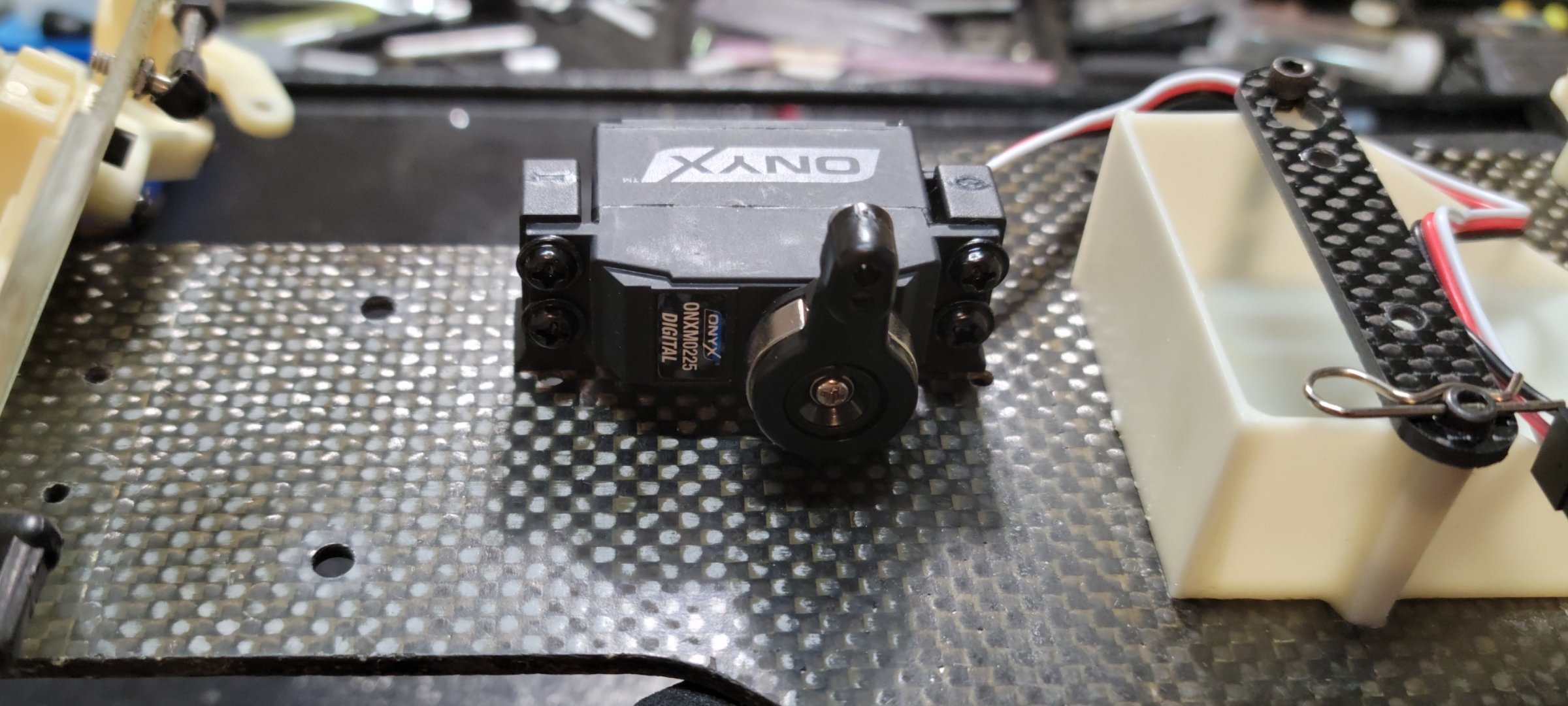

Following this up, I decided to try the Onyx servo.
I can confirm that it can be used with the original mini servo holes in the RC10 chassis. It isn't perfect but fits if you install it with the posts loose initially.
The RPM posts aren't the ones that will be used, they were just the only ones I have right now.
The servo itself is a little noisy for my taste but most newer ones are. I guess older Futaba and Airtronics servos spoiled me.
