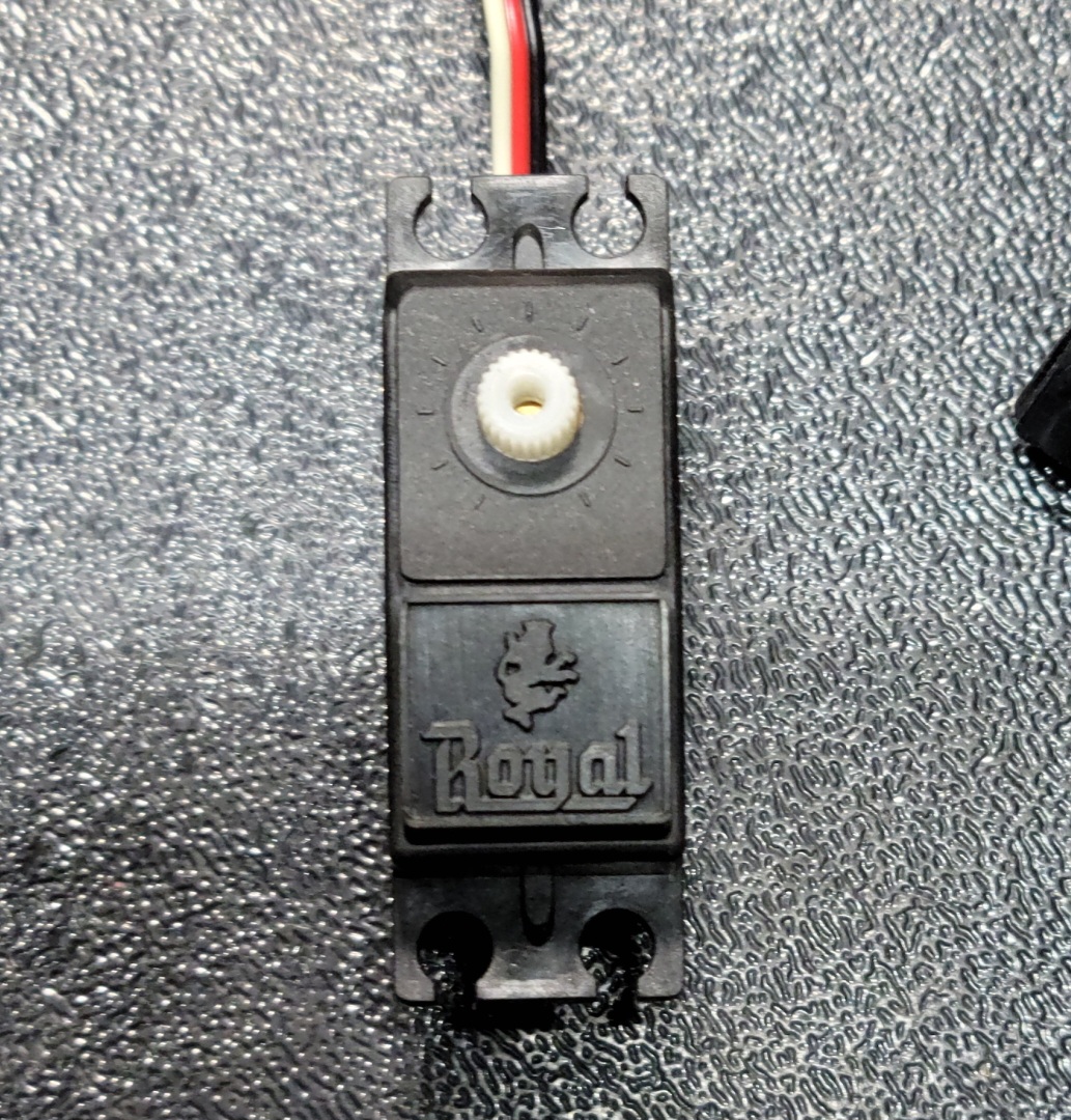

It seems that the Onyx S25 has gotten hard to find, so I went in search of something else.
Every time I searched Ebay for mini servos, these old Royal Titans kept showing up. I vaguely remember them in RCM adds, but they seemed more common in planes.
Doing a little research, I noticed that the specs and sizing are almost the same as the Futaba S132.

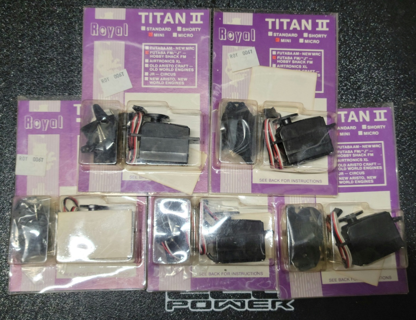

So I found this lot of new servos for a decent price and decided to try them.
As the ad listed, they are indeed the same size. They also have a cool vintage look. They are also 25T and were available with multiple different connectors.
Not that I'd use them in a serious runner, but they should be fine for a shelf car or one that sees mild use.
Posts: 12335
Been thanked: 3917 times
Re: Good Cheap 38mm Wide Servos?
I’d definitely keep them for the shelf. The gears were really bad, and their centering (or lack there of) was horrendous. I can only imagine how the gears have aged. Be gentle :wink:
