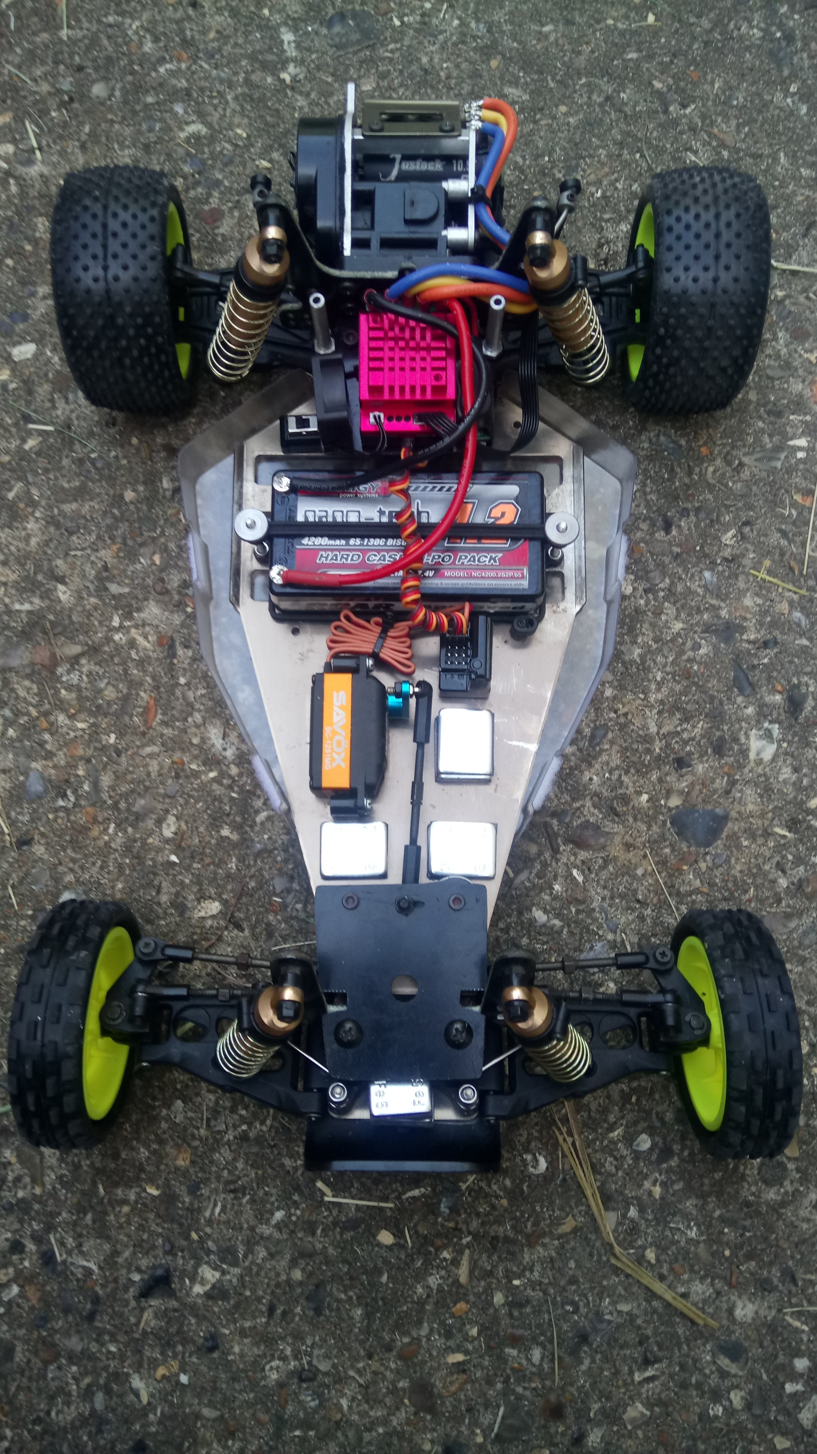

I present to you my original ultima pro.
This was bought off ebay last year as birthday present to myself to give me a large dose of nostalgia. I raced one as a kid back in 91-94 when everybody else had Schumacher cougars and rc10s.
I had to replace the front bulkhead and somewhere along the road a previous owner decided to cut down the top deck.
It now has a a shorty lipo conversion, savox low profile servo, hobbywing 10.5t motor and a turnigy trackstar 80a esc. Oh and jcracing 2.2 wheels.
I run it with an 18t pinion and 20‰ turbo on the esc and it is rapid. I run it as original as I can get it.
Have to say it is a joy to drive

Looks like a lot of "toe out" on front wheels, is that how they are set up or just the photo?

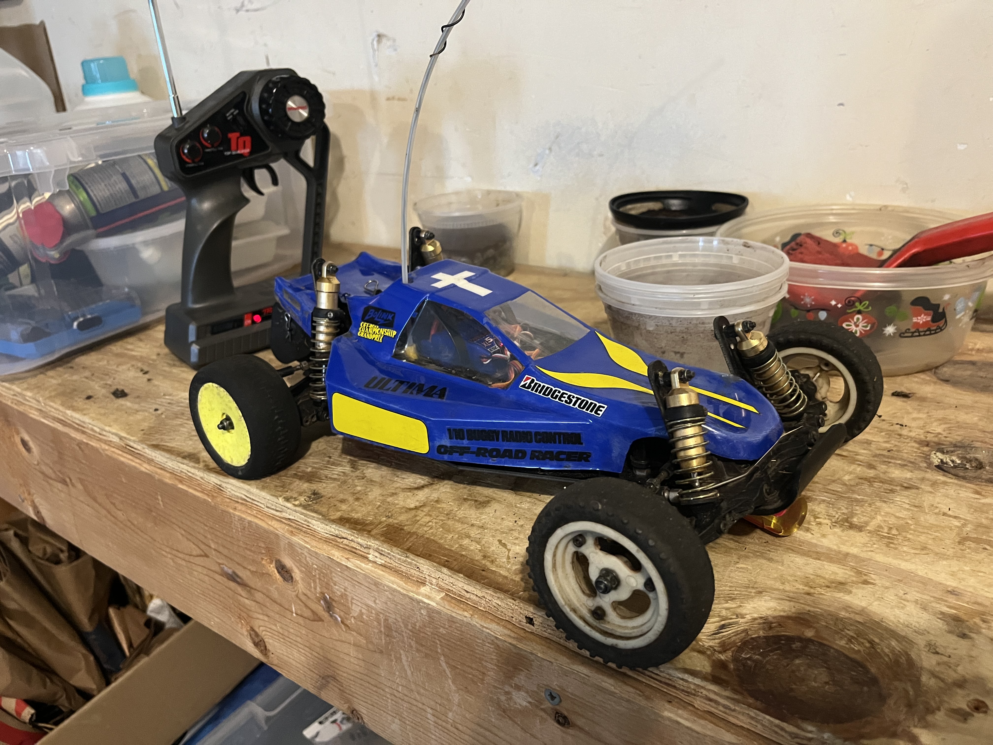

I agree...cellphone pics these days really seem to exaggerate toe angles, especially with top-down pics. Kind of a fish-bowl effect when taking close-up pics.

I have an Ultima Pro as well how did you get/make that under tray as I need one to stop all the dust and things getting inside it. also did you change the gears out with that new motor as I am worried if I put more power into it the gears could strip on mine. it runs well but there is a lot of steering slop may need help with that too.

I know that’s an oldish photo heres a better image of it right now and I’m really proud to have kept it functional. Removing the rear sway bar made it run better for me.

What bits did you use to do the shorty conversion mate? It looks great. I just picked up a pro with the same alloy chassis but was puzzled as to what holder I could mount but it looked difficult with all those slots for the saddle pack
