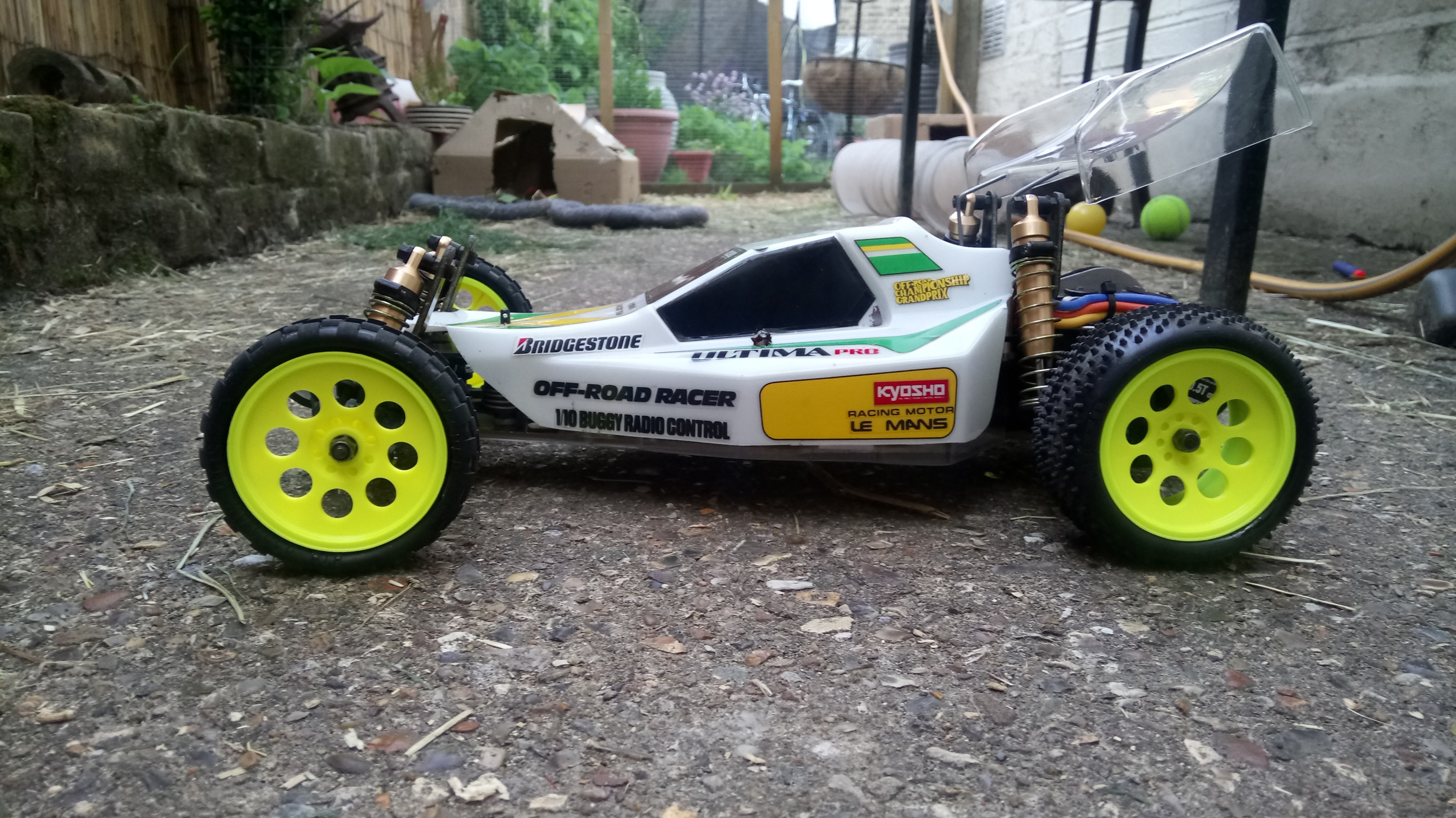

I present to you my original ultima pro.
This was bought off ebay last year as birthday present to myself to give me a large dose of nostalgia. I raced one as a kid back in 91-94 when everybody else had Schumacher cougars and rc10s.
I had to replace the front bulkhead and somewhere along the road a previous owner decided to cut down the top deck.
It now has a a shorty lipo conversion, savox low profile servo, hobbywing 10.5t motor and a turnigy trackstar 80a esc. Oh and jcracing 2.2 wheels.
I run it with an 18t pinion and 20‰ turbo on the esc and it is rapid. I run it as original as I can get it.
Have to say it is a joy to drive

Looks like a lot of "toe out" on front wheels, is that how they are set up or just the photo?

Do you run a hardened final pinion in the gearbox? Back in the day, my Turbo Optima would eat up the OEM aluminum final pinion, and then that would chew up the mating gear. A steel replacement from Thorp eliminated the problem. I do see the Thorp 4738 final pinion on eBay. It's overpriced, but might be worth considering.

I agree...cellphone pics these days really seem to exaggerate toe angles, especially with top-down pics. Kind of a fish-bowl effect when taking close-up pics.
Yep, agreed. Definitely a necessary upgrade, if it's gonna be a runner. I believe someone here sourced a generic one online somewhere that had the correct pitch and dimensions, but hope someone else can help out and link it.Frankentruck wrote: ↑Thu Jul 15, 2021 3:16 pm Do you run a hardened final pinion in the gearbox? Back in the day, my Turbo Optima would eat up the OEM aluminum final pinion, and then that would chew up the mating gear. A steel replacement from Thorp eliminated the problem. I do see the Thorp 4738 final pinion on eBay. It's overpriced, but might be worth considering.

Wow, what a nice ride you have there! I need to order myself a set of those wheels - they look great on your car.
"Have to say it is a joy to drive." I couldn't agree more.

What bits did you use to do the shorty conversion mate? It looks great. I just picked up a pro with the same alloy chassis but was puzzled as to what holder I could mount but it looked difficult with all those slots for the saddle pack
