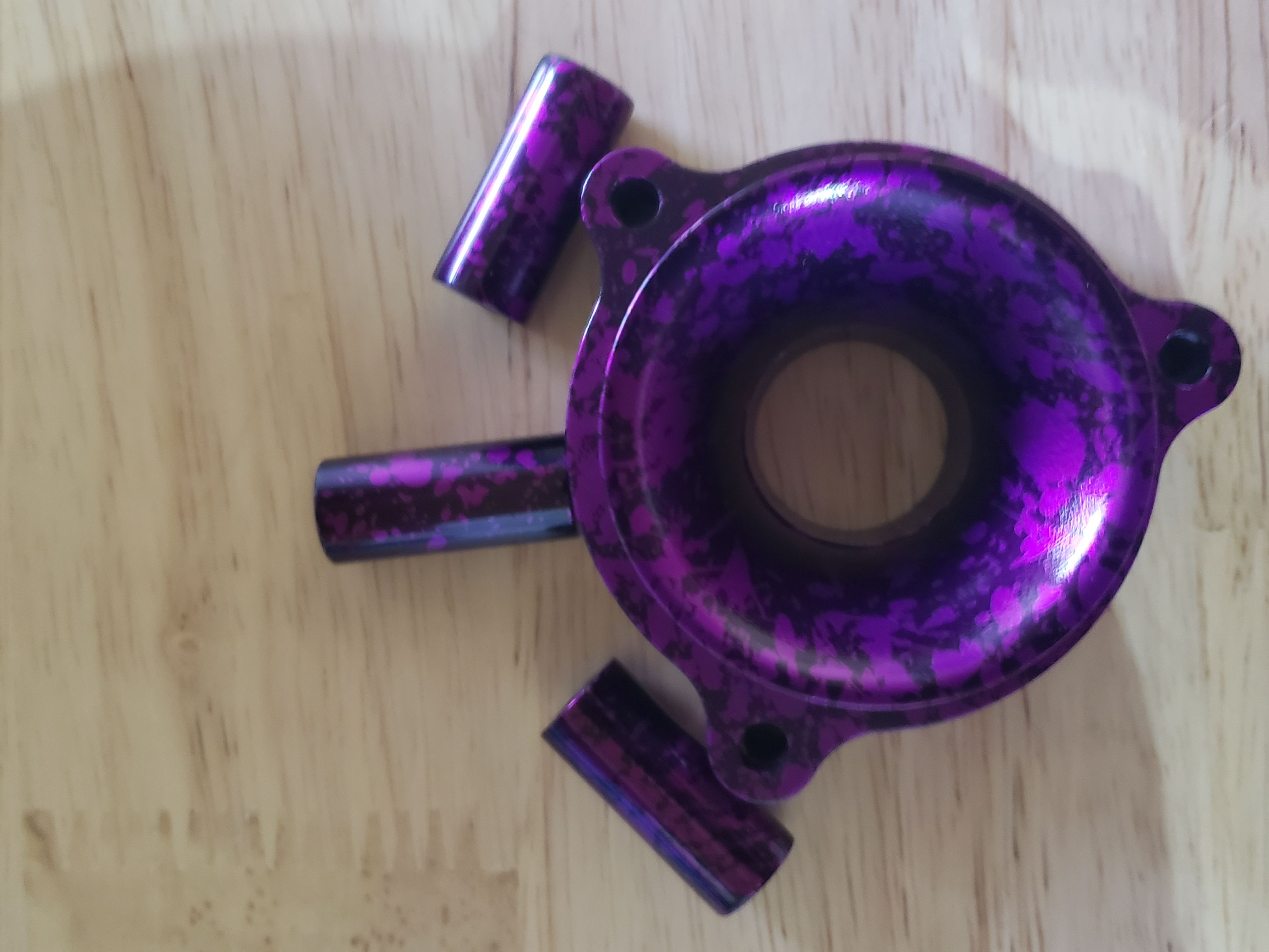

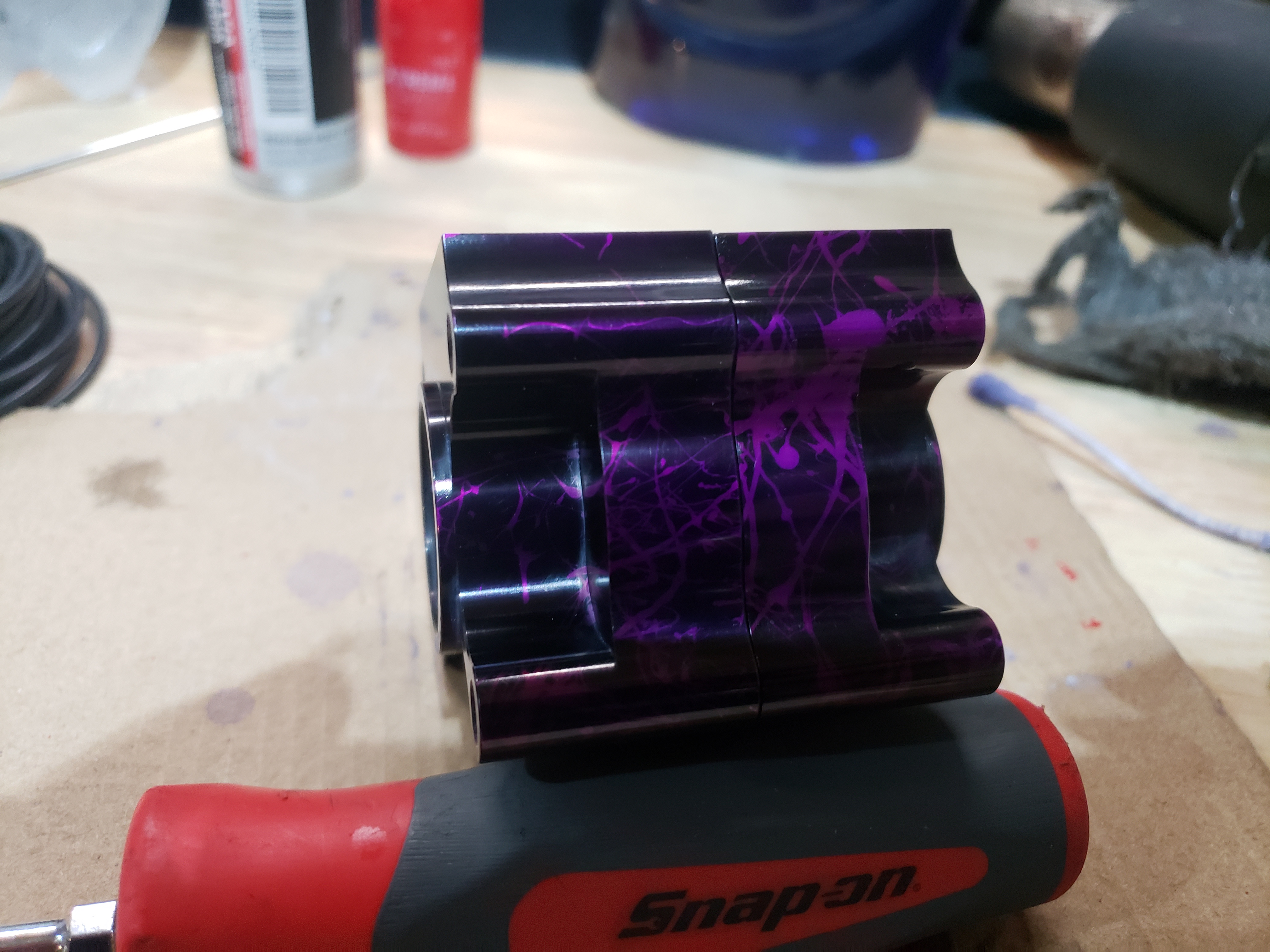

Here's a few things I've anodized. I also found 000 steel wool works excellent and doesn't scratch the anodized parts. Smut is found after the sealing process as well.
