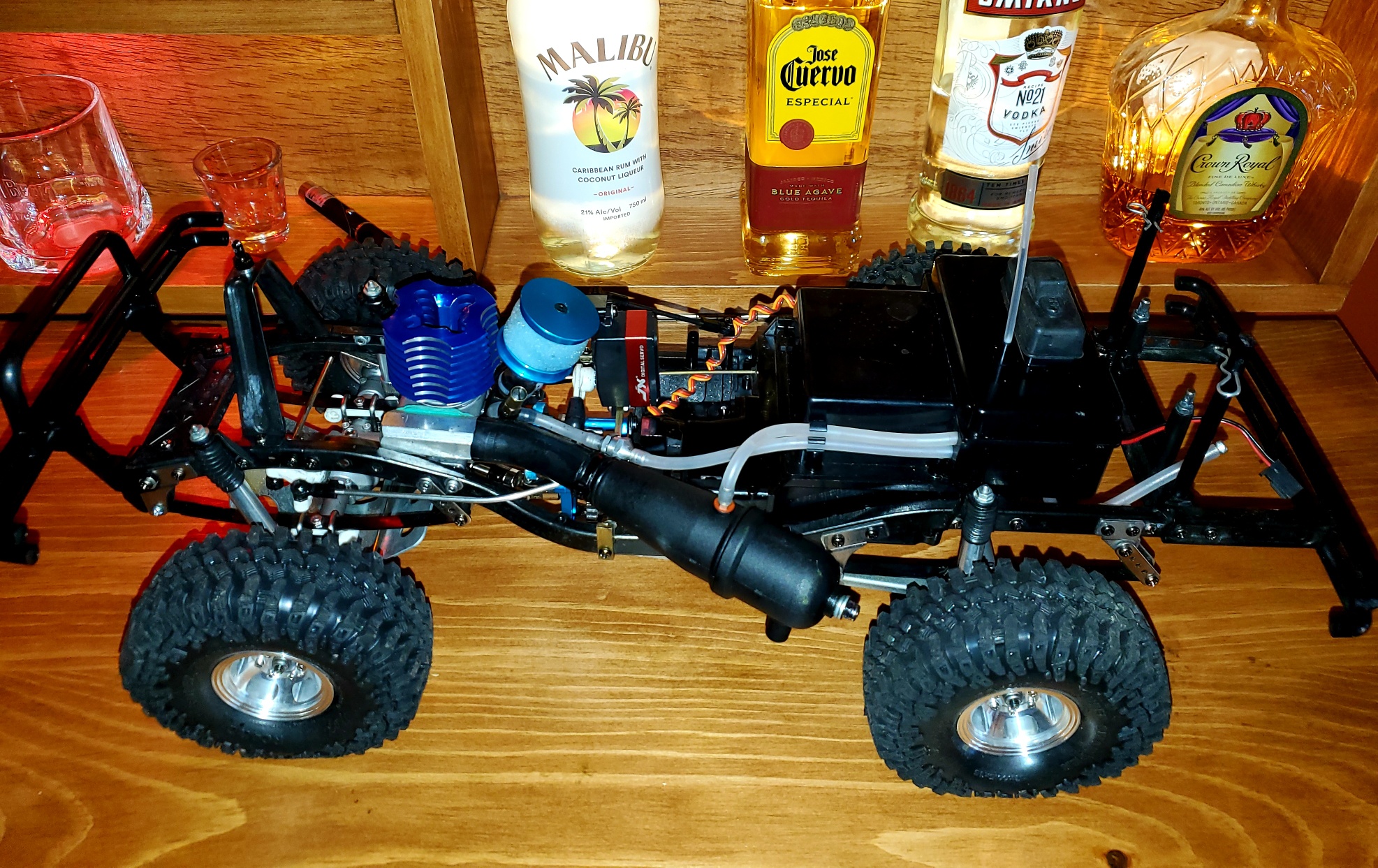

Got it running pretty good....50mph range. WARNING!(Sensitive ears don't watch video)

Derek can get some more details posted but here's a peek.

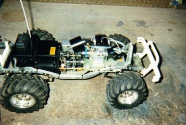

Holy cow! That’s crazy. Looks great and way too fast haha!
I built one back in the day and you wouldn’t believe the amount of people that gave me #### about destroying a rare truck etc.

The pic is a bit blurry and all, it’s a QRC transmission from a Kyosho rig. That gave it two speeds forward and two reverse. Pig slow

Found a body that will fit and looks just like the "Outlaw ll"....(only true F13 purists will know what that is)...problem is its $50 and change and I just don't have the scratch right now....for those people wondering how it got this far....I built the truck for a guy few yrs ago, stock...it is actually a Mountain Rider but Bruiser sounds much better....I haven't heard from him and got bored this summer and cut into it....hope he ain't madTHEYTOOKMYTHUMB wrote: ↑Sun Sep 19, 2021 9:38 pm Hmmm, that's a funny lookin' Outlaw II. I hear lots of chatter, but no action...![]()

Made some changes, converted tranny to single speed, went from 16t to 14t clutchbell, added a 3rd servo for brakes, redid the exhaust setup, just ran the dog piss out of it....43mph on 10% nitro with 18% oil....tried 50% went no faster, runs perfect....just need a 1980 Chevy body to paint like "Outlaw ll" from Friday the 13th Part 2.
