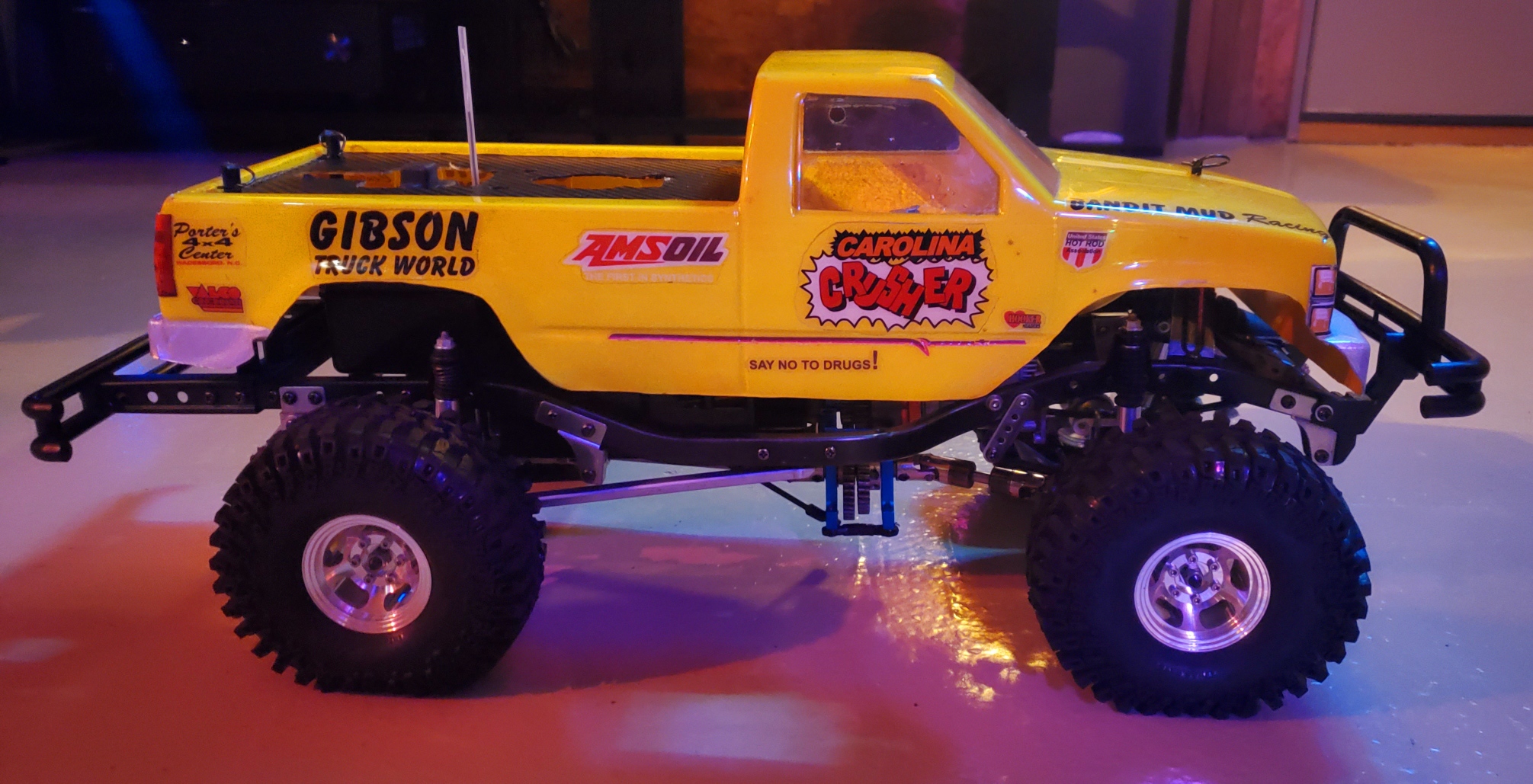

Got it running pretty good....50mph range. WARNING!(Sensitive ears don't watch video)

Holy cow! That’s crazy. Looks great and way too fast haha!

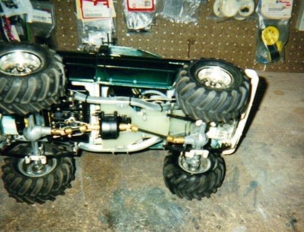

I built one back in the day and you wouldn’t believe the amount of people that gave me #### about destroying a rare truck etc.

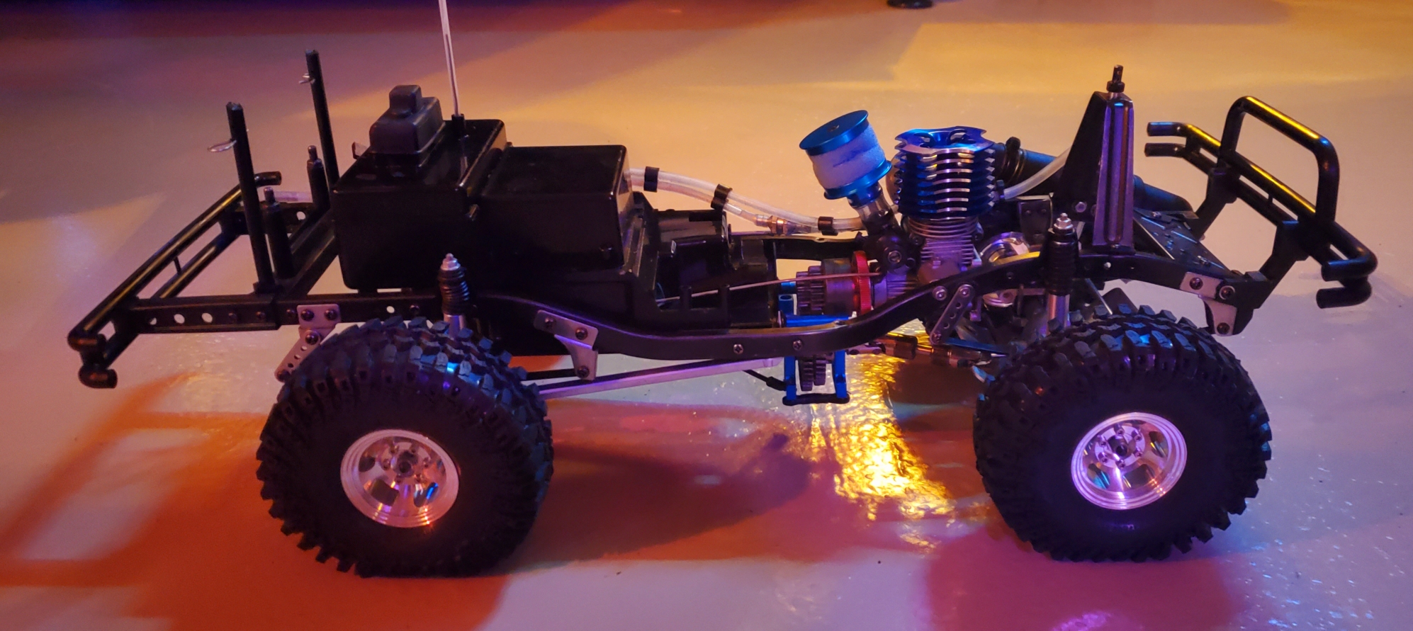

Jeff, that's awsome! ....especially with the 3 speed still there...love the fiberglass plates for mounting u made....way better than stock....no offense to purist

Thanks Doug!.... it runs strong.... big power but hard to slow down at the moment.... working on brakes but might go with a chute.... it just keeps rolling forever.

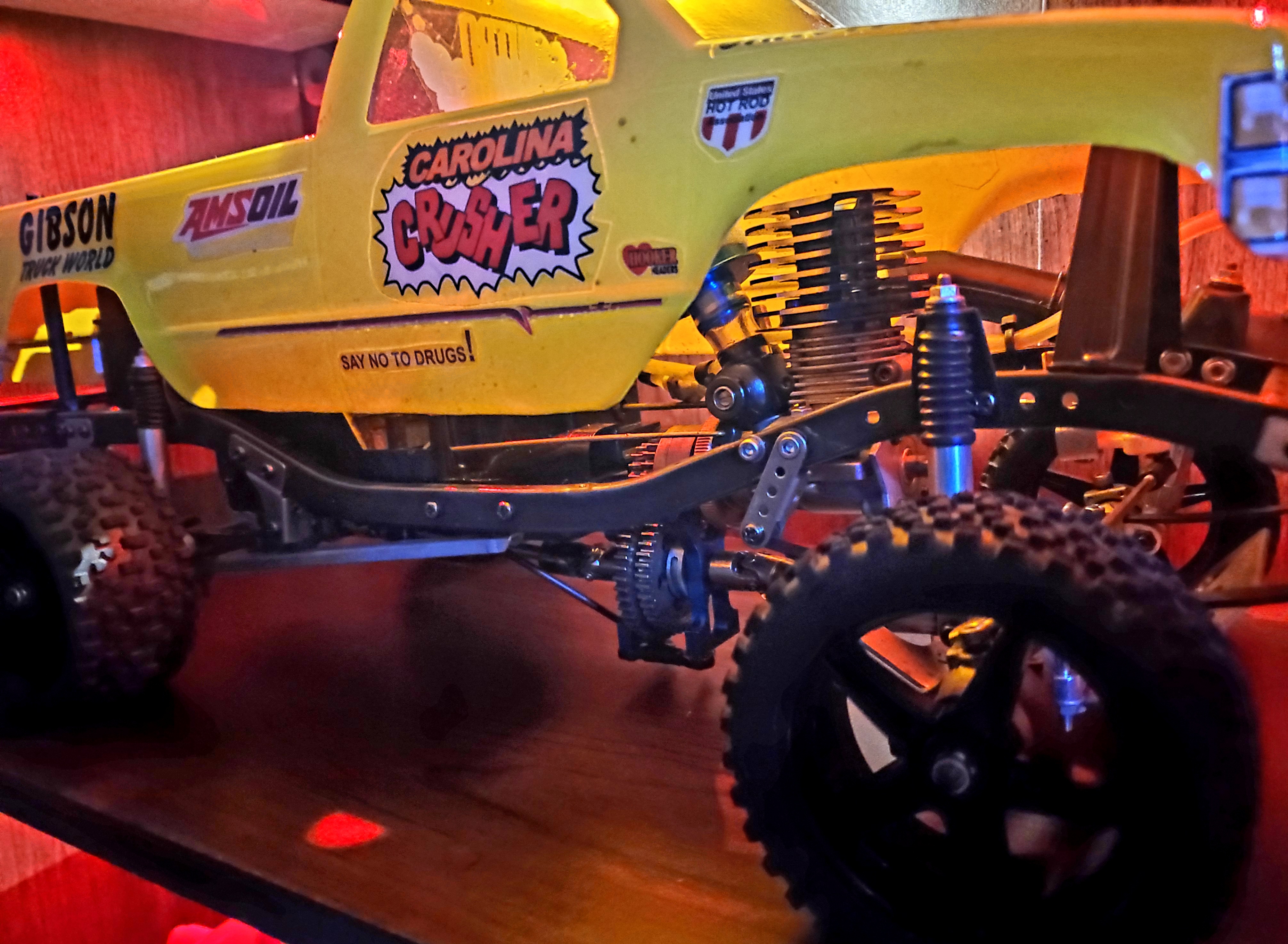

coxbros1 wrote: Sun Sep 19, 2021 8:04 pm Jeff, that's awsome! ....especially with the 3 speed still there...love the fiberglass plates for mounting u made....way better than stock....no offense to purist
The pic is a bit blurry and all, it’s a QRC transmission from a Kyosho rig. That gave it two speeds forward and two reverse. Pig slow

Made some changes, converted tranny to single speed, went from 16t to 14t clutchbell, added a 3rd servo for brakes, redid the exhaust setup, just ran the dog piss out of it....43mph on 10% nitro with 18% oil....tried 50% went no faster, runs perfect....just need a 1980 Chevy body to paint like "Outlaw ll" from Friday the 13th Part 2.
