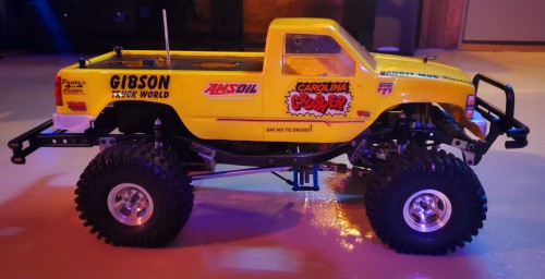

Got it running pretty good....50mph range. WARNING!(Sensitive ears don't watch video)
Dude laughing in Video is "theytookmythumb"
https://youtu.be/x3QT6pKu3ls

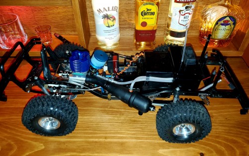

Derek can get some more details posted but here's a peek.

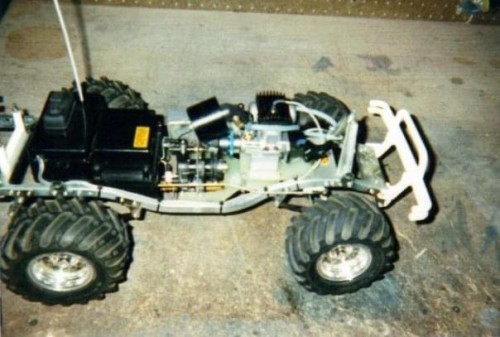

Holy cow! That’s crazy. Looks great and way too fast haha!
I built one back in the day and you wouldn’t believe the amount of people that gave me #### about destroying a rare truck etc.

Jeff, that's awsome! ....especially with the 3 speed still there...love the fiberglass plates for mounting u made....way better than stock....no offense to purist

coxbros1 wrote: Sun Sep 19, 2021 8:04 pm Jeff, that's awsome! ....especially with the 3 speed still there...love the fiberglass plates for mounting u made....way better than stock....no offense to purist
The pic is a bit blurry and all, it’s a QRC transmission from a Kyosho rig. That gave it two speeds forward and two reverse. Pig slow
Big torque tho!

Made some changes, converted tranny to single speed, went from 16t to 14t clutchbell, added a 3rd servo for brakes, redid the exhaust setup, just ran the dog piss out of it....43mph on 10% nitro with 18% oil....tried 50% went no faster, runs perfect....just need a 1980 Chevy body to paint like "Outlaw ll" from Friday the 13th Part 2.
