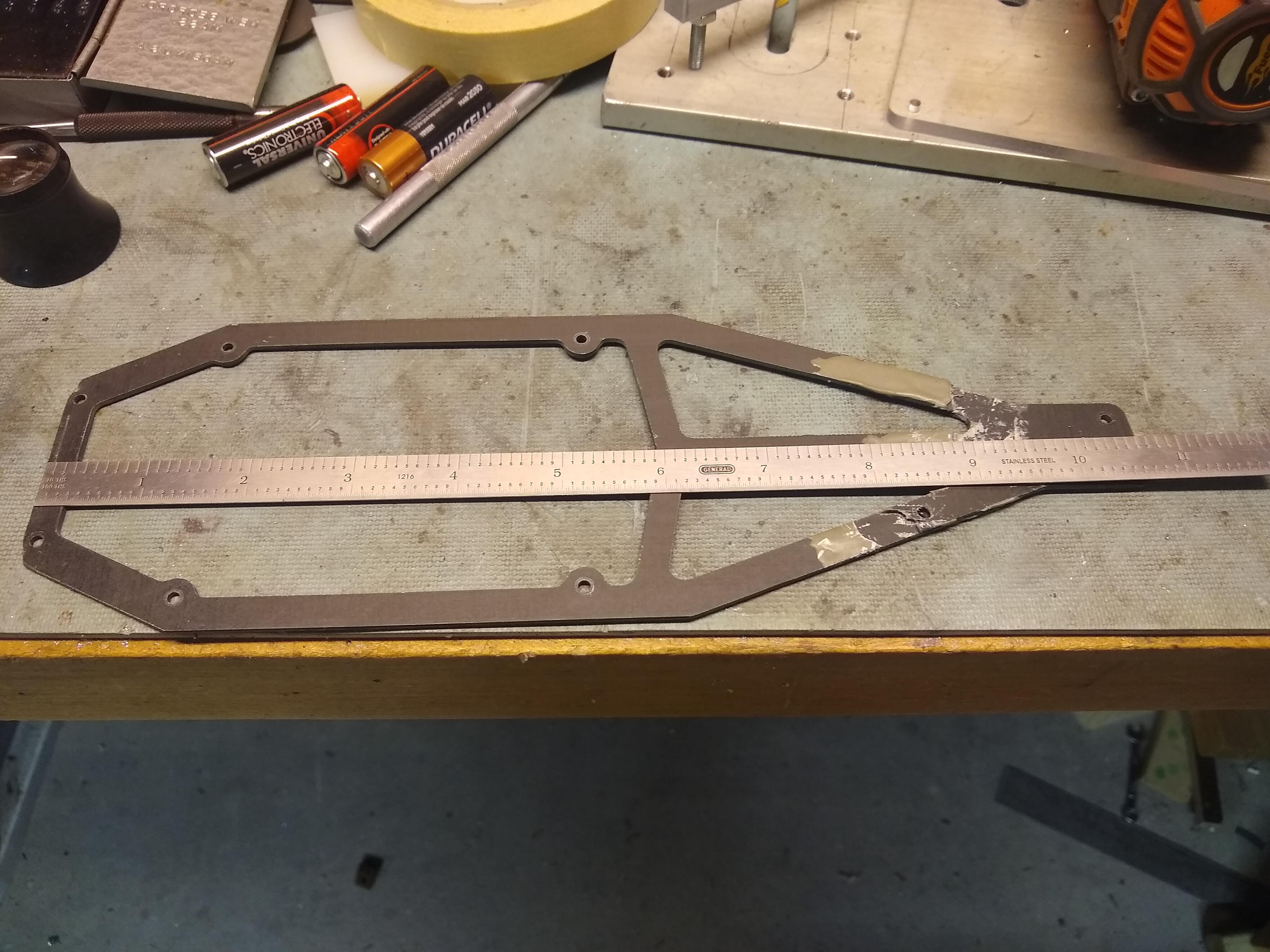

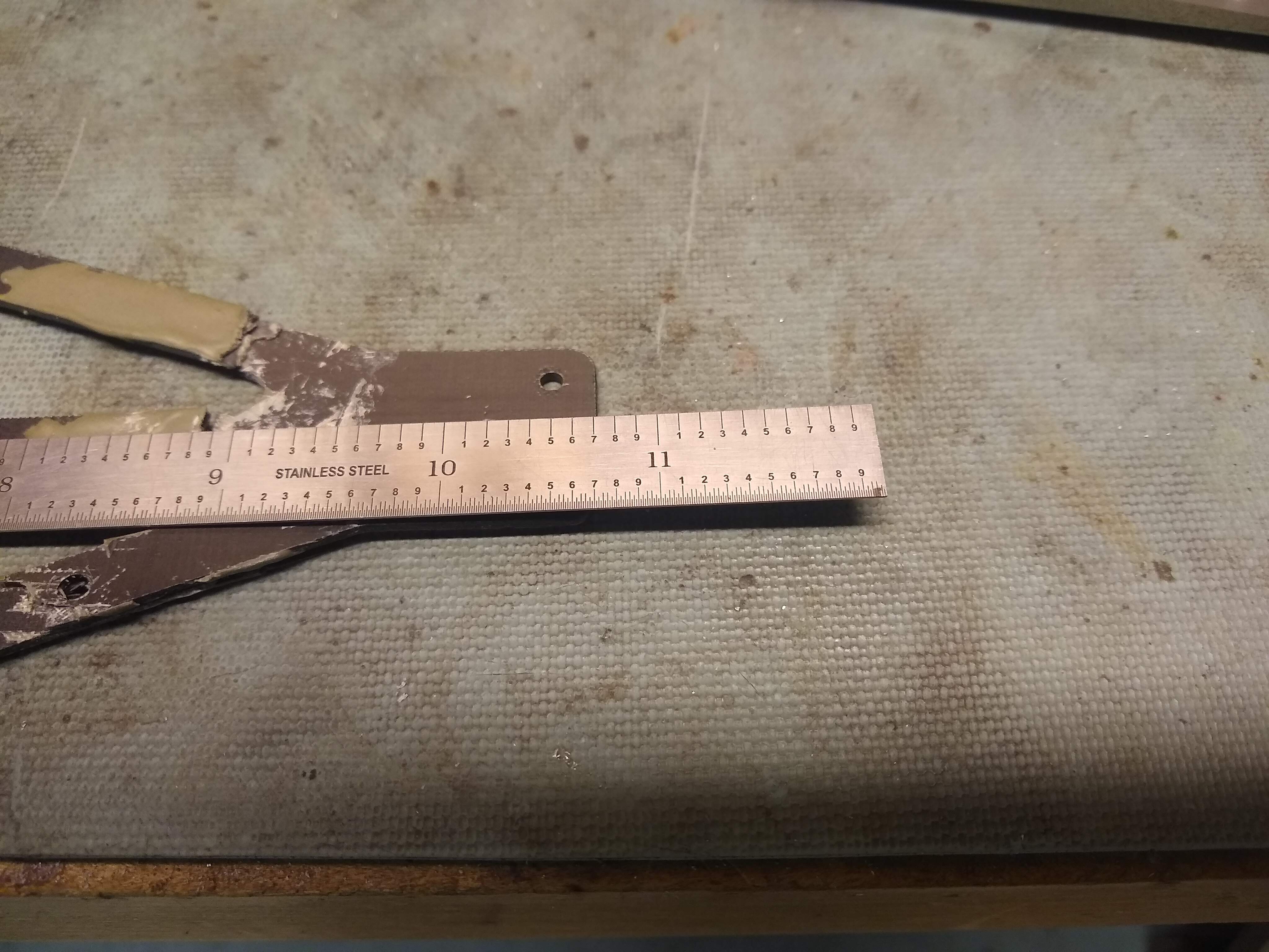

I have a broken short top deck if it would help as a template. Actually, I don't really know then what length the chassis is. Give me a dimension on the overall length or something to compare.

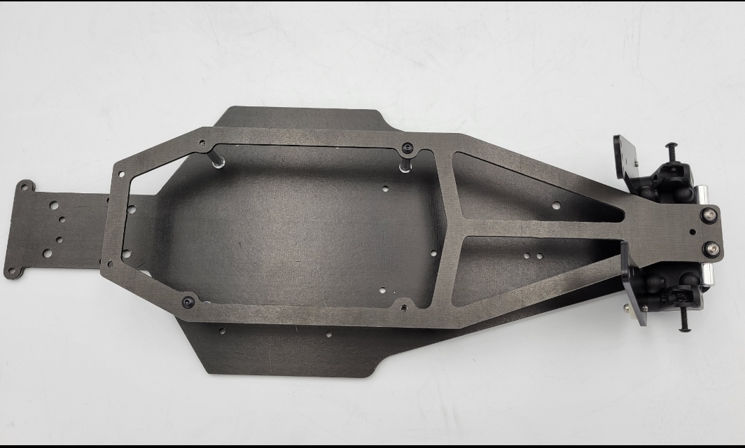

Jwscab - My top plate is the same as yours. Same length. However there is another version that is shorter in the front to fit my bottom chassis.
The picture below (isn't mine, its from a recent ebay listing) shows the short lower chassis (like I have) and a short upper deck (unlike mine). Notice the angle of the front triangles is different due to the shorter length.
