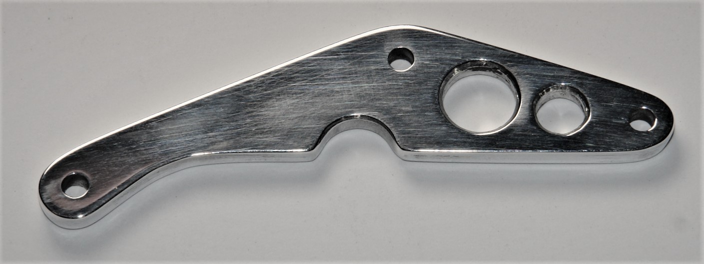

Well it's pretty well trimmed.
Sanded 320, 400, 800, 1000. 1500 and 3000.
A quick buff on the wheel and ...
From 6-12" inches away it looked like a mirror finish.
Back to wet sanding.
I can never really tell the final finish unless I polish the piece then either take a pic or look under my lighted magnifying lens.
Chuck

Looks decent Chuck, but it looks like there are some earlier heavier sanding marks in there. Maybe skipping 600 grit and going from 400 to 800 grit might've caused that, or the scoring was in the original aluminum and not completely smoothed down with the 320 or 400 grit? I think those early grits can be the most important to get a nice consistent hazy surface before proceeding to the next finer grit.

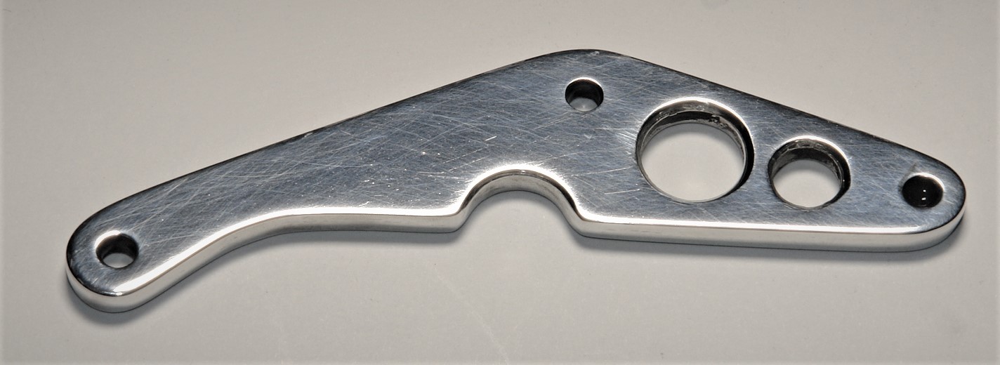

Two more attempts...
The second polishing is virtually flawless to the eye. Even the previous pic looked extremely good.
Things I must keep in mind, aluminum is one of the most reflective metals, I am exaggerating the ever so slight imperfection with a bright led light , the image on my monitor is about 10X and perfection is not an option.
So, I'm done polishing. From now to anodizing it will only a touch well worn soft cotton. A paper towel will scratch the finish, ask me how I know...
I achieved this level starting with the piece in the previous post.
Wet sanded with 1000 grit then wet sanded with 3000 grit (ran out of 1500).
Took an old soft T-shirt and laid out a 10 X 10 piece on a counter top. Added a liberal amount of Turtle Wax rubbing compound to the T-shirt piece locking it down to the countertop and proceeded to polish one side then the other.
Then on to a freshly cleaned and "loaded" cotton polishing wheel. Whew!

That would look great in anyone's books, Chuck...the lengths we go to to polish these parts is insane. All that elbow grease to make a couple-inches piece of aluminum look great...most people would think it's silly, but anyone who's ever done aluminum polishing understands the effort and appreciates the results. Polished aluminum has a classy look that you just don't get with raw or satin-finish aluminum or chrome.

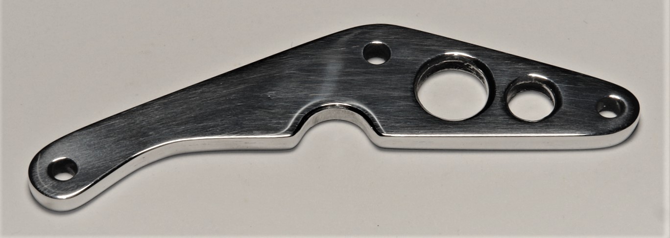

radioactivity wrote: ↑Thu Jul 01, 2021 11:00 pm I didn't really like the rear plate in black glass.
Going to try and trim up some aluminum to replace it.
Just a rough cut right now, plenty of sanding/polishing ahead.
Then try to match the anodizing.
Chuck
Your metal working skills are impressive Chuck. You were wise to leave yourself a handle for this small part. I was building a gauge cluster for the dash in my Bronco interior (styrene) but after all the parts were cut-out, I had no way to handle them for assembly and I got very frustrated. It's been sitting in a box for months now and I'm reluctant to go back to it.

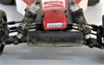

Just a quick update...

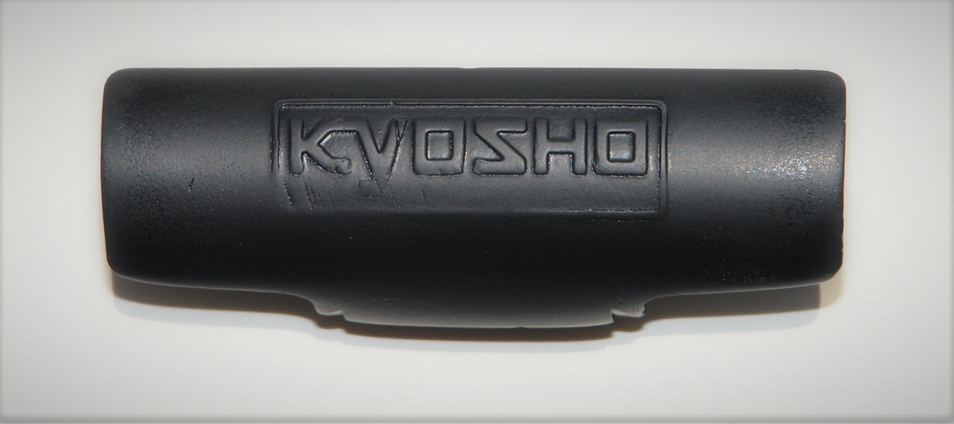

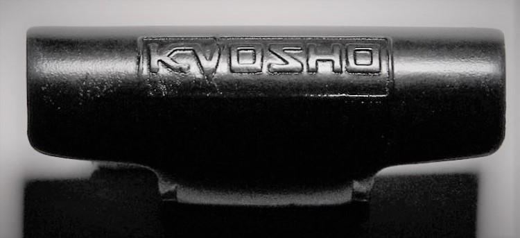

Thought I'd try to at least temporarily salvage the front bumper as a place keeper till I get my hands on a reasonably priced new bumper.
Still needs work but looking wayyyy better than when I got it.
Probably too glossy...
Or satin/flat finish

The salvaged bumper looks great Chuck.
New ones rarely appear on ebay and they're always pricey. I seem to recall the last one I saw listed was maybe $35 or more. Anyway, if I see one listed, I'll send you a PM.
This project deserves a new bumper - no matter the cost. This car is too nice for anything less than a pristine new bumper but the one you've restored should do just fine until a new one arrives. Thanks for the update.

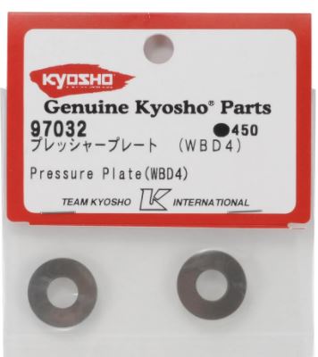

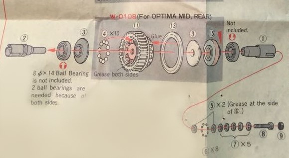

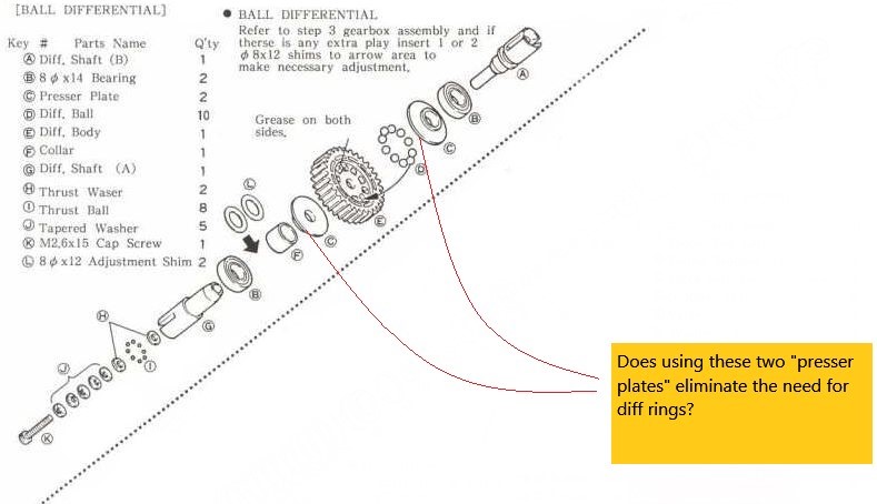

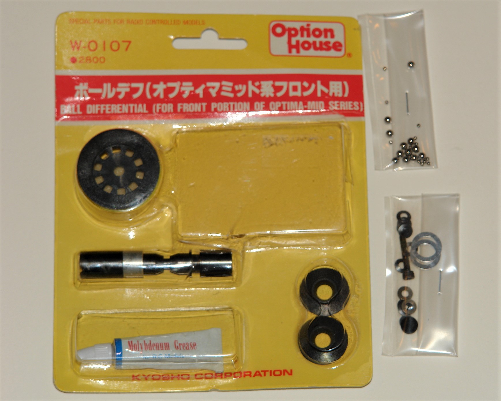

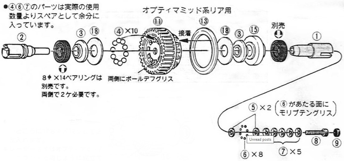

Need some help with a couple questions, and I know there are far more experienced Kyosho owners than me....
1st question
Front ball diff with no instructions
Not the easiest instructions to find in English.
I think maybe I've got an ??early?? front ball diff.
Does it look like I may have all the parts?
What has me confused is the lack of diff rings. I don't know if the two darker metal "presser plates" on the card in the lower right of the first pic eliminate the rings?
Chuck
1st question
Chuck

The 2nd question...
It seems as if there were 2 different of methods to "clamp" the diff balls in the diff.
One method using a pressure plate and another with diff rings.
Are any diff rings compatible with the conventional (later?) style diffs?
Inside diameter slightly over 8mm, outside diameter 18.3mm.
Chuck
Chuck

Re: Turbo Optima mid SE
Keith
I measured the diff balls at slightly more than 3mm, so I am guessing 3mm is the magic number.
The thrust bearing balls measure right at 1.5mm.
The diff rings, which are what I am curious about, may be the same/similar to ZX5/ZX6 diff rings.
I sent off a couple messages to sellers asking about inner and outer diameters on Kyosho WBD4 Lazer ZX5ZX6 rings.
The image on Kyosho's site makes me think they may be close.
On Kyosho's site I took the size of the ring on my screen and compared it to the text on the header card. Then I compared that with the same style header card I have.
Rough approximation but it seems very close.
If no answer from sellers I will probably just go ahead and order some unless anyone else here has an answer.
My NIP rings measure an inside diameter slightly over 8mm, outside diameter 18.3mm.
Chuck
Chuck
