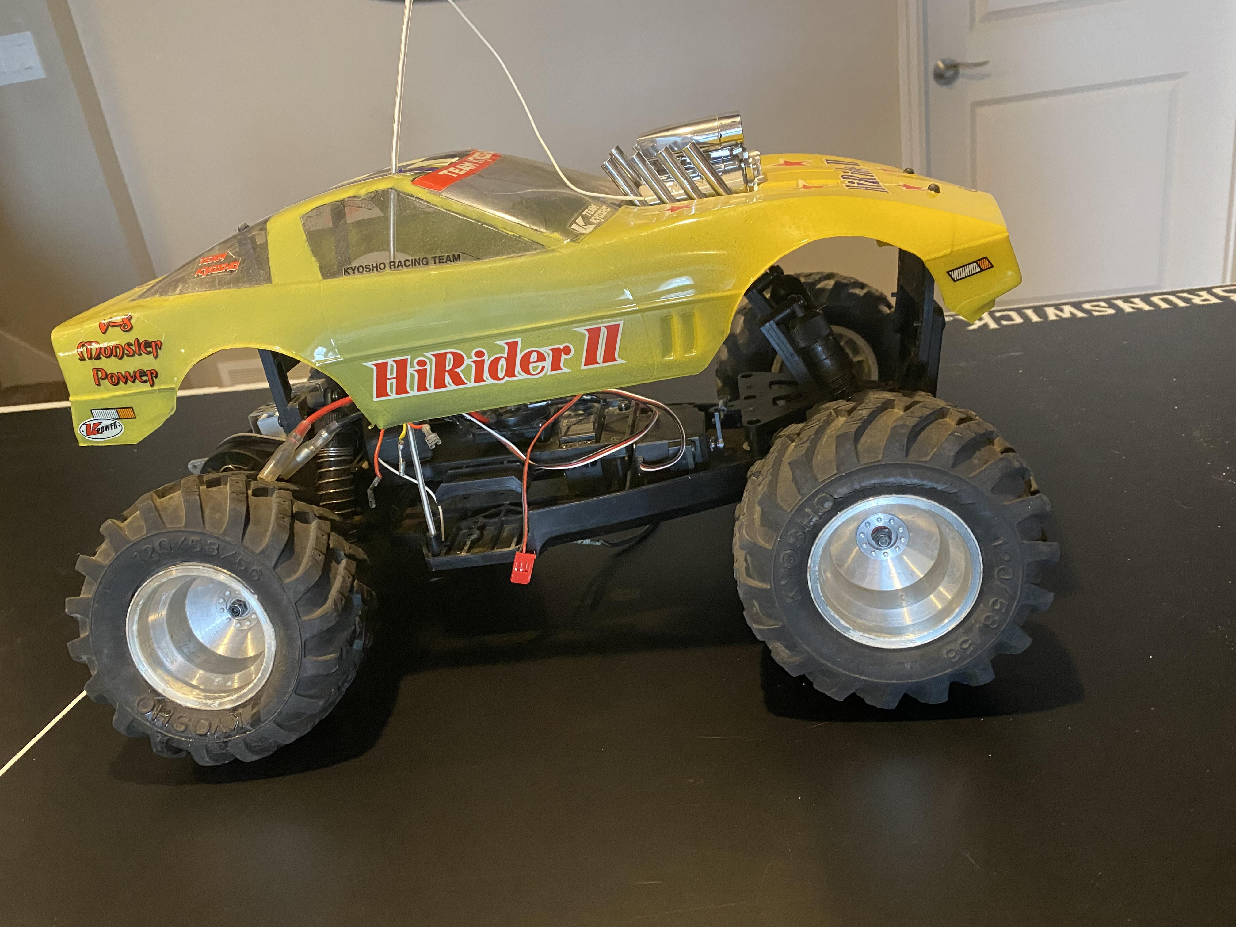

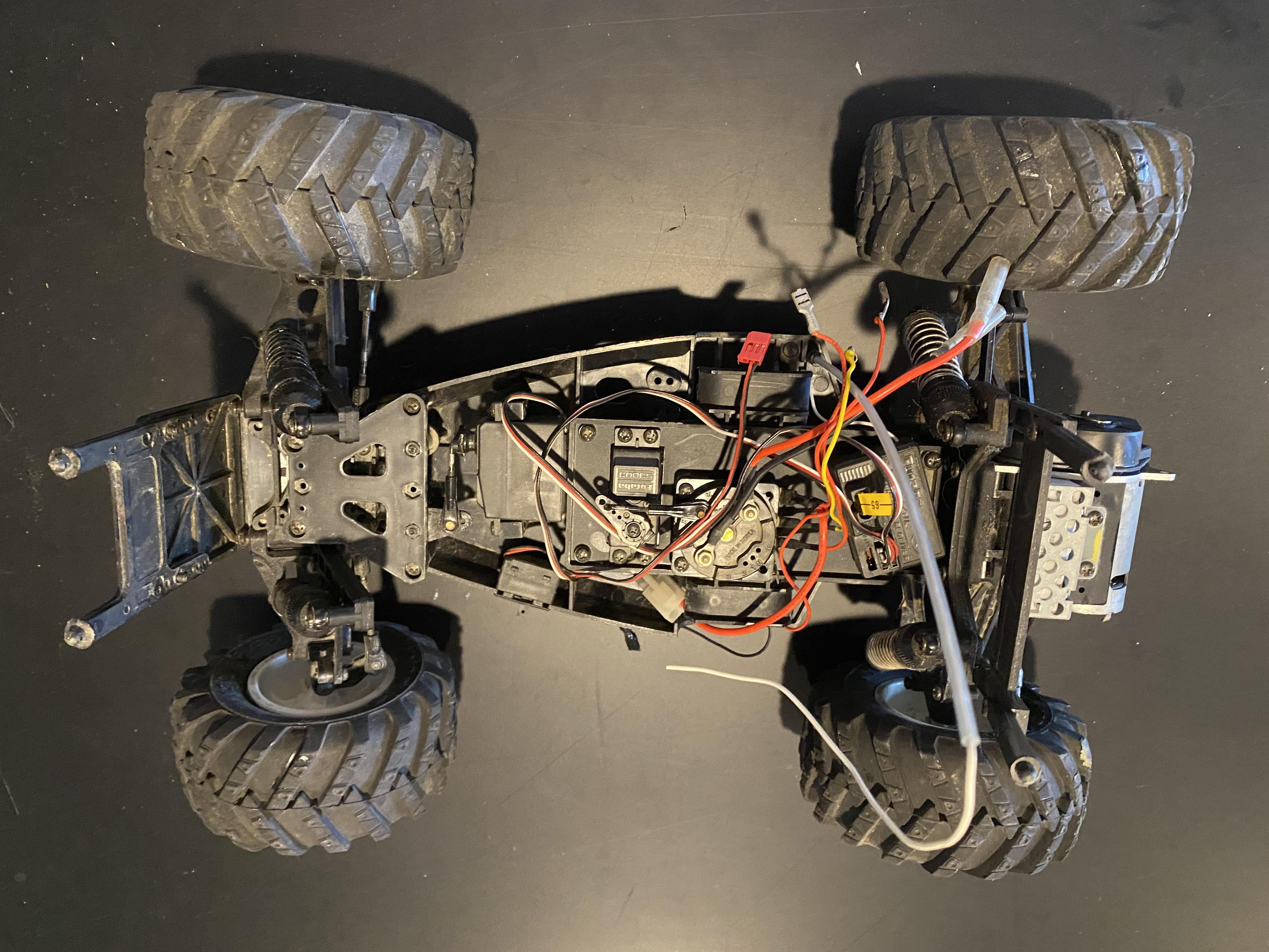

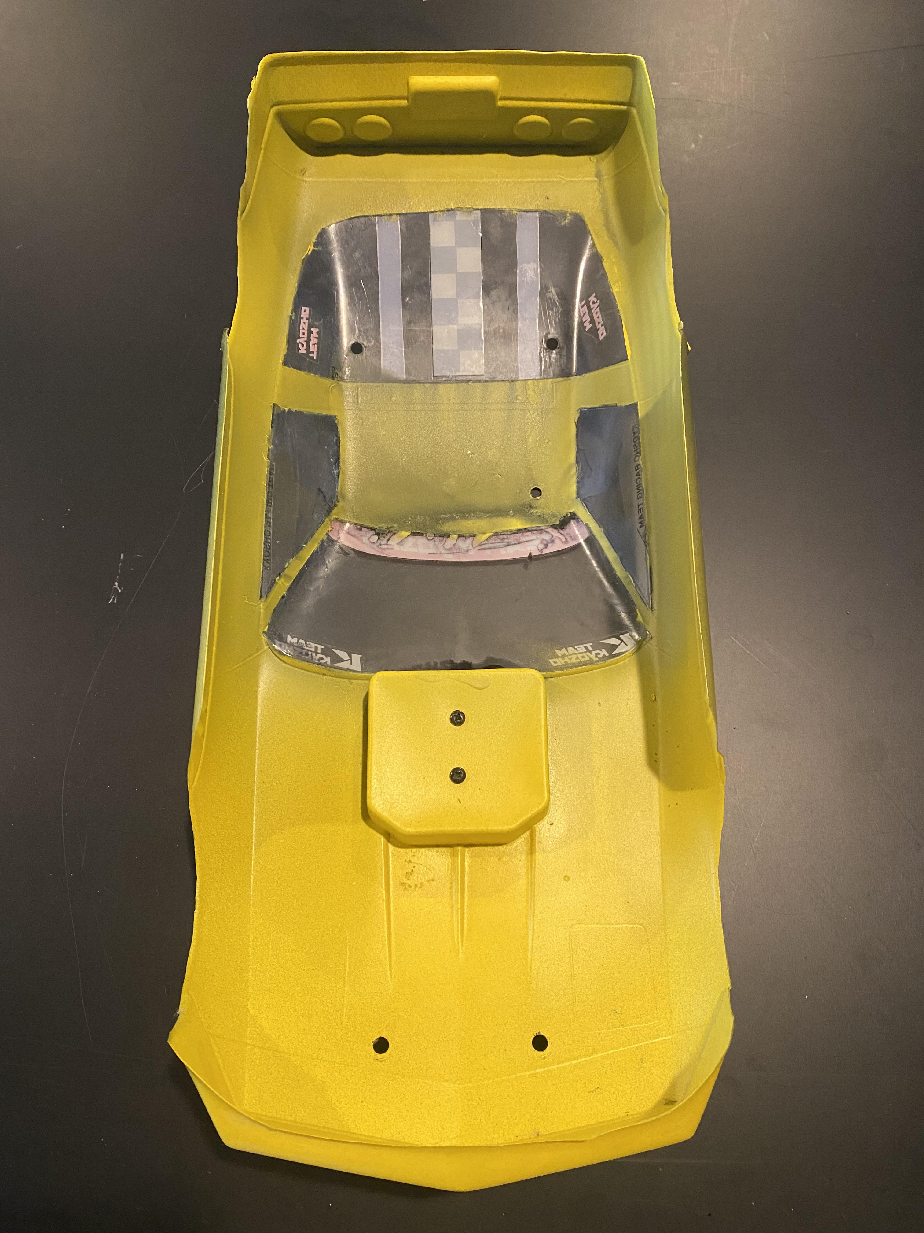

Hey all,
I picked up a High Rider II Corvette that came in a box with miscellaneous parts for a ridiculously good price. Going through, I think it is complete. I was going to use it as runner for my kids but it in in really good shape. Even the body is good with very minor scratches, some trimming that needs to be cleaned up and a half done paint job. The only real issue is the tires have dry rotted. Getting to the question, I have never tried to restore a body. I have read about Tamiya Poly Cleaner, Dot 4, Nitro and all but was hoping to see what people think that have removed paint before. What has worked best, causes the least damage, etc. Soak or scrub with cotton pads. Any feedback appreciated.

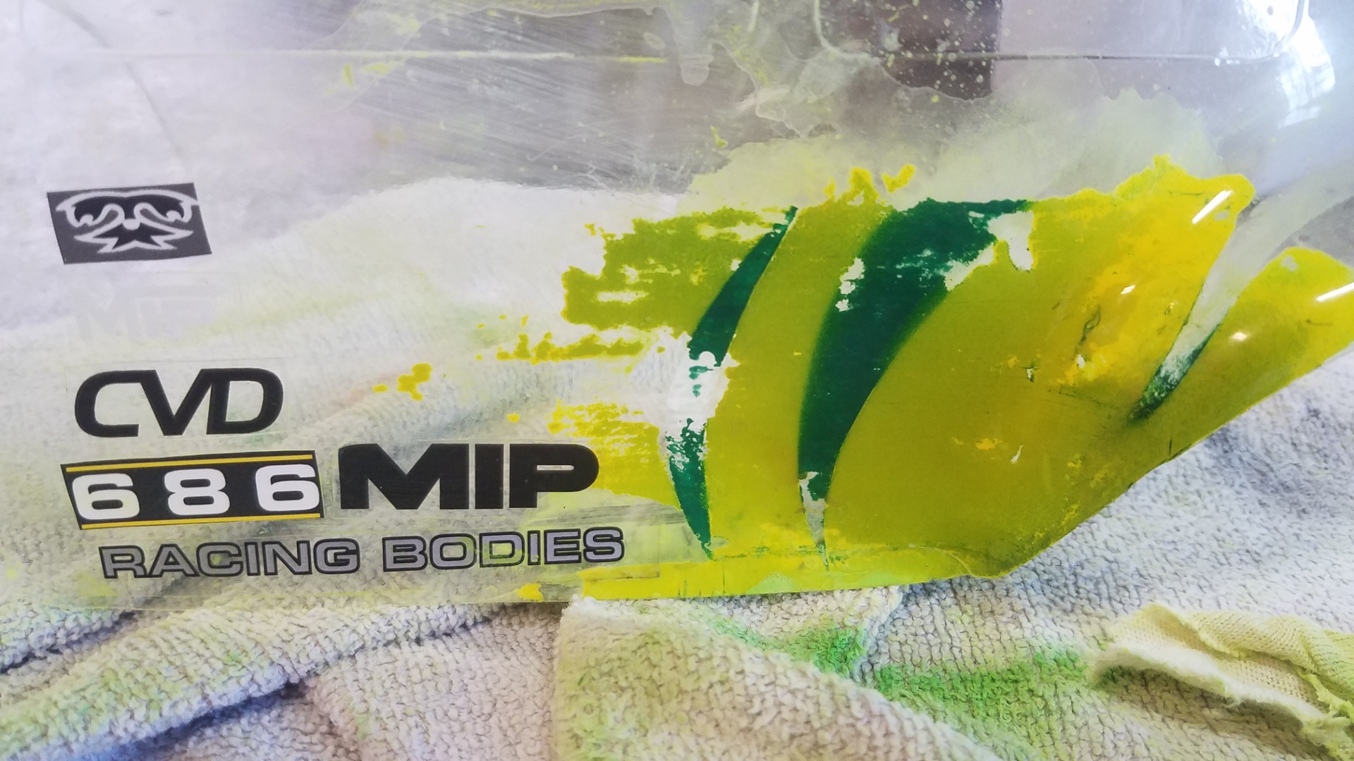

The fog *will* be visible after repainting, but won't look nearly as bad as it does on the clear paint-removed Lexan. It will dull the glossiness of the new paint. Repainting a fogged Lexan body doesn't make the fog go away, unfortunately.
Here's a body that I stripped the paint from with DOT 4 brake fluid, then repainted. The areas where the paint was more stubborn to remove from, such as the roof scoop and the 2 rear roof body pillars, is where the fogged Lexan clearly shows regardless of the paint. Just letting people know that a paint-stripped, fogged body will not be suddenly perfect after painting, and not a shelf-queen candidate. If that's what you're after, buy a repro body.
