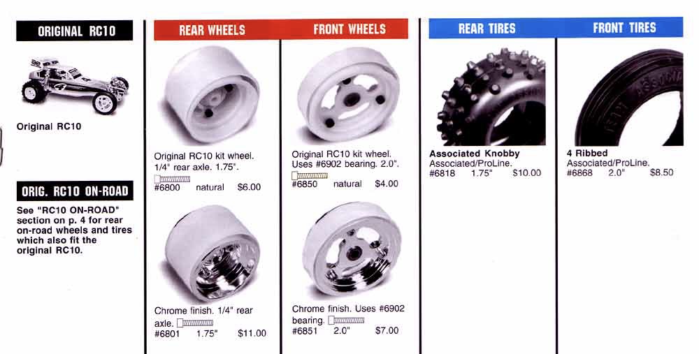

That wheel is listed on page 56 of the original associated manual as a direct fit for the RC10 wheelsdallarax19 wrote: ↑Thu Feb 03, 2022 5:20 pm Thanks everyone for the comments. This leads to that and I am seeing some options based on the leads yall have provided.
Not proven but these may be options as well.
there is a neat resource here that show diameter and width of tamiya tires.
It looks like rough rider tires may work as well
