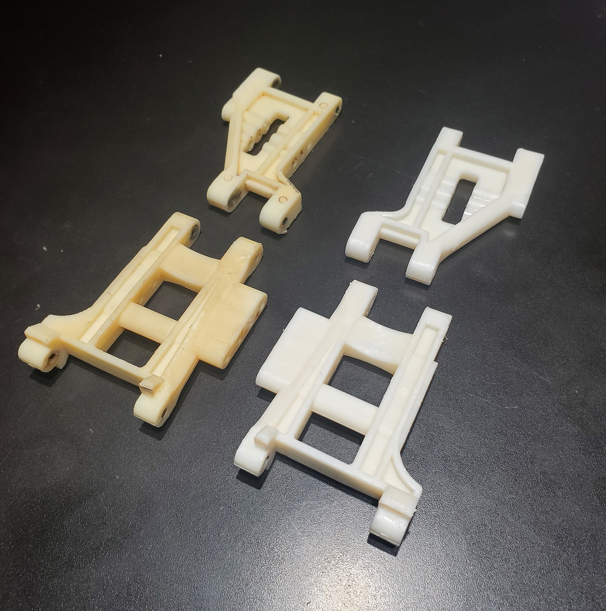

Definitely would also like to know what best methods to be used for whitening up old RPM parts too, as some claimed that this peroxide method may damage the parts?? :roll: suggestions anyone??
The peroxide is proven to work equally well with UV light in a box line up in foil to equalise the lighting around. Also wash clean all parts you are going to work with will help immensely.
In case some of you may think pure peroxide may be too strong and too liquidly to handle, I have another suggestion and that is using a hair dye product namely SALON CARE 40, do a search on google and you will see this comes in a form of pasty solution, easier for application which then you may apply onto the parts with cling film for wrapping up and it sticks well onto the surface, UV it in a box or outside if where u lived has constant sun ( I personally prefer the lighting method as what you really need is UV for the reaction minus the heat created from the sun since parts are plastic and best not expose to too much heat ). There are other similar brands of the same stuff which some dun have ammonia and will also eliminate the smell too.

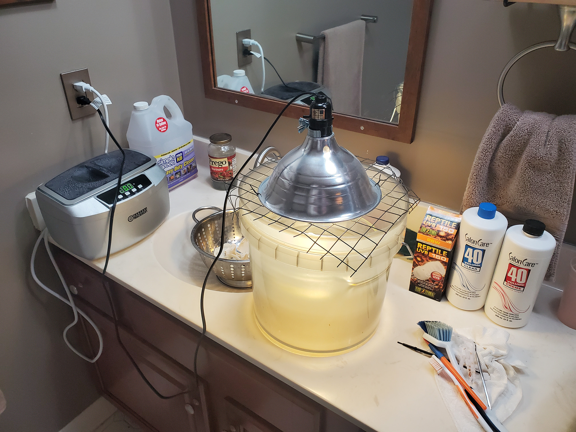

This process has become one of the most satisfying parts of restoring these old vehicles for me! The process of hydrating, cleaning, and whitening is tedious and boring, but the payoff is just so worth it in the long run! :wink:
For medium, I use Salon Care 40 Volume Clear (liquid) or Creme (cream duh). These are available at Sally Beauty or probably whatever your local beauty shop is. For small parts, they end up in a bowl with the liquid, placed in a 3 gallon bucket, and bask under a cheap construction lamp with a [not so cheap] UVB bulb. After experimenting with 3% peroxide and multiple other bulbs, this combo simply works so much better, and I don't have to depend on the sun. For larger objects, covering the part in the "creme" and putting it in a casserole dish under the light works great. I can't find the specs, but I believe the SC 40 is a 12% peroxide solution, and apparently hunters/taxidermies use it to whiten bones, because every time I go to buy some, that is what they think I am buying it for.
The rig:

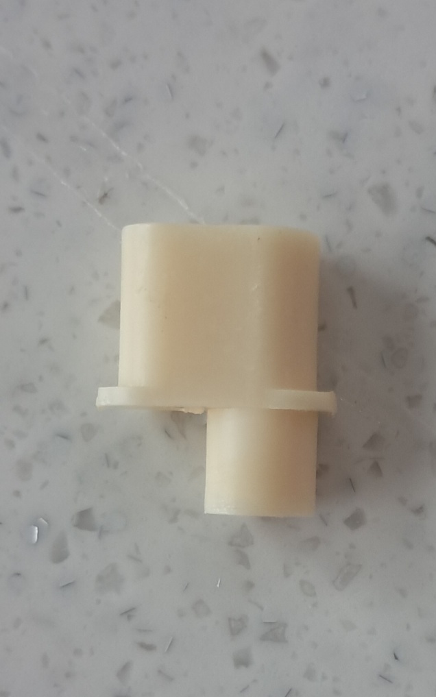

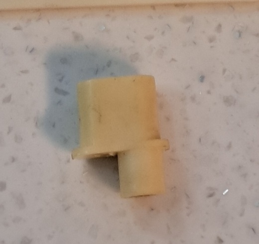

I recently had my yellowed Kyosho Pro-XRT parts (A-arms and clear gear cover) in a glass dish submerged in 3% peroxide set under a UVB light for 4 days. It had zero effect whitening the parts. Quite the bummer :cry:
-Jerry-
Posts: 12214
Has thanked: 1084 times
Been thanked: 3762 times
Re: Anyone tried this? Yellowed parts white
Never seen it do anything on clear parts. The Kyosho “white” nylon parts new were pretty yellow-cream colored from my recollection. If you have a parts tree kicking around take a slice and see what color it is in the middle, I bet it’s less white than the nylon we are used to doing

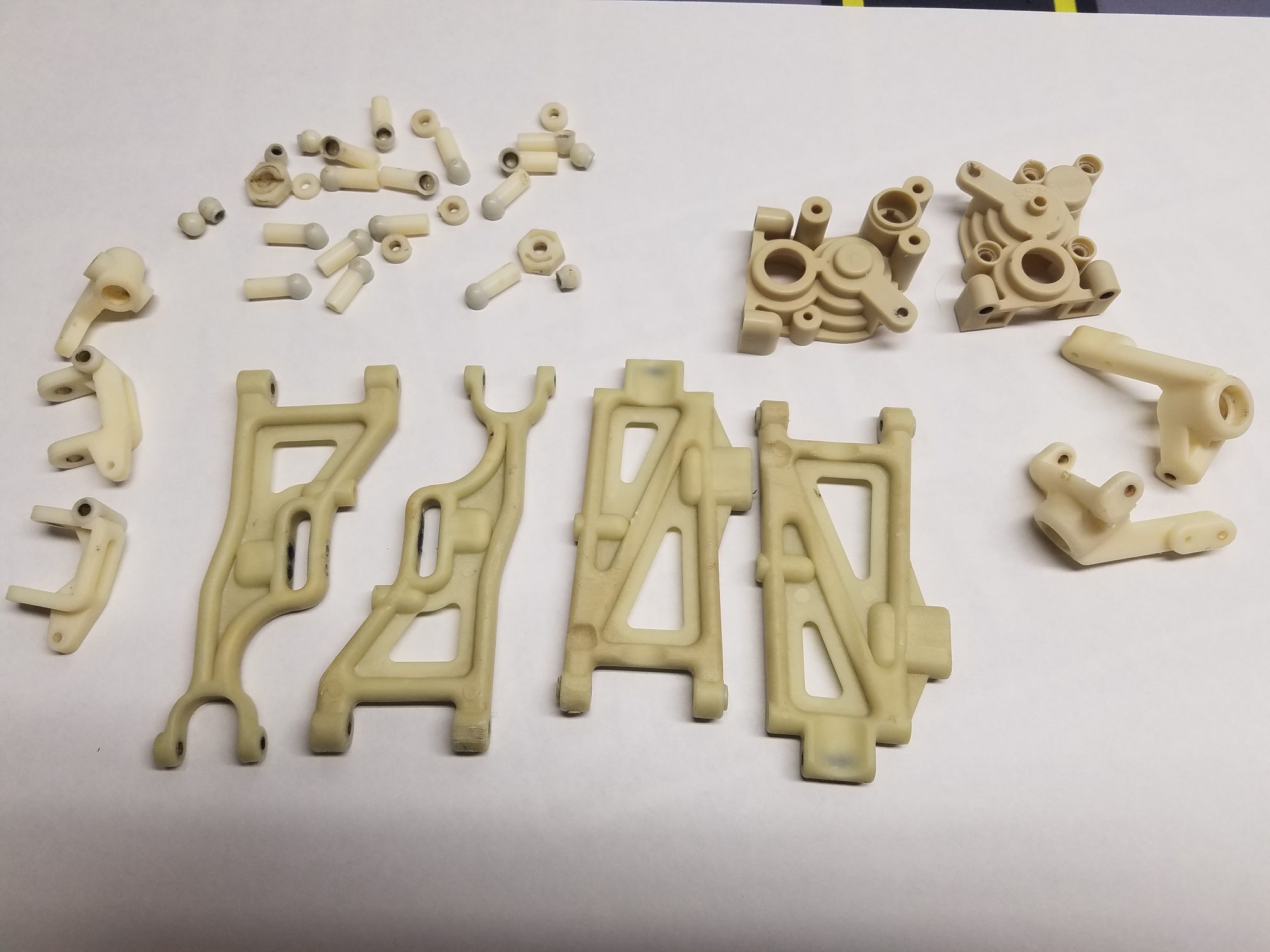

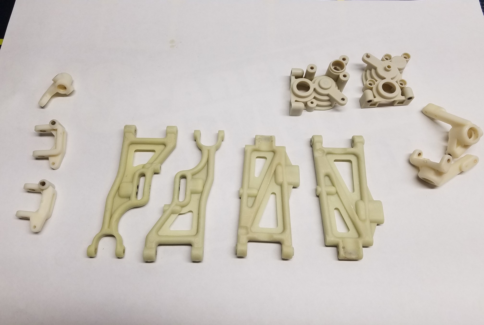

After boiling the nylon A-arms for a few minutes, I put everything in another bath of 3% peroxide and placed it outside since we had a mostly full day of sunshine, didn't time it but roughly 9 hours I'd say. Can now definitely tell it made some bit of difference, boiling the nylon A-arms certainly did the trick to help out. I forgot to add ball cups, spacers and suspension balls to the after photo, but those are noticeably whiter as well.
As far as the clear gear cover, soaking in the peroxide did slightly help to rid of some of the yellowing, but it was still very yellowed and quite the eye sore. So it won't be installed on the truck.
Before
After
-Jerry-
