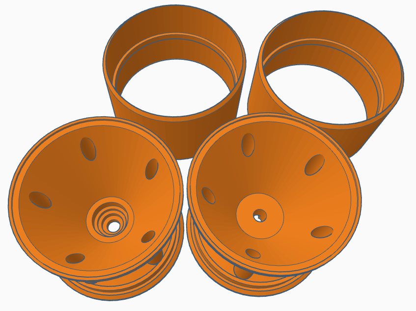

Well, just need to wait for my orange pla to arrive so I can try printing out my walking clock....
They should work fine and be fairly light on support material to print thanks to those deep cones. I am going to hold off uploading them for now as I want first crack at printing them lol.

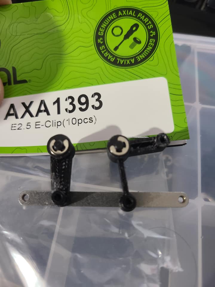

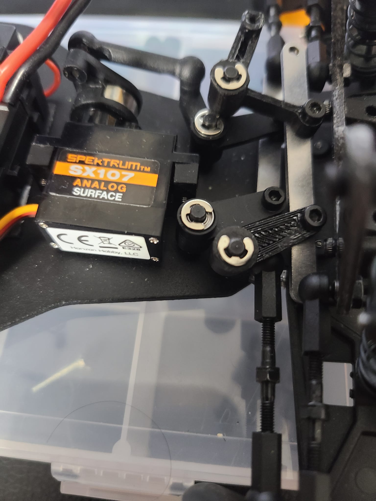

If you build up from parts, the bellcrank posts require 2.5mm e clips which are completely unlisted and not supplied in any mini jrx2 parts bag. I used Axial as they were cheapest.

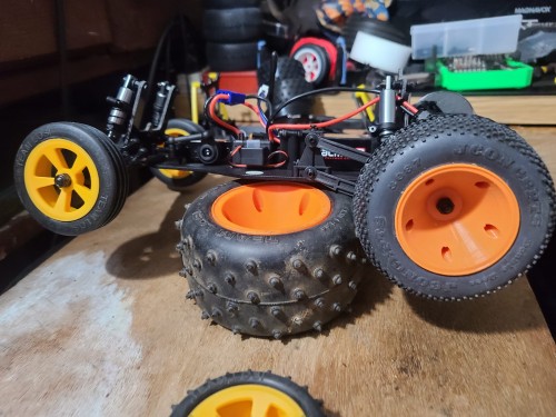

Added rod ends to the spring retainer so you can now convert 5 link shocks to h arms or front use. They use pivot balls from the shock mount parts bag or straight from the 5 links themselves.
Shock Retainer and rod end: https://cults3d.com/en/3d-model/game/losi-mini-jrx2-shock-spring-retainer
and I have been able to print out one Jrxt wheel.. it needs more work... 3 piece wheels ALWAYS need more work grrr.... lol

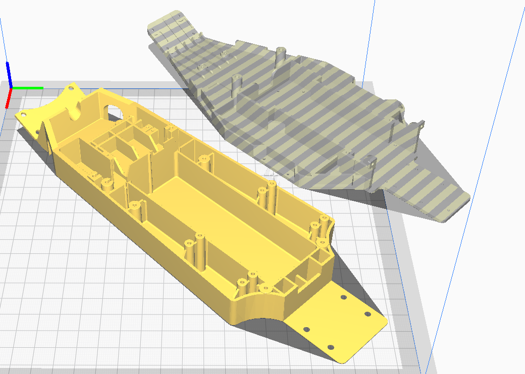

So tempted.. so very very tempted.. was my first performance rc...
Edit and as I was typing this it FINALLY imported into tinkercad... -insert YES YES YES meme here-
