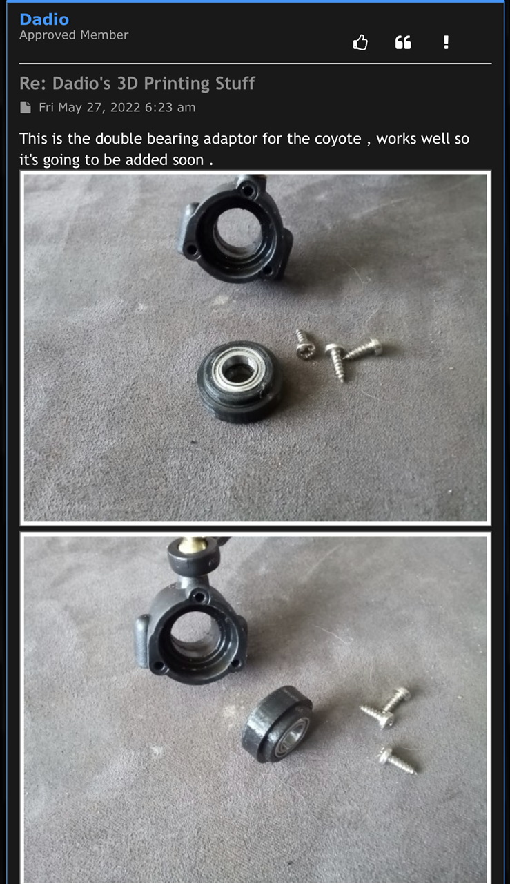

I’m sure you have seen this but if not…
I really like the way he went about this. With a pair of 6x10x2.5mm wide bearings you might have a chance :?:

GoMachV wrote: Thu Oct 13, 2022 9:10 am I’m sure you have seen this but if not…
I can't take credit for the idea , I think even back in the day it was a custom part you could buy . Might be harder for the Zerda than the Coyote as the Coyote had a pair of bronze thrust washers spacing the wheel away from the bearing retainer screws and the space of those thrust washers being removed added just enough room for the double bearing , on the Zerda the drive is transmitted to the wheel by a friction disk and the friction disk is a taper fit on the axle , this negates the need for the thrust washers so there is probably not enough space unless you change the axles , changing the axles could mean you could use modern hex drive hubs so no bad thing in the end but it adds to the cost and complexity .

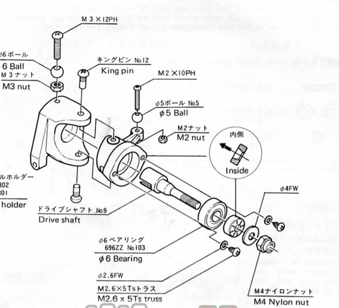

But in the present case, and I did not check the Zerda which is not yet in parts, here is the problem data :
The axle have 5mm for the bearing, and then comes the hub (conic pressure driven). Extend to anything more than 5mm of bearing would require:
- either axixs change
- either find a bearing that goes around the cup and get the carrier done to fit it (cup external diameter is 9, maybe possible, but I'm not sure there would be enough clearance left around for having a solid carrier...
It appears the most reasonable approach is to change the axle for something longer. I'll have to check what is in the Tomahawk kit box for the axles...

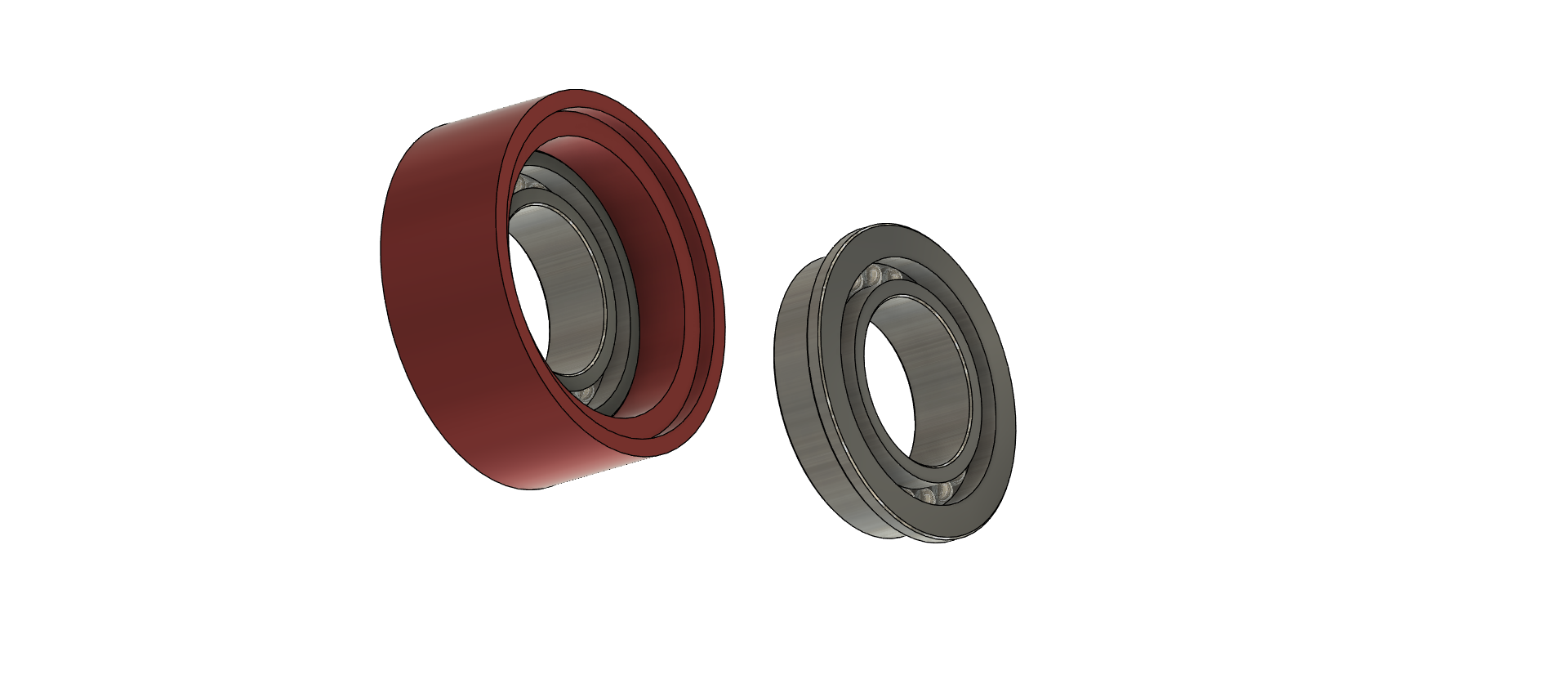

I’m picturing 6x10x2.5 flanged bearings (MF106-ZZ) which would be 2.5mm and the flange is spec’d at .6mm wide and 11.2mm in diameter. That leaves some meat to fit the 5mm wide 13mm diameter hole pretty easily.

GoMachV wrote: Thu Oct 13, 2022 1:05 pm I’m picturing 6x10x2.5 flanged bearings (MF106-ZZ) which would be 2.5mm and the flange is spec’d at .6mm wide and 11.2mm in diameter. That leaves some meat to fit the 5mm wide 13mm diameter hole pretty easily.
That's a way, but i'm actually questionning the interest for the axle guidance : that would not change anything compared to a bearing of the original size (I finally found some)... And looking at it, the carrier may have more play impacting the guidance than the axle in the ball bearing itself... Not sure it is worth the effort, except to reduce the cost of the assembly (which could be interesting, that being said, considering four 5x13x5 ball bearings are about 22 € without the shipment - and I have some MF106-ZZ sitting somewhere)

The manual you displayed here is likely the Zerda one... That being said, it's right, I typed it wrong (maybe I'm bit more tired than what I thought :-/ )... it's 6x15x5.. Damn! Luckily I did not ordered any bearings yet!
I did not thought about the what you mention, and effectively, it would make sense. Only need to find the proper bearings...

for the wheel axis, using the proposed method and flanged bearings en 6x10x2.5,
That will do it, and i'm likely to have just the bearing needed for this in one of my boxes :-)
