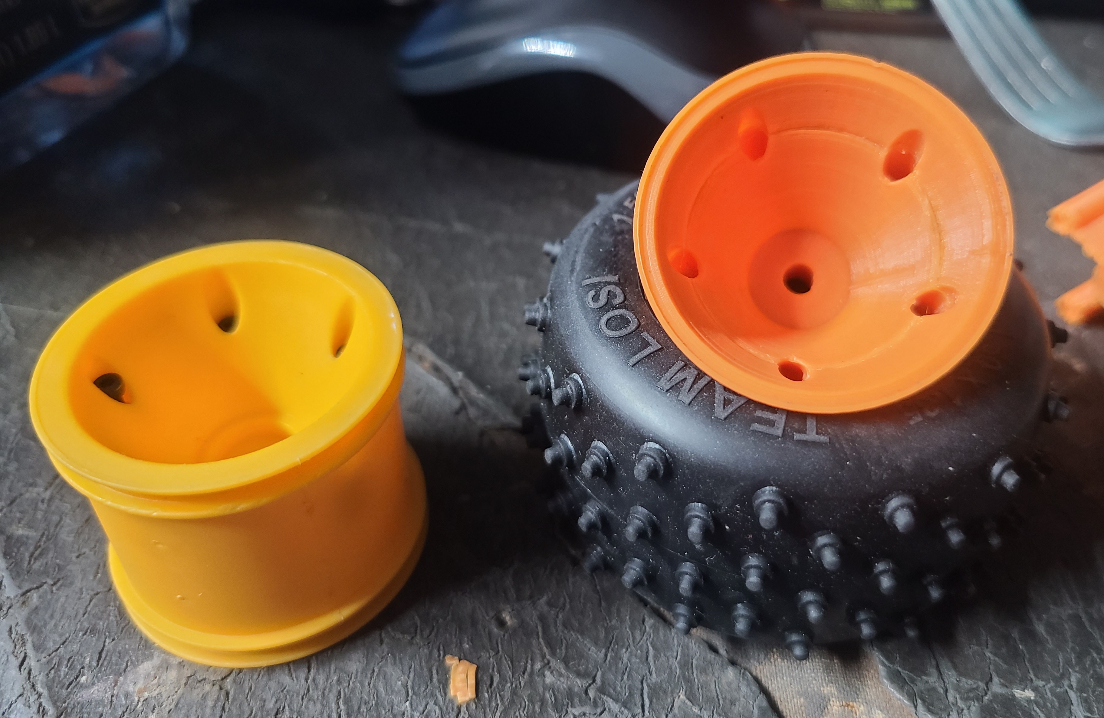

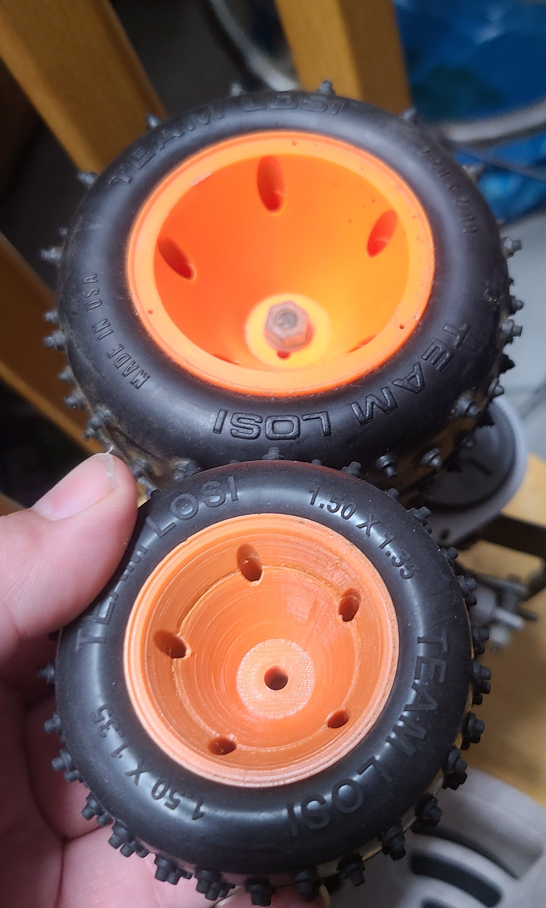

I just fought my printer to print an outer rear and.. well.. the reduction in scale from 1.6 to mini jrxt was not kind on it lol. Making alterations to the wheel to thicken it up where it cant be seen and reprinting.
Here is what the mods are looking like, all done inside the wheel and not outside. The thinner one is a direct replica of the stock.

Printer is still being a pain, apparently it partially clogged part way through the test print. But I am much happier with this shape.

Bonus is it's way closer to the right color! What filament are you using?

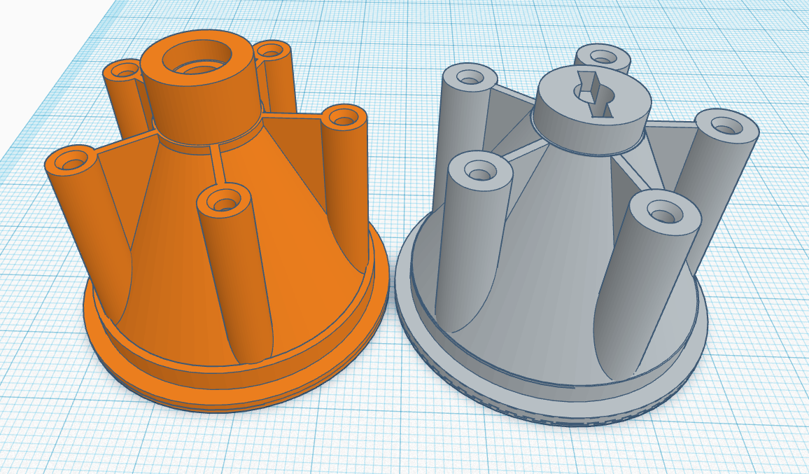

Well... Hmm.
I went to try to adjust things to make the steering bellcranks clear everything better, I figured the Mini Jrx2 steering posts were too short knowing the molded posts were taller.
So I measured everything and did up some models. The Mini Jrx2 posts are technically taller even than the molded chassis posts when scaled correctly. I was thinking of making a spacer to raise them the difference of the graphite and the molded posts... well that is not going to work.
These are scaled to the mini jrx2 posts, The orange one is the graphite chassis post, the blue one is a molded post, and the yellow one is a rough model of the actual Mini post...
looks like I am going to have to use shims on the ball stud and maybe file the threaded portion shorter to keep it from rubbing, a simple spacer under the steering post is not going to cut it when it is overall taller than a molded post to begin with lol

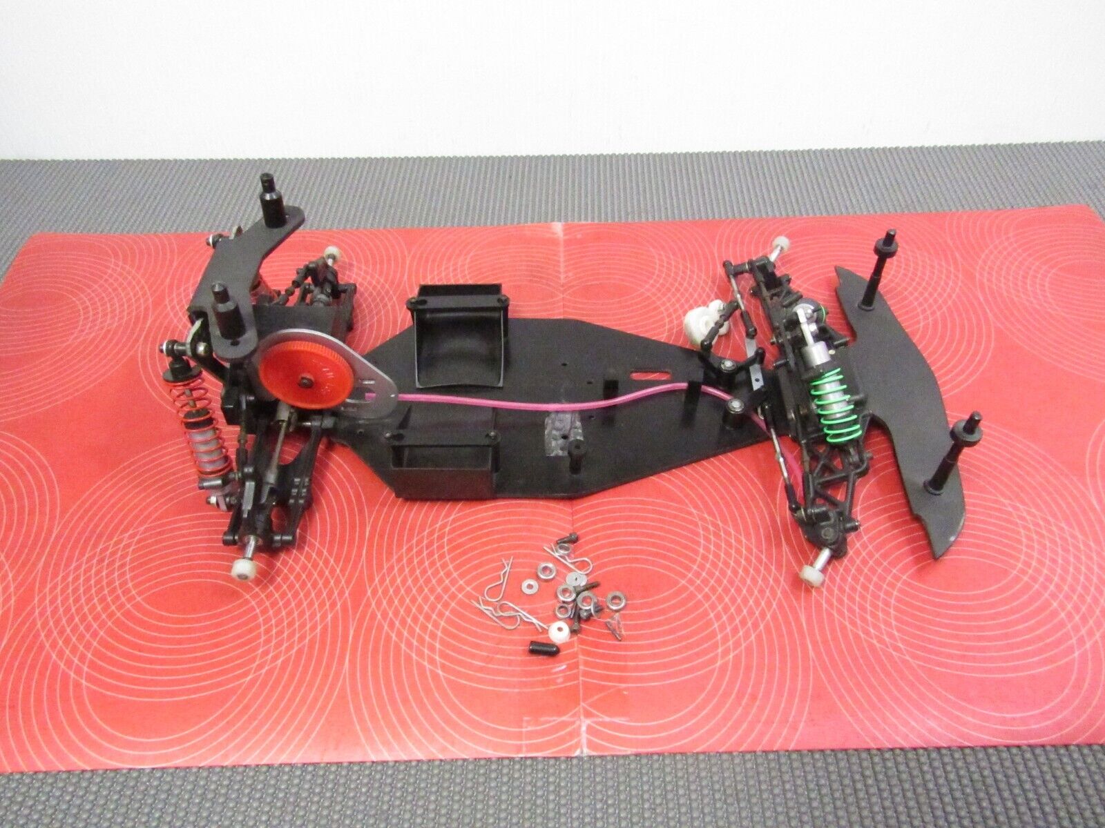

Well looking for something else on Ebay I bumped into something very familiar looking
What gets me is the inverted rear shocks, which has been something that people are currently doing.
