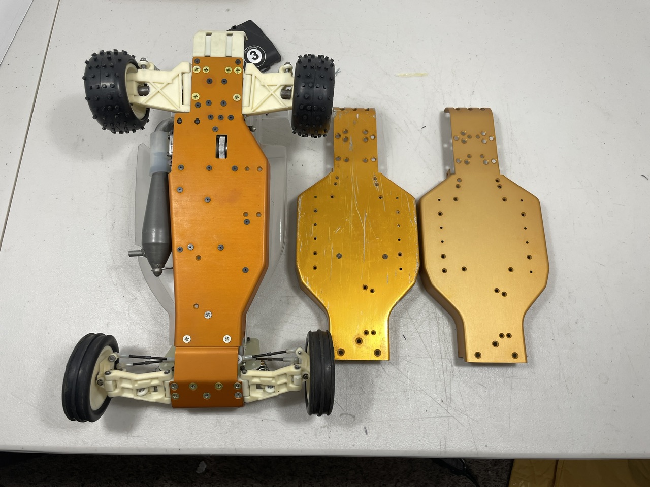

That is true, stripping of color doesn’t matter the origin color. I
Here’s a picture of my chassis vs the ones I have on hand.
Left is the redone chassis, middle unknown year A stamp, right classic.
I feel like I’ve seen some darker gold towards the end of the run of the gold pans. Maybe it was just the black plastic making me think it was darker though. I do think if you spent the time/money polishing the chassis for the brighter sheen, it would look better.

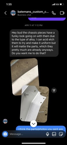

Batemans stripped the ano for me so all I did was send him the chassis. He also has an acid etch he could’ve done to make the surface more uniform but he informed me it would make them even more dull.
Here’s an example of what I call good customer service and communication.
