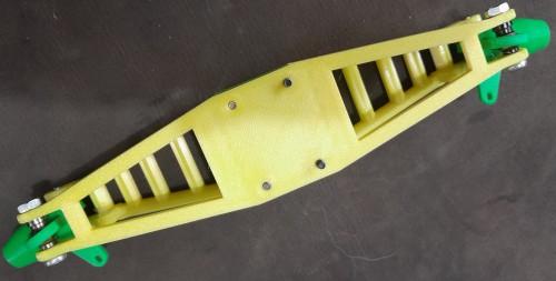

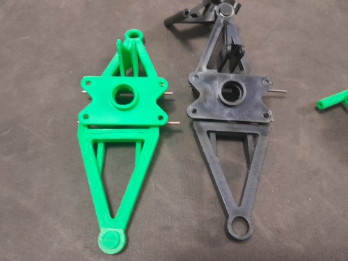

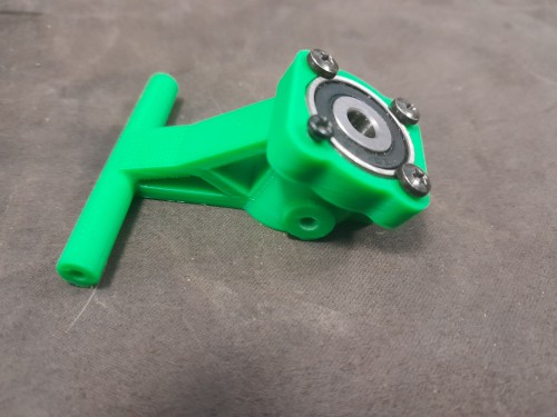

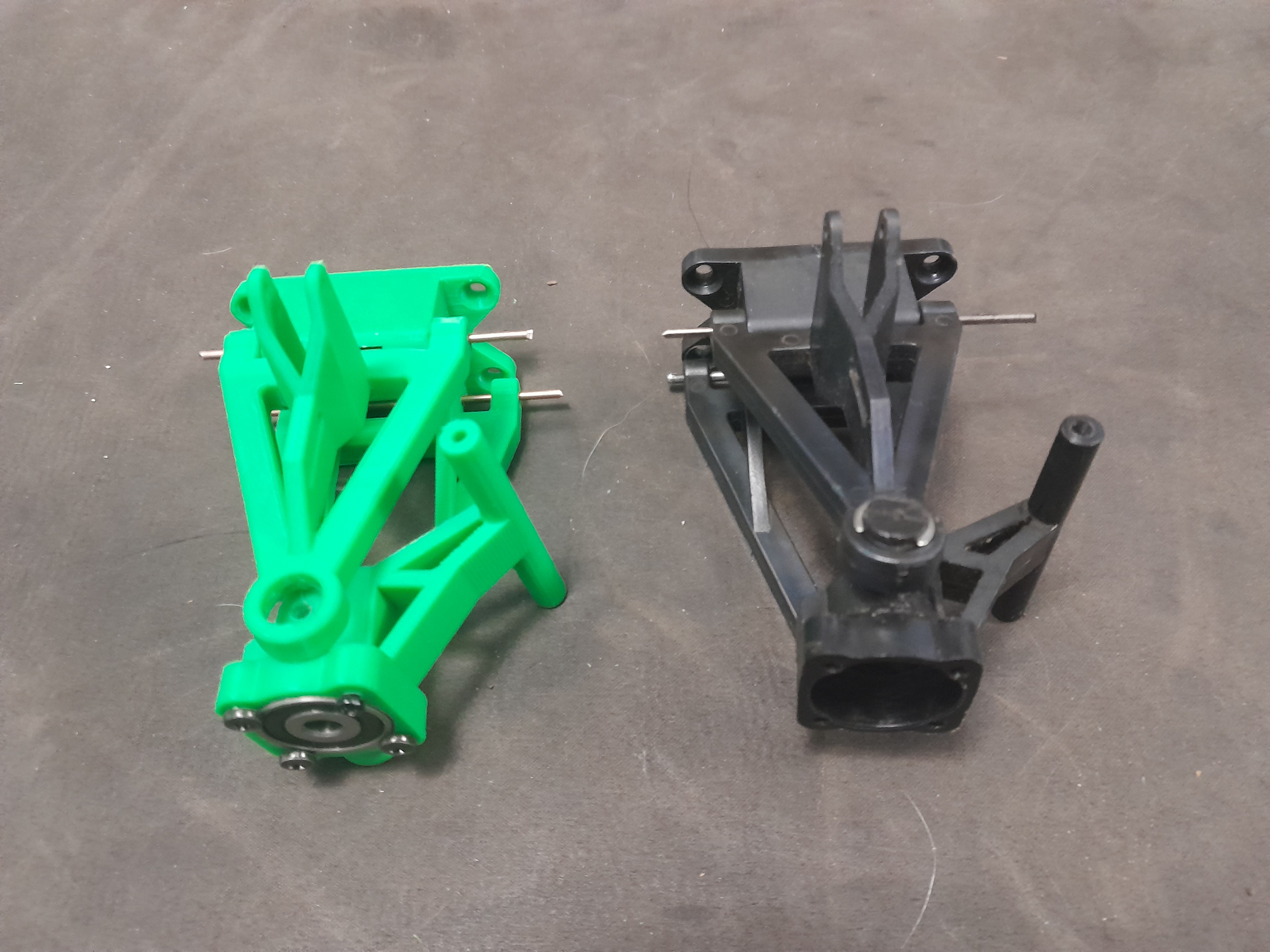

Started modelling the Mugen Bulldog , all four suspension corners are the same parts so it's a bit like cheating.
The balljoint sockets are a little tight with FDM home printing and will need a little more clearance, may not be needed for pro print shops , the rest is good to go .

Nice work. The Mucgen Mercury arms are slightly more complex... I need to get back to it, by the way: now that the Marui gearset is done, it is really time for it

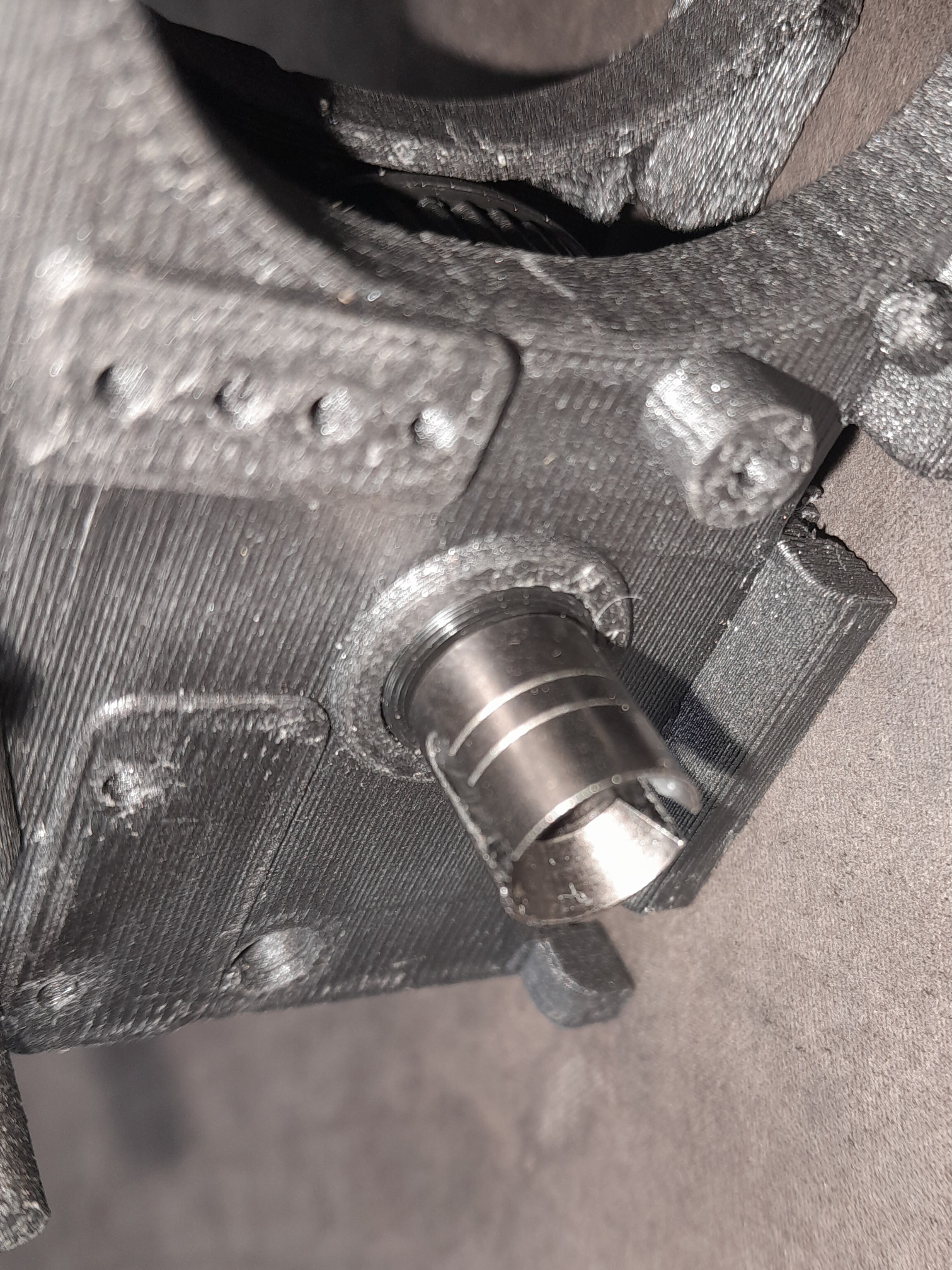

Re: Dadio's 3D Printing Stuff

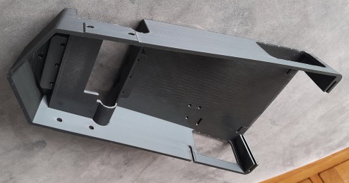

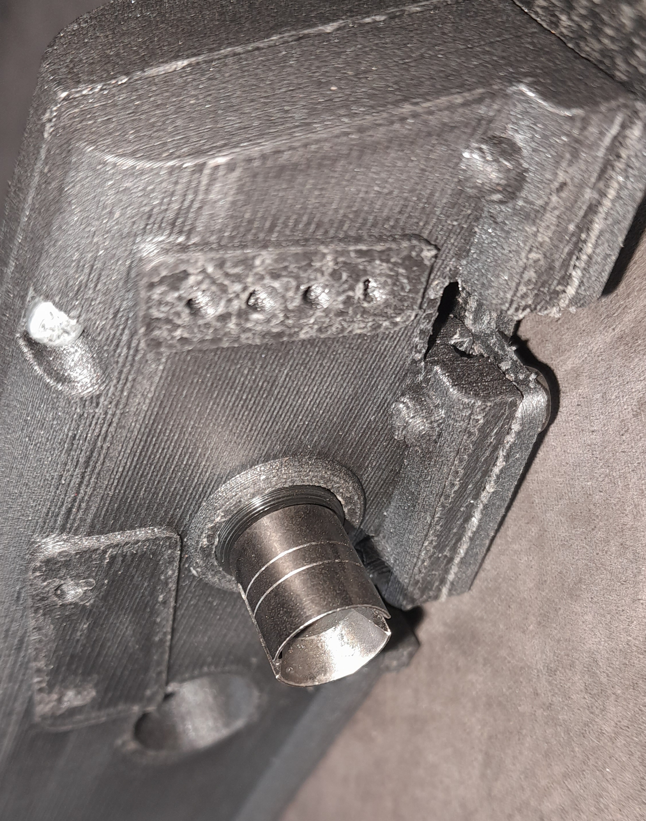

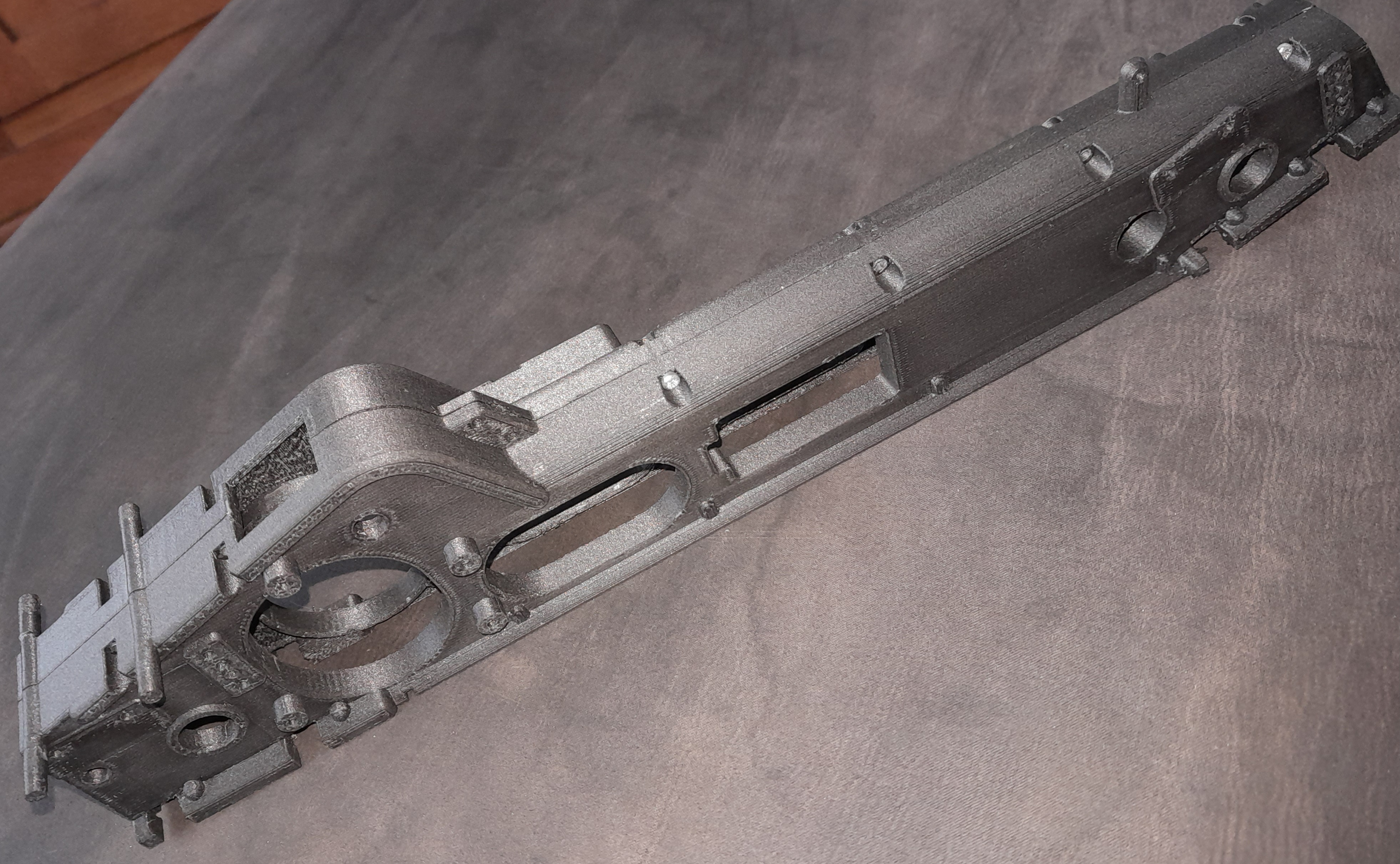

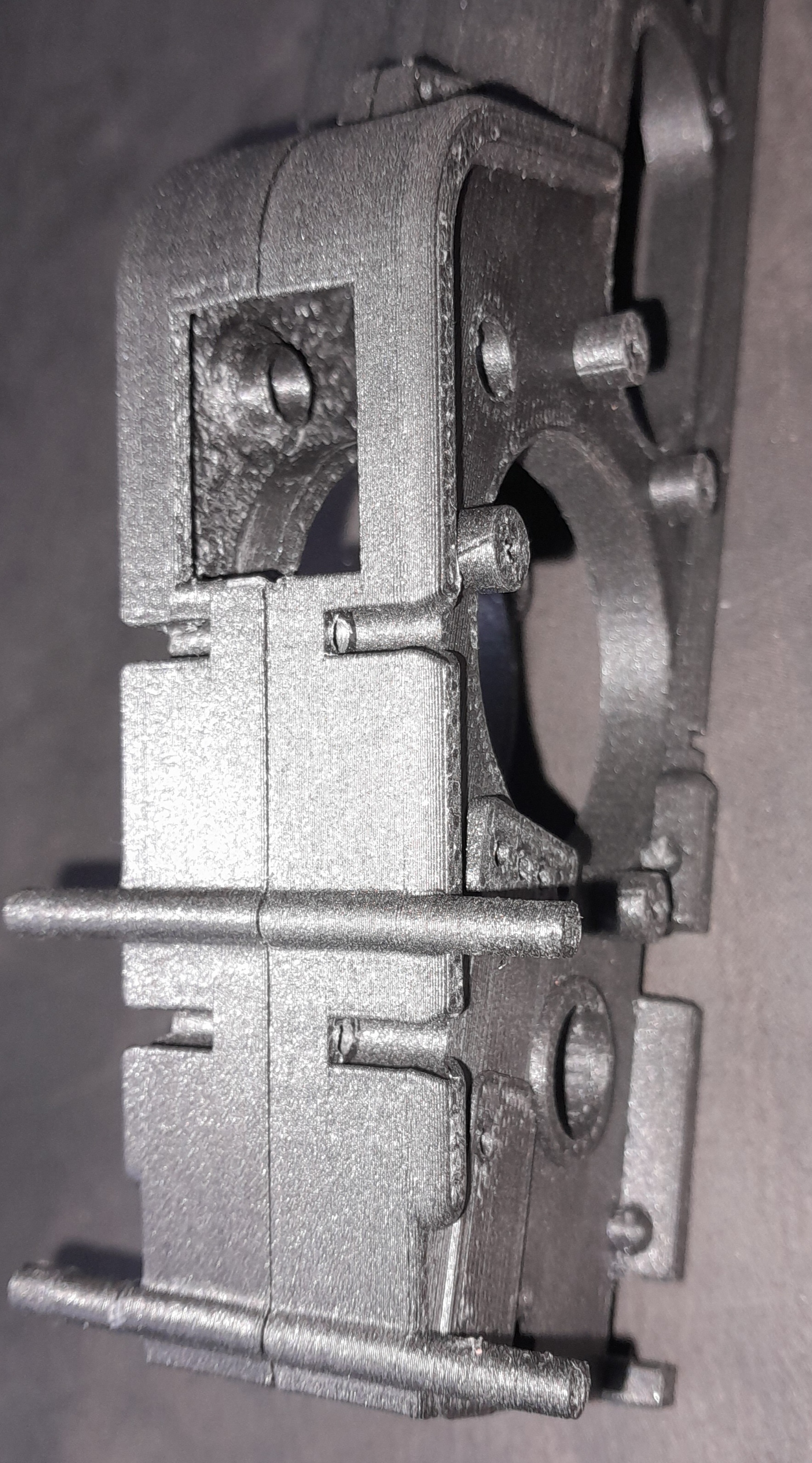

More Mugen Bulldog , transmission housing done .
For the Eagle eyed this one has a few minor additions to optimise it for FDM printing.If a jobs not worth doing then its certainly not worth doing well.

It's difficult to see when you can't compare with the original part, my friend
[/quote]
[/quote]
There are several paired posts that come out of the top and bottom of the transmission casing , I just added a web between them and extended it to bed level (only 1mm) , I also put a 45 degree chamfer on some overhangs
[/quote]
[/quote]

I suspected that, but as I don't know the Mugen Bulldog, I wasn't sure

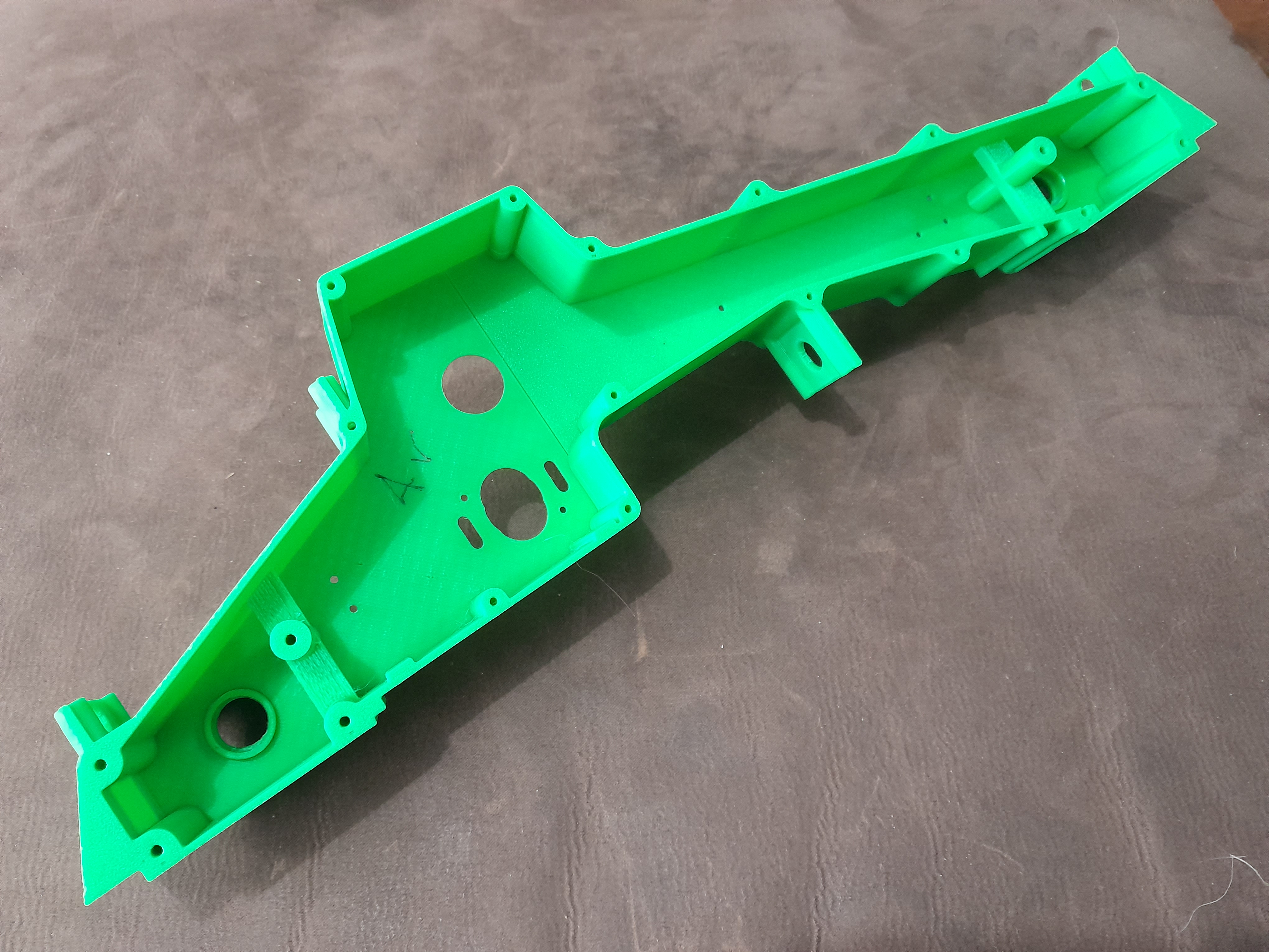

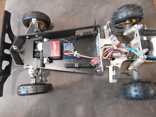

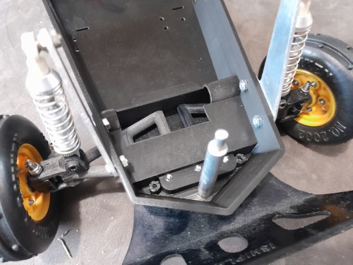

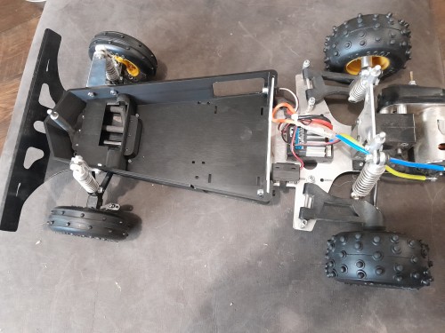

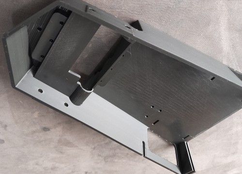

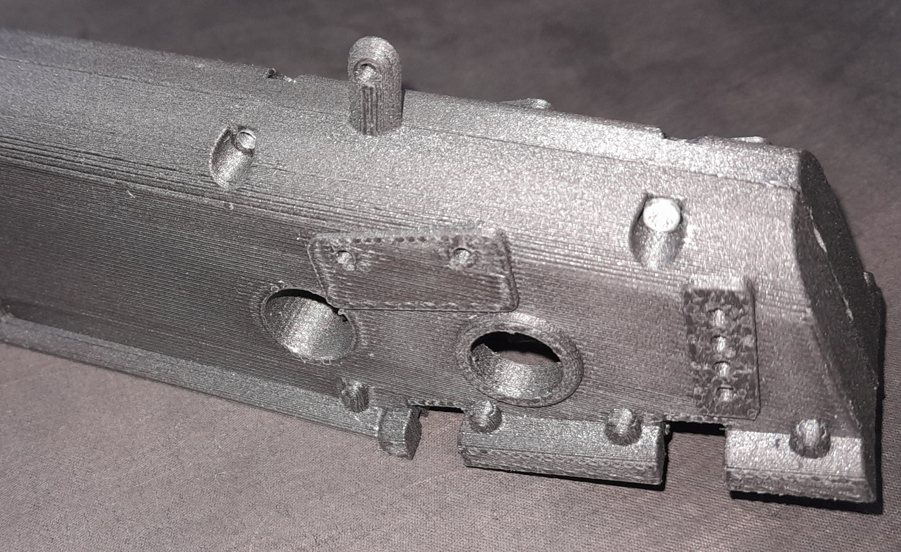

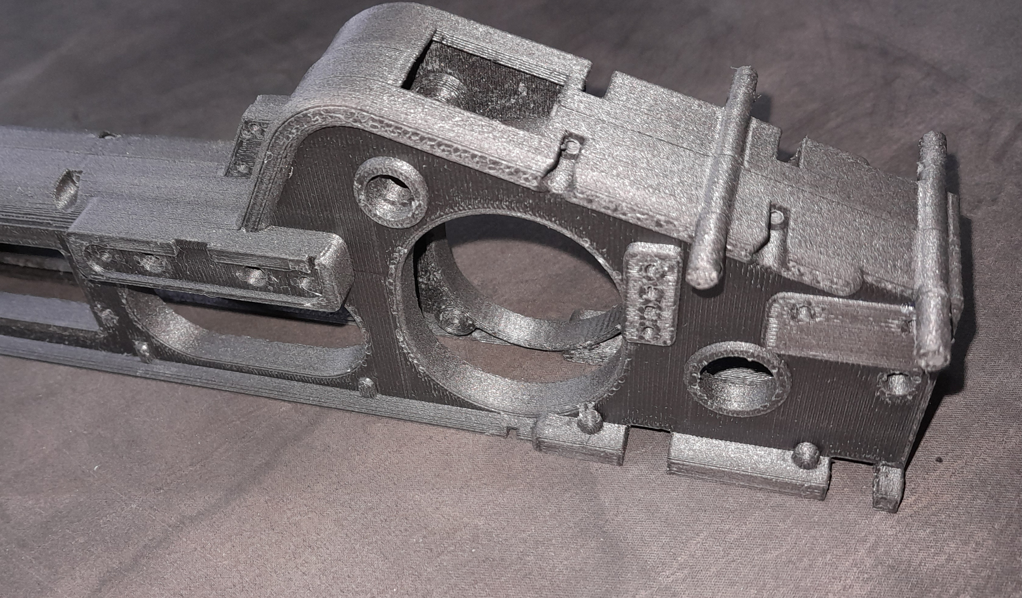

I just found that I can fit the PB Mini Mustang chassis on the P1P print bed in one piece
- Posts: 4072
- Location: Guildford UK
- Has thanked: 2772 times
- Been thanked: 2253 times
Mini Mustang chassis in CF PETG , going to work on a diff that uses Hotshot bevel gears as parts are very scarce now for the Mustang

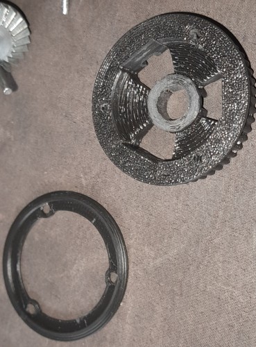

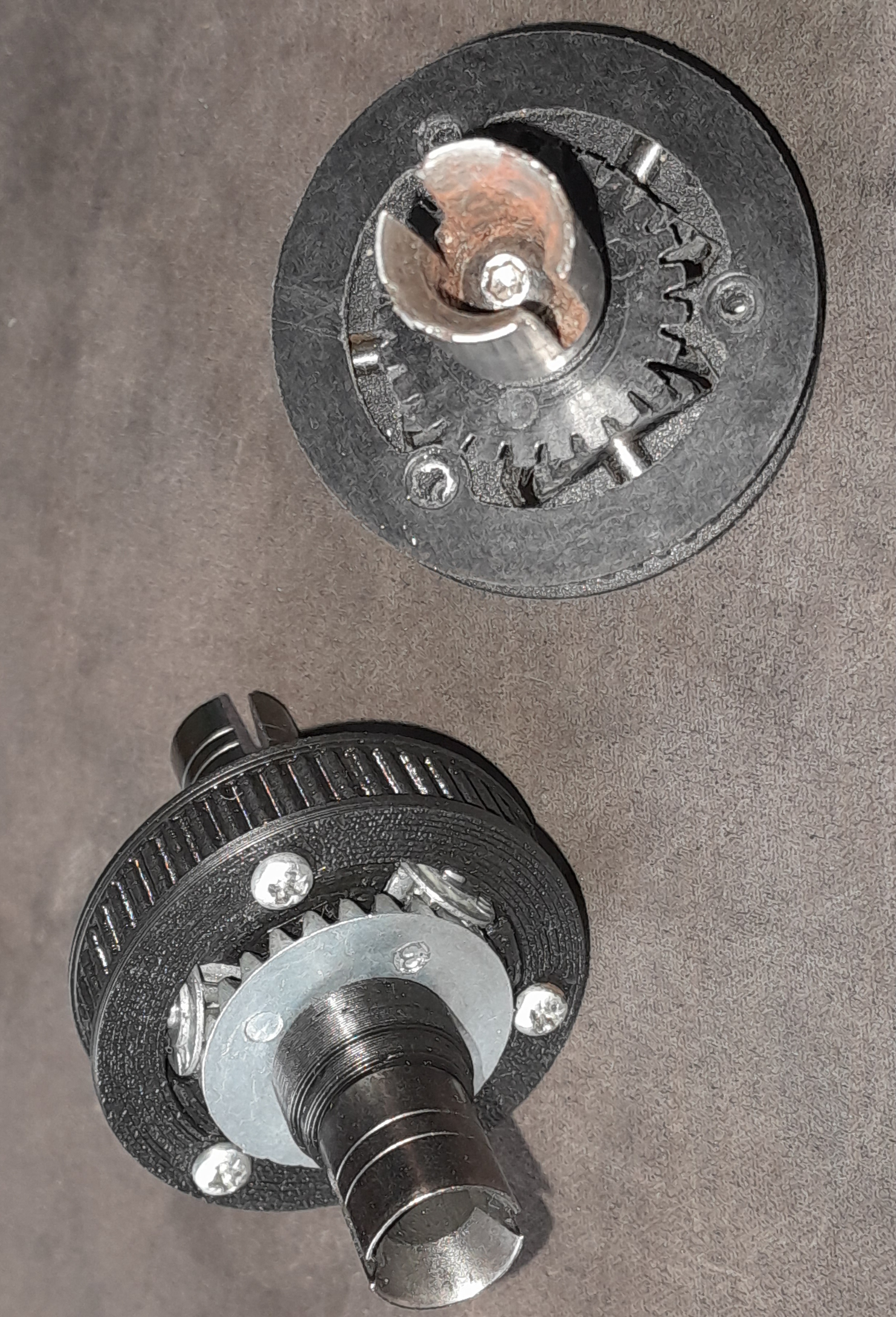

Thanks , been working on the diff , looks possible .

Well, the Big Bear ran with bevel gears printed in plain nylon in my Bambu Lab X1C for quite a while without a single issue... So yes, it should be possible (and I did not used a 0.2 mm nozzle for that).

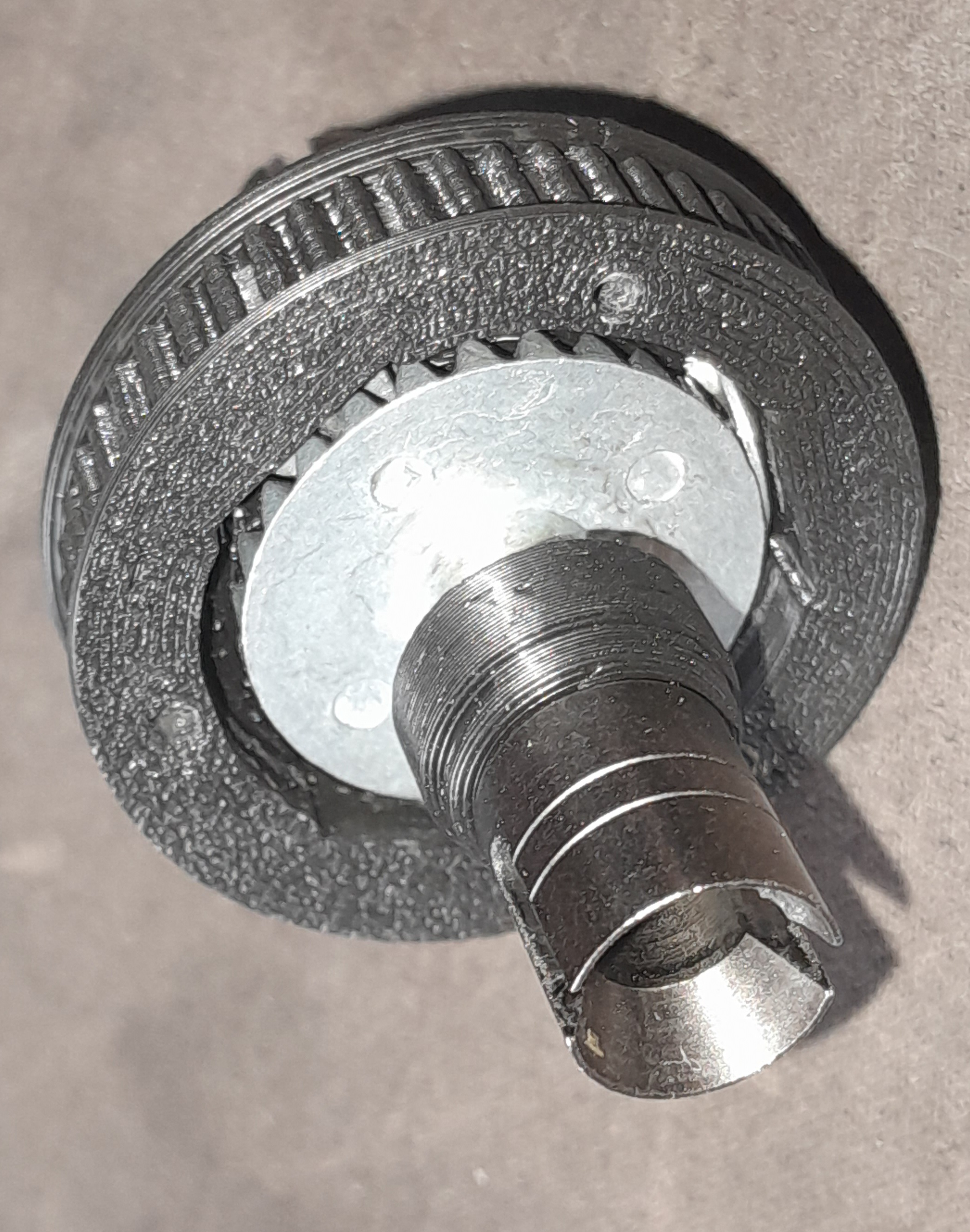

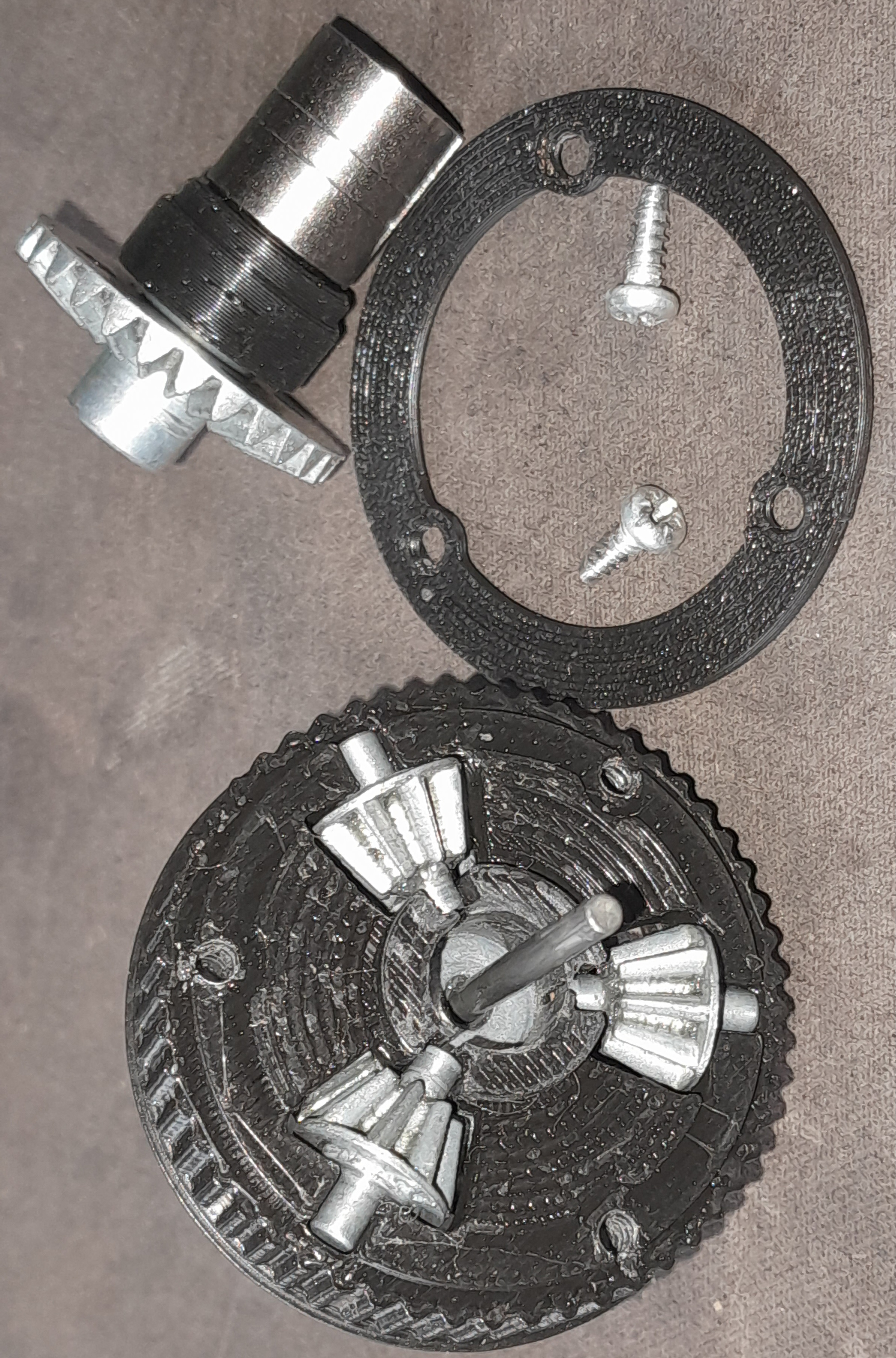

I'm planning on using the metal diff gears and outdrivres from the Hot Shot and just printing the toothed pulley and bearing adapters .silvertriple wrote: ↑Fri Aug 11, 2023 4:27 pmWell, the Big Bear ran with bevel gears printed in plain nylon in my Bambu Lab X1C for quite a while without a single issue... So yes, it should be possible (and I did not used a 0.2 mm nozzle for that).

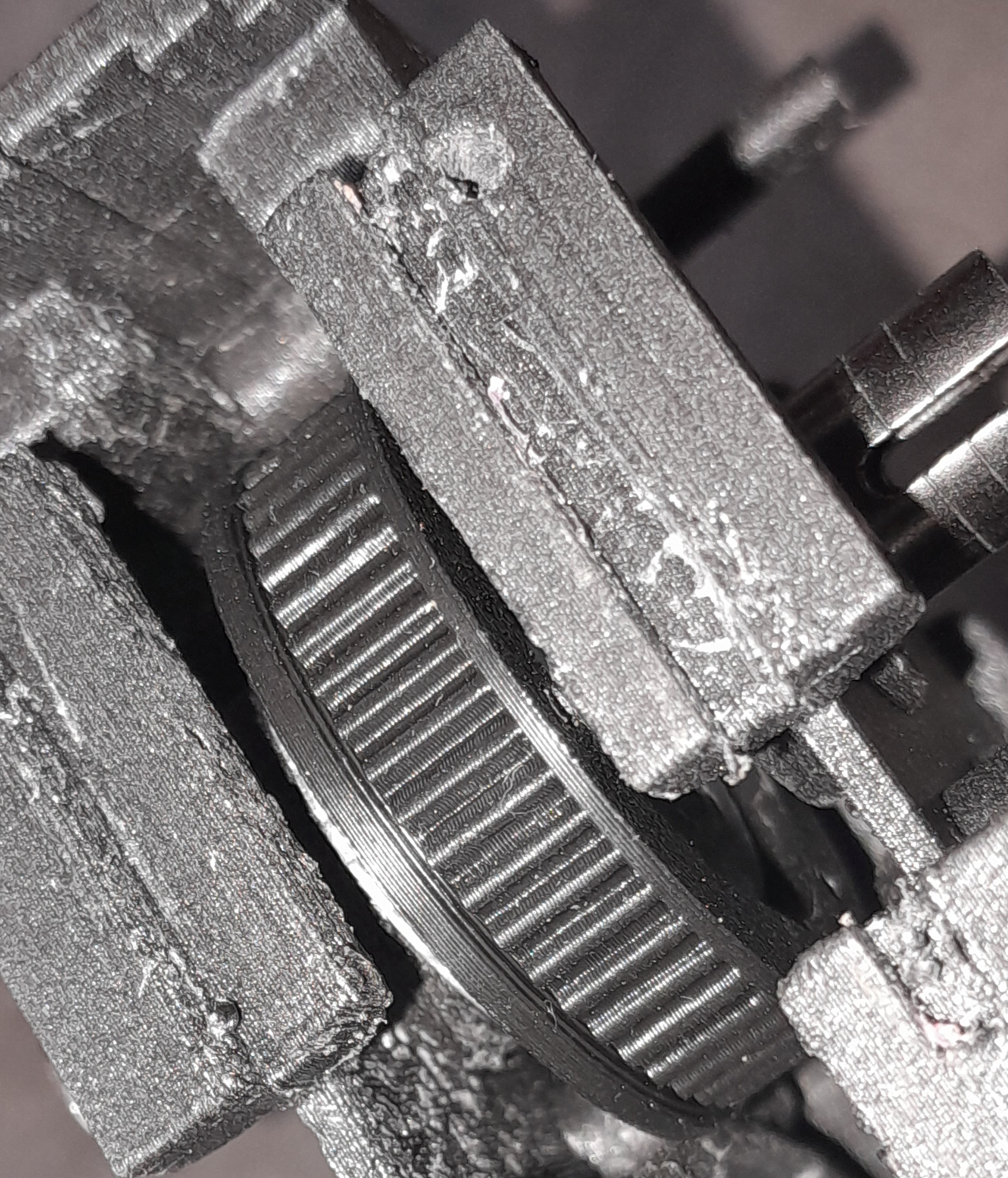

- Posts: 4072

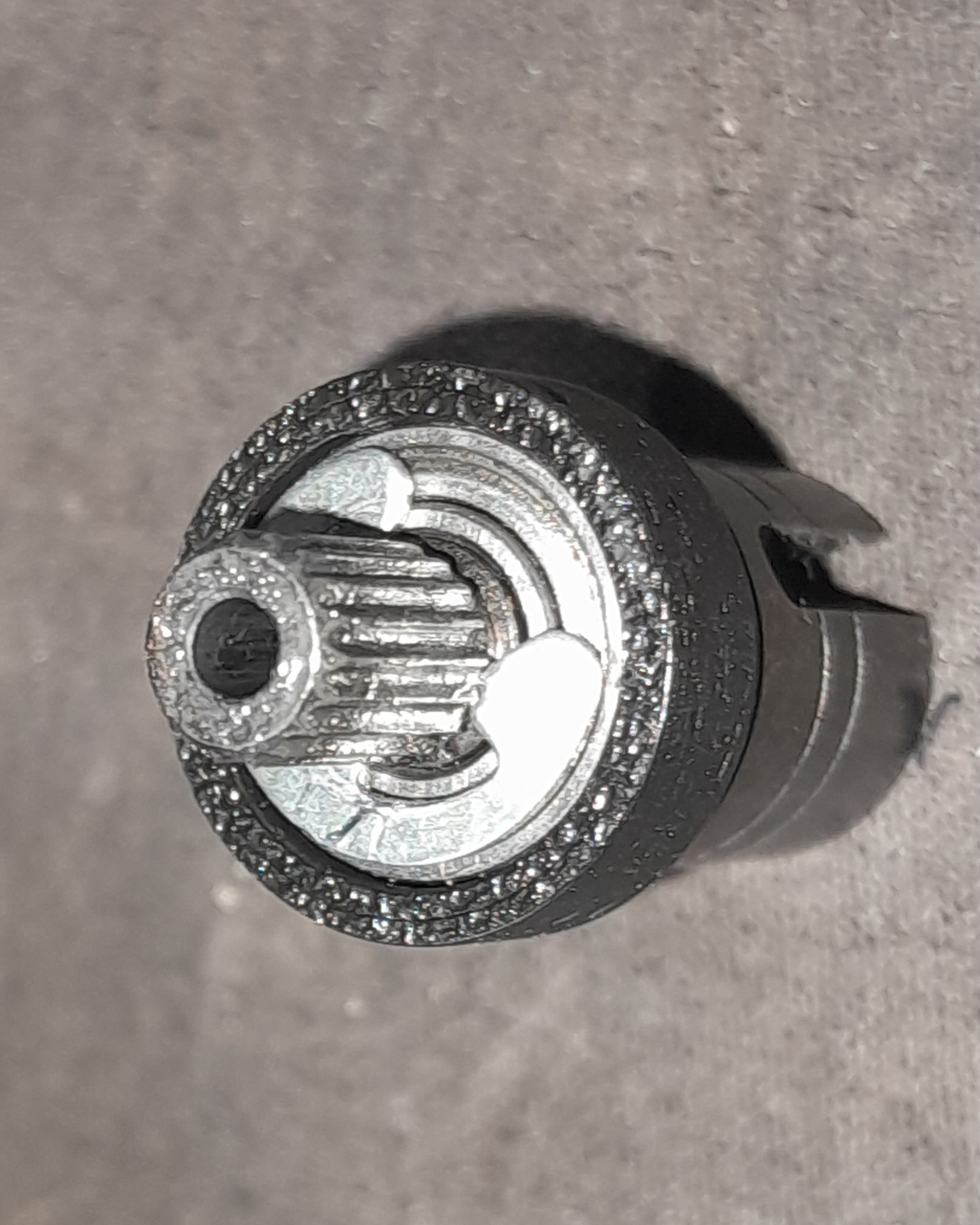

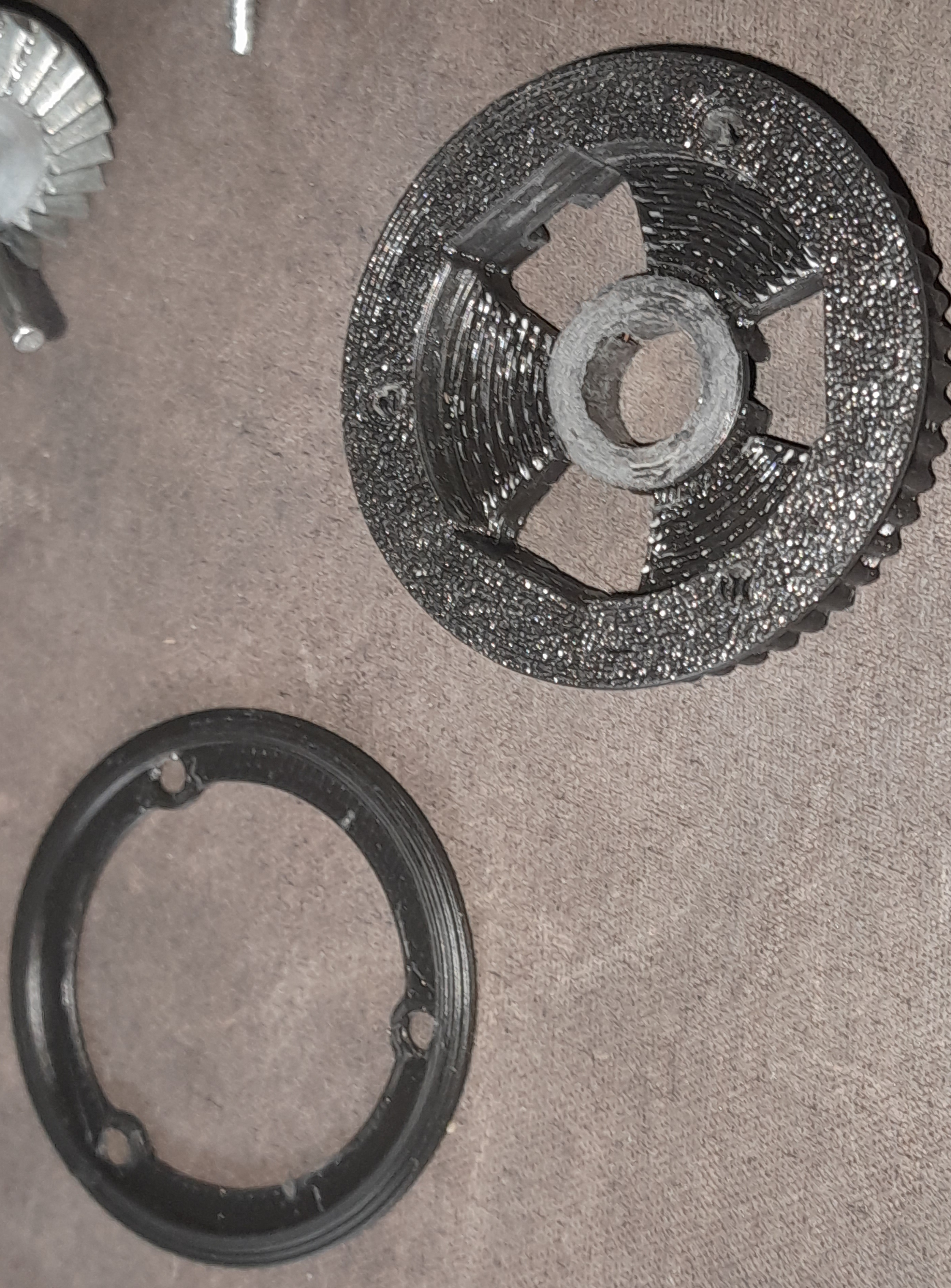

Hot Shot diff gears in a mini Mustang compatible diff , will need axles to match the more common dog bone size of the Hot Shot , uses 5x10 bearings and an adapter to fit the 13mm hole for the stock Mini Mustang bearing .

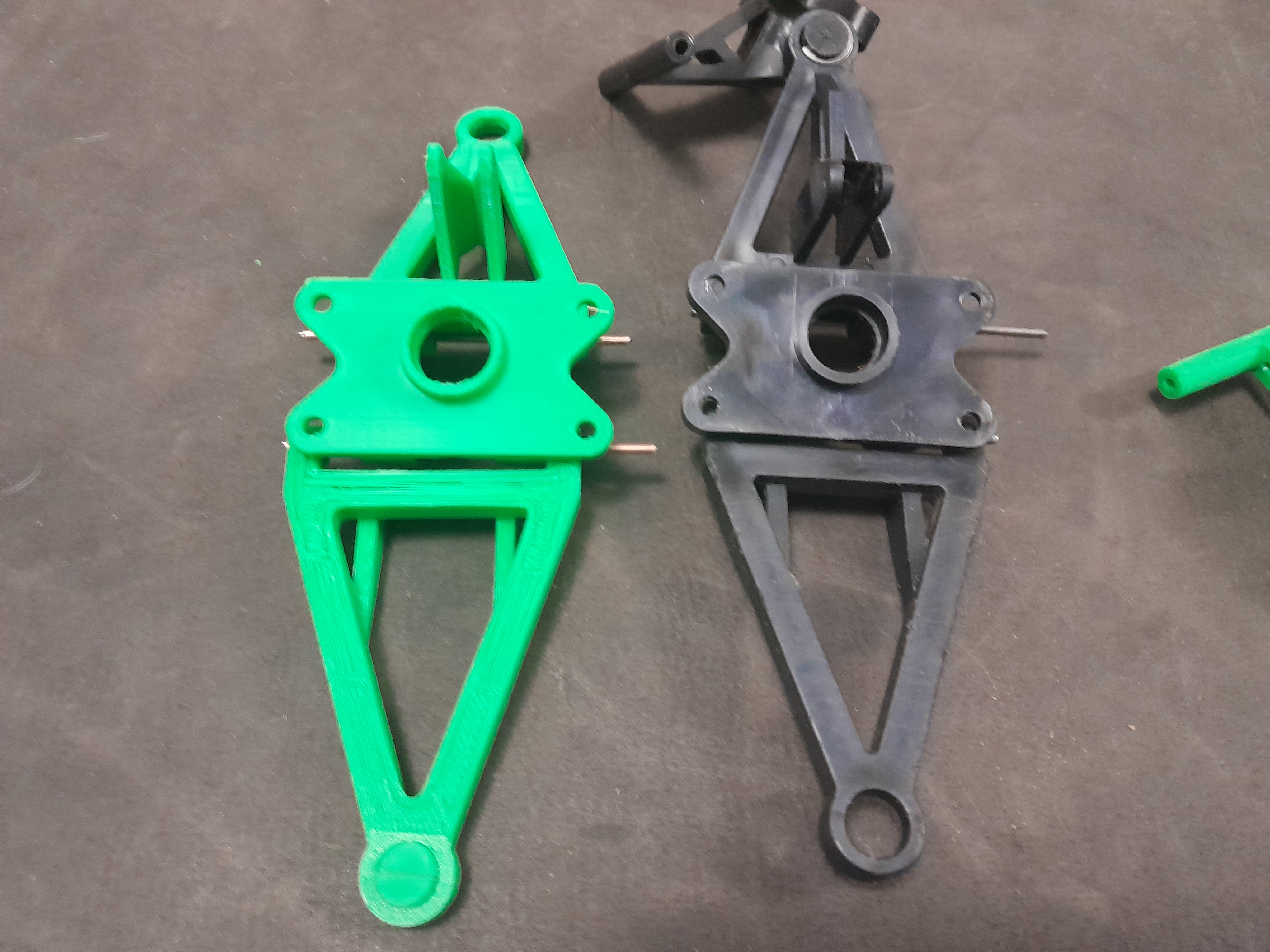

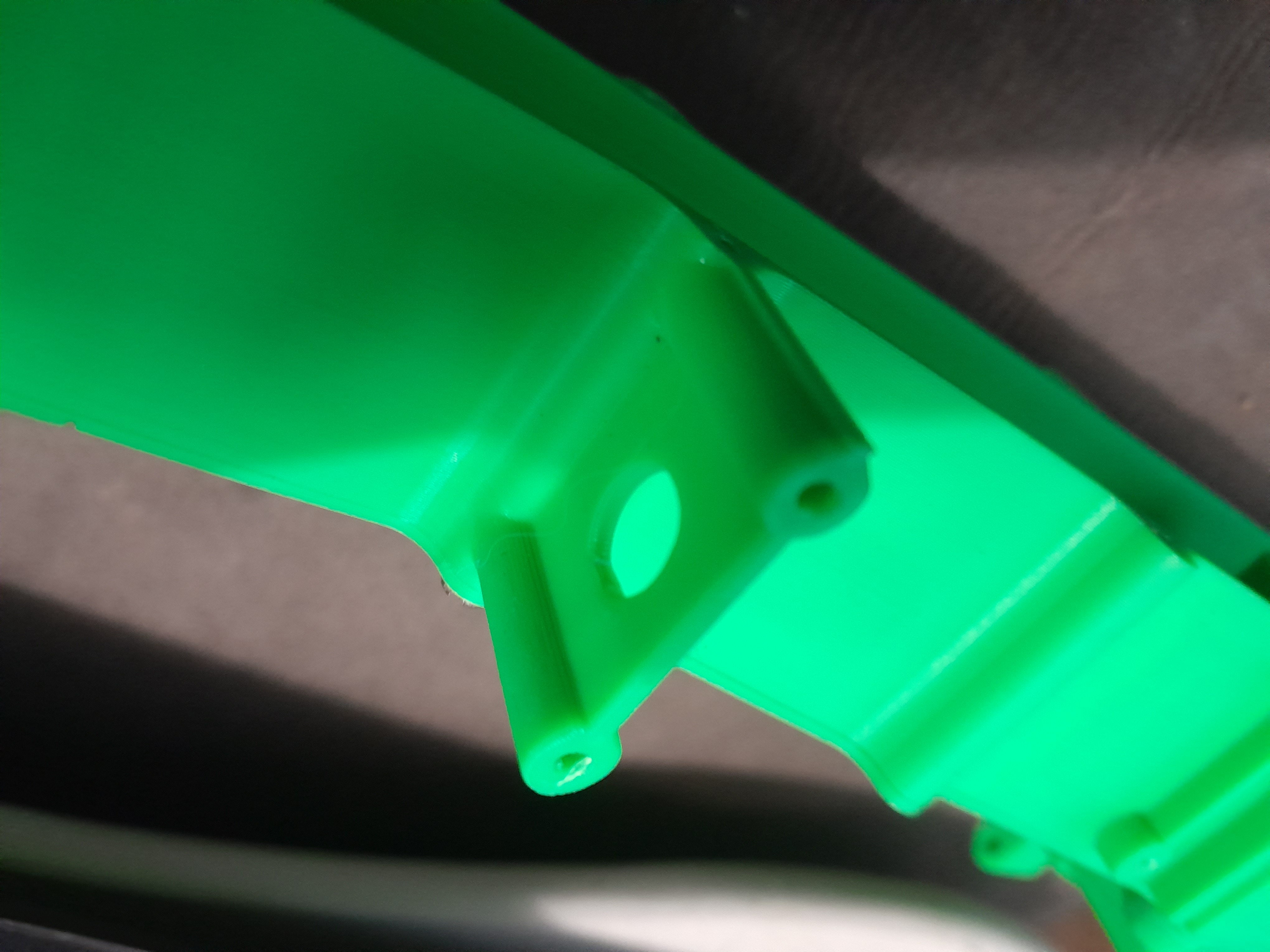

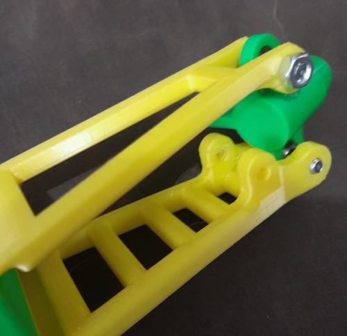

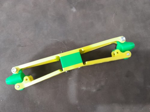

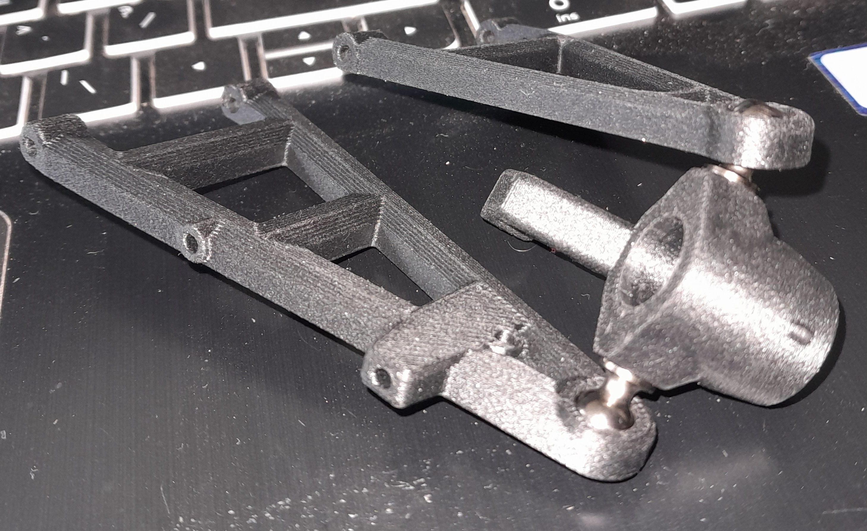

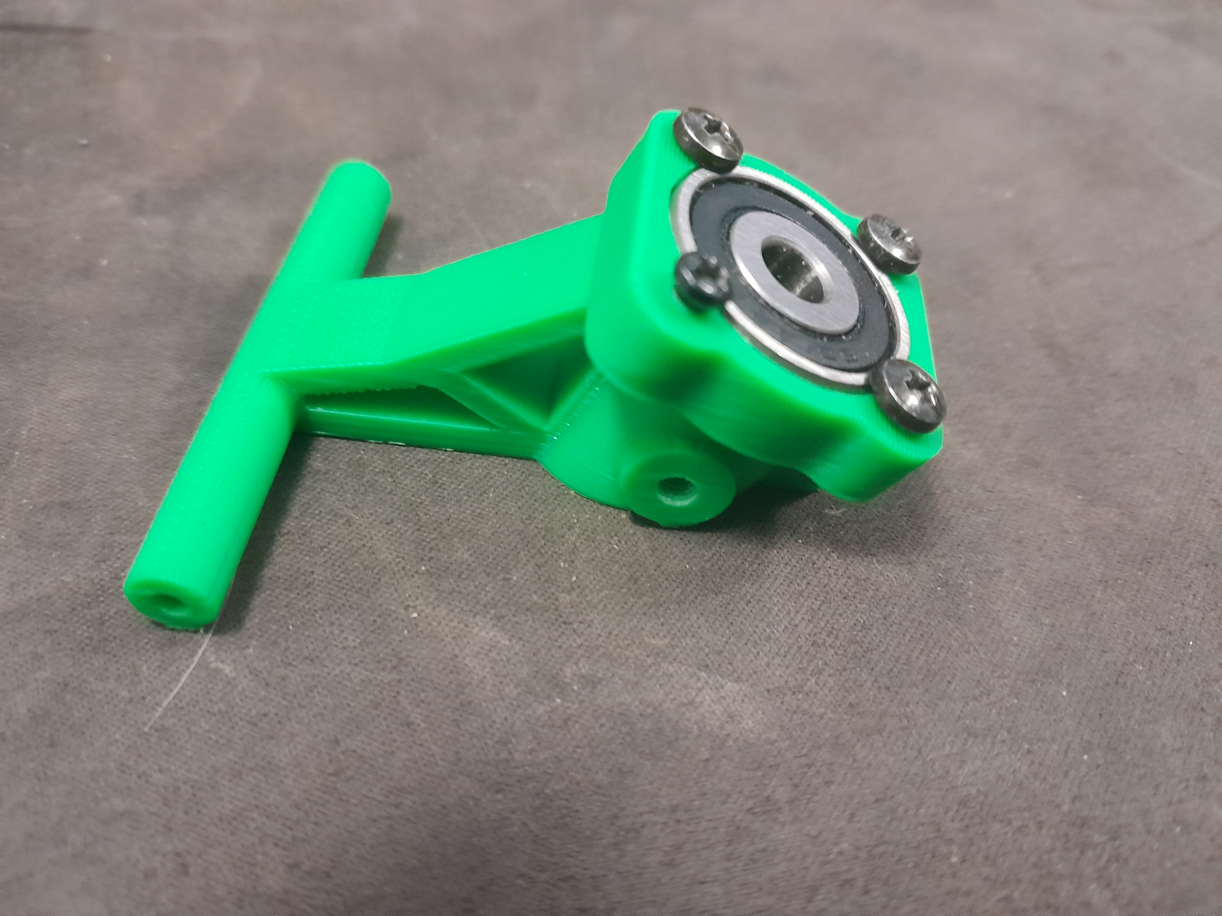

PA6 CF prints so well , printed some Mini Mustang arms and once I pressed in the ball studs they are free and smooth , often when you print a ball joint you have to hone them a bit , very impressed with the dimensional accuracy .
These arms and hubs are modified to use HotShot dog bones and axles to make a set to complement the Hotshot diff components .If a jobs not worth doing then its certainly not worth doing well.
