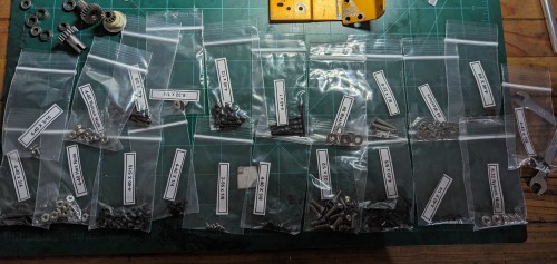

I know some of you were wondering about the contents of the KNK hardware set. Here's a pic of everything it came with.
Have officially started the rebuild tonight so I will post some progress pictures tomorrow.

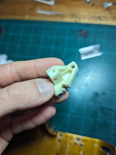

What would you all do here? Is it worth trying to get a replacement piece for this suspension mount or could I possibly hack something together with epoxy, a file and a new screw hole drilled? I did see that guy on Facebook is selling the reproduction parts but it seems like he is in the UK and I'm not sure where it's going to wind up costing me to get a single piece of plastic shipped. Is there any online store that has these parts or am I going to have to find an individual printing them?
Posts: 3676
Has thanked: 2519 times
Been thanked: 2821 times
Re: Gifted an old RC10. Restoration Process
Personally I'd either get a new or used from eBay, or use a 3D printed one.

JoeP wrote: Mon Oct 09, 2023 11:04 pm I know some of you were wondering about the contents of the KNK hardware set. Here's a pic of everything it came with.
Thanks for posting a photo.
So, screws, nuts and washers -- no clips, roll pins, bevel washers or springs for the dog bones.
It's nicely packaged and labeled however. I reckon much of the 30 bucks is for packaging labor. Nice kit.
Regarding the broken front suspension mount, it's common to see this but your best option is to find a replacement. Any attempt to repair the part probably won't last long. For my runner cars, I will fabricate an aluminum bar that spans the two pivot pins. Then I remind myself to avoid the trees and fence posts. :oops:
Team KNK also distributes FanRC which is the company selling the reproduction parts. Looks like $15 for them plus shipping https://teamknkhardware.com/fan-rc/1791-front-arm-mount.html

XLR8 wrote: Tue Oct 10, 2023 10:35 am
Looking forward to re-assembly photos.
Yeah I was kind of disappointed that it didn't come with any of the snap rings. I know they are pretty common pieces of hardware that you can get anywhere, but still it would have been nice to get some replacements.
And yeah I'm just going to buy replacement plastic

Post by JoeP »
GoMachV wrote: Tue Oct 10, 2023 11:09 am Team KNK also distributes FanRC which is the company selling the reproduction parts. Looks like $15 for them plus shipping https://teamknkhardware.com/fan-rc/1791-front-arm-mount.html
Oh this is perfect! I didn't see them on the KNK site when I bought the hardware. Much easier than going through someone on Facebook. I'll grab it from here.

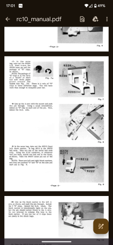

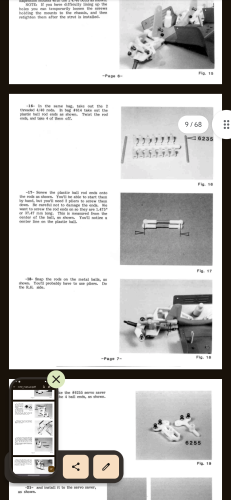

So Im back. Starting to think I am missing more than I originally thought... And that maybe some of this car was a hack job :D
I do not seem to have any of the ball ends or caps mentioned in the instructions. On top of that now that I am looking at the rods mine came with... They do not appear to be original at all. Are these black end rods familiar at all? Seems like someone even hacked at the plastic a bit... Possibly to retrofit from some other car?
Either way, seems like those ball ends are pretty much impossible to find nowadays (6270, 6271). Any thoughts?
EDIT: seems like KNK also has the metal ball studs!
https://teamknkhardware.com/fan-rc/1818-ball-stud-set-for-rc10-series.html
I guess ill need to also buy the white caps
https://teamknkhardware.com/fan-rc/1807-ball-cup-16-pcs-for-rc10-series-white.html
Posts: 3676
DuBro ball links were a common swap for ball cups and they did need trimming for clearance.
