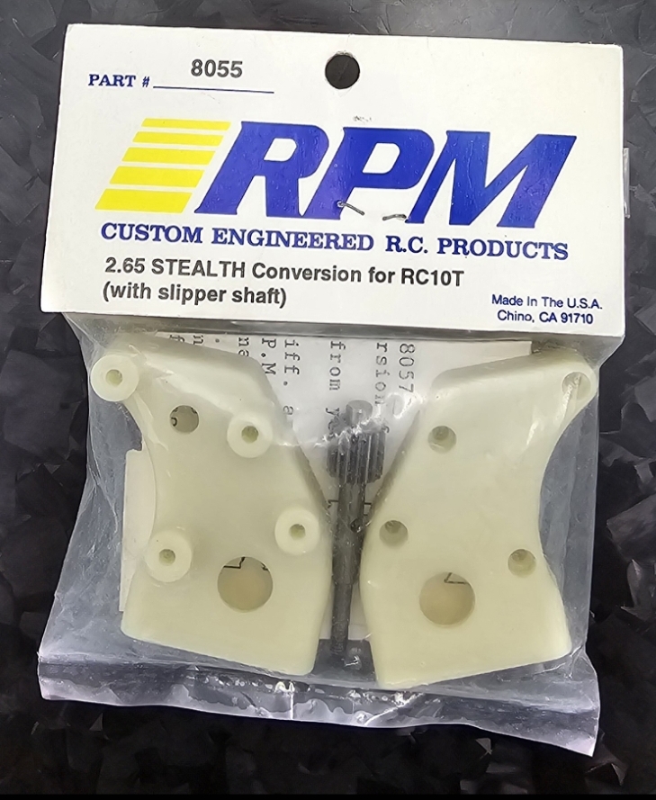

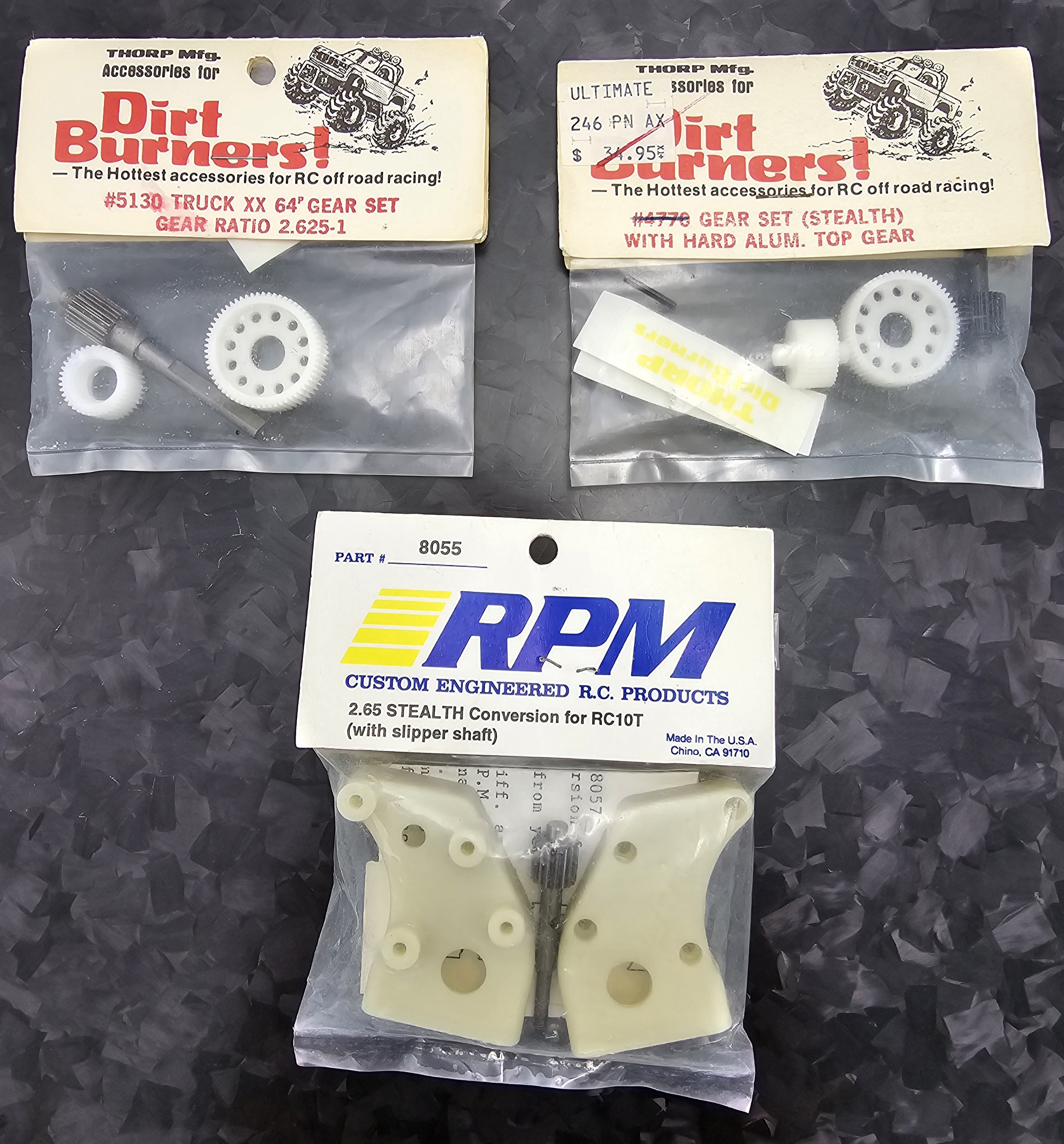

I'm starting this build with the transmission. There will be very few stock parts used as most everything is an option piece. I am starting with an RPM 2.65 transmission case. This will require some careful modification to fit this chassis. Both the case and the RPM arm mounts will need to be reshaped.
I am determined to use the RPM case, and still run 64 pitch gears. This creates a big problem because the RPM case is 2.65 vs the Stealth at 2.25. To make this work I am using gears from different vintage Thorp kits. The Thorp top shaft provides everything I needed to make this all work - 64 pitch gears in 2.65 gearing, and a shaft compatible with a Hydra drive - or in this case, an upgrade to the upgrade by using a Schumacher Visco Drive. This is a really cool aluminum clutch that also uses different viscosities of fluid to suit track conditions.

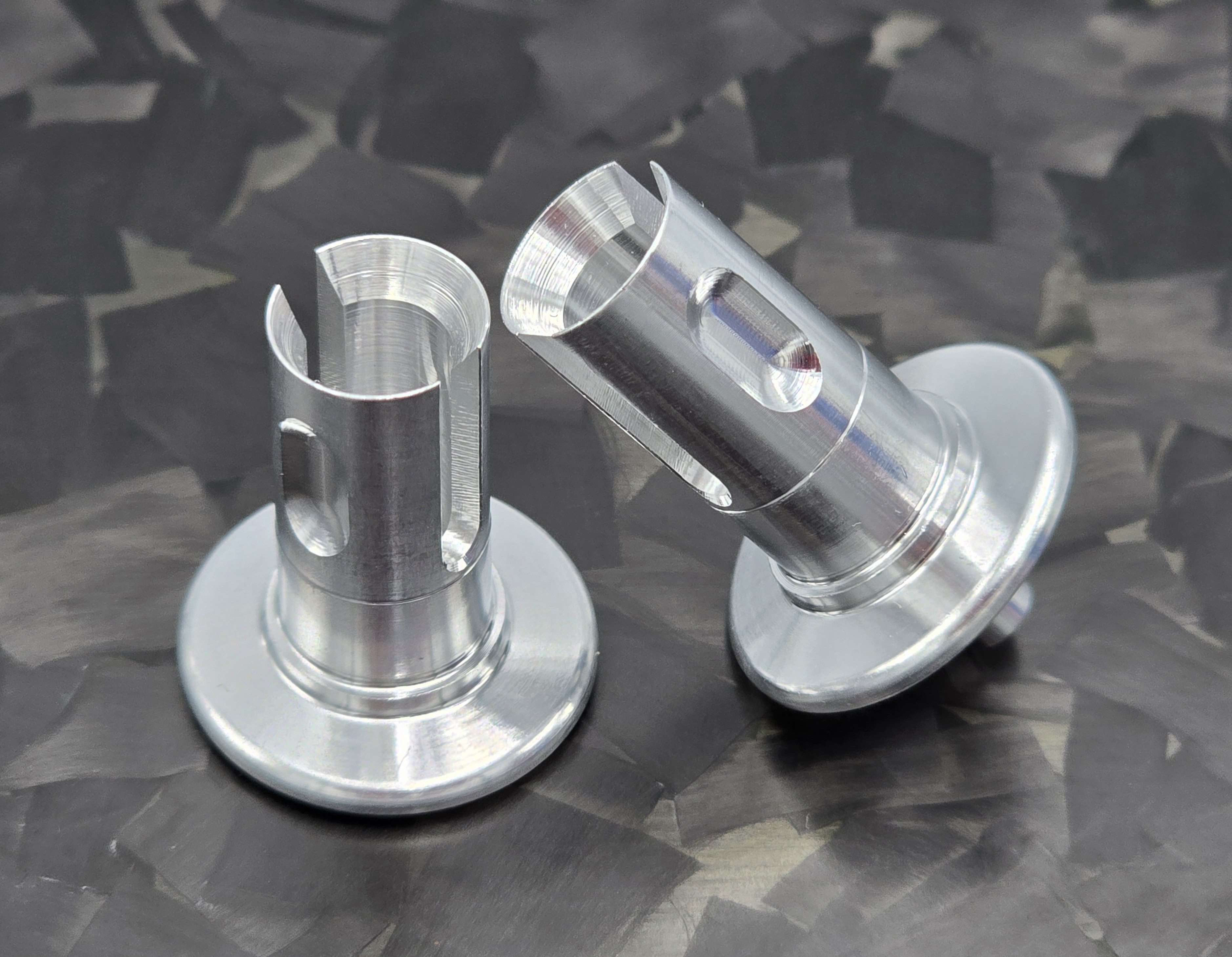

I'll be using these beautiful aluminum outdrives, courtesy of Sofaking. I'm still waiting on a few small pieces, and then the transmission can be assembled.

Since you stated you are going "true to one direction...vintage" I figured you would want to know those Conklin aluminum outdrives are not vintage.

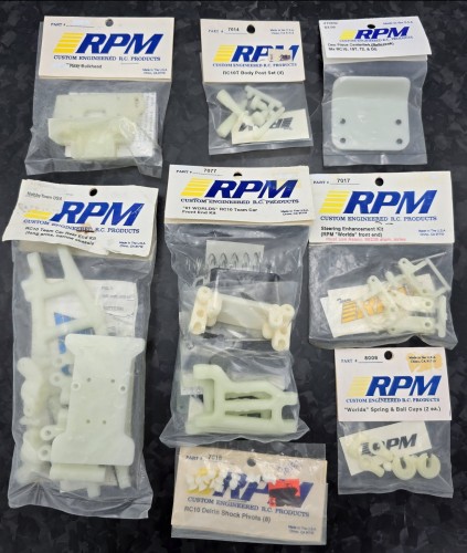

I am waiting on a few pieces to arrive before I can build the transmission. Here are most of the RPM parts I plan to use. I want the white (translucent) plastics to look icy fresh so I am using all NIP parts.
The coloring of the RPM translucent parts can change over time, probably depending on the conditions they are stored. It always catches my eye when pieces of different shades are used. My light box does a great job at enhancing any difference in shade, as well as making pieces look more yellow than they are. Shown below is the same RPM transmission case.

'Arrive'? Where can you find this many NIP parts?Lavigna wrote: ↑Mon Mar 04, 2024 11:12 pm I am waiting on a few pieces to arrive before I can build the transmission. Here are most of the RPM parts I plan to use. I want the white (translucent) plastics to look icy fresh so I am using all NIP parts.
- Lavigna
- Posts: 1462
- Location: Petaluma, CA
- Has thanked: 1099 times
- Been thanked: 1418 times
Re: RC10 Composite Craft Worlds build #2
Any and everywhere. I've been collecting some of these parts for years, so please don't think I just found this stuff yesterday.JosephS wrote: ↑Mon Mar 04, 2024 11:27 pm'Arrive'? Where can you find this many NIP parts?Lavigna wrote: ↑Mon Mar 04, 2024 11:12 pm I am waiting on a few pieces to arrive before I can build the transmission. Here are most of the RPM parts I plan to use. I want the white (translucent) plastics to look icy fresh so I am using all NIP parts.
