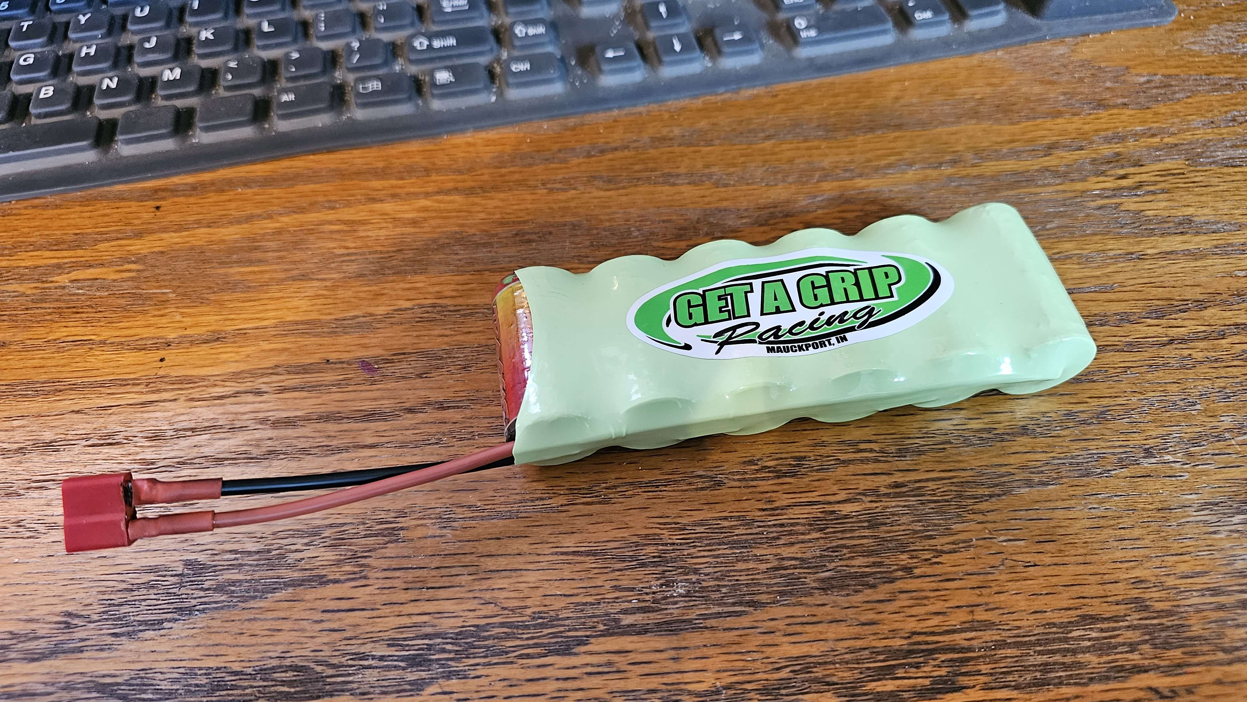

This is 85mm wide. It was honestly too wide, I would suggest 75mm wide for packs like this. or are you needing to know what size for individual sub c cells?

I'm actually looking for the per cell wrap size and not a pack. Were you using 2:1 or 3:1 for your pack wrap?LowClassCC wrote: ↑Sat Feb 24, 2024 11:55 am This is 85mm wide. It was honestly too wide, I would suggest 75mm wide for packs like this. or are you needing to know what size for individual sub c cells?
or is the 75mm the post shrink size.

The cell shrink size is 52mm long and 43mm wide. I bought this stuff years ago in bulk and have zero clue to its shrink rate.
the green pack shrink in the pic i picked up from an ebay seller.
https://www.ebay.com/itm/193796032734
here are the sizes and what they shrink too.
Width(Dia): 7mm (Ø4mm) 9mm (Ø5mm) 12mm (Ø7mm) 15mm (Ø9mm) 17mm (Ø10.8mm) 18.5mm (Ø11.5mm) 20mm (Ø12.7mm) 23mm (Ø14.5mm) 27mm (Ø16mm) 29.5mm (Ø18mm) 31mm (Ø18mm) 36mm (Ø22mm) 40mm (Ø25mm) 43mm (Ø27mm) 45mm (Ø28mm) 50mm (Ø32mm) 53mm (Ø34mm) 55mm (Ø35mm) 60mm (Ø38mm) 64mm (Ø40mm) 66mm (Ø42mm) 70mm (Ø44mm) 75mm (Ø48mm) 78mm (Ø49mm) 80mm (Ø50mm) 83mm (Ø52mm) 85mm (Ø55mm) 88mm (Ø56mm) 90mm (Ø57mm) 91mm (Ø58mm) 95mm (Ø60mm) 103mm (Ø65mm) 110mm (Ø70mm) 115mm (Ø73mm) 120mm (Ø76mm) 123mm (Ø78mm) 125mm (Ø80mm) 130mm (Ø83mm)

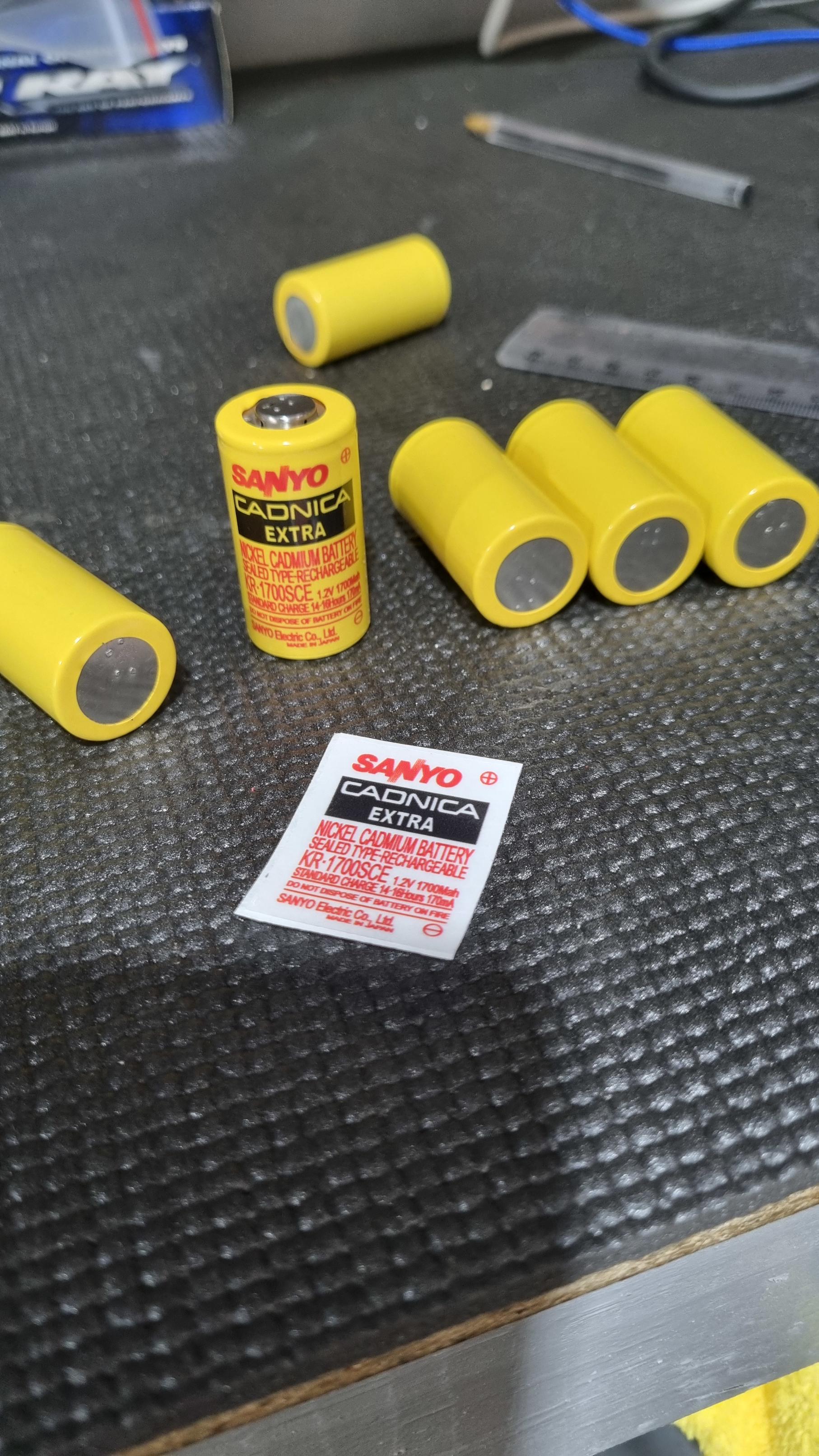

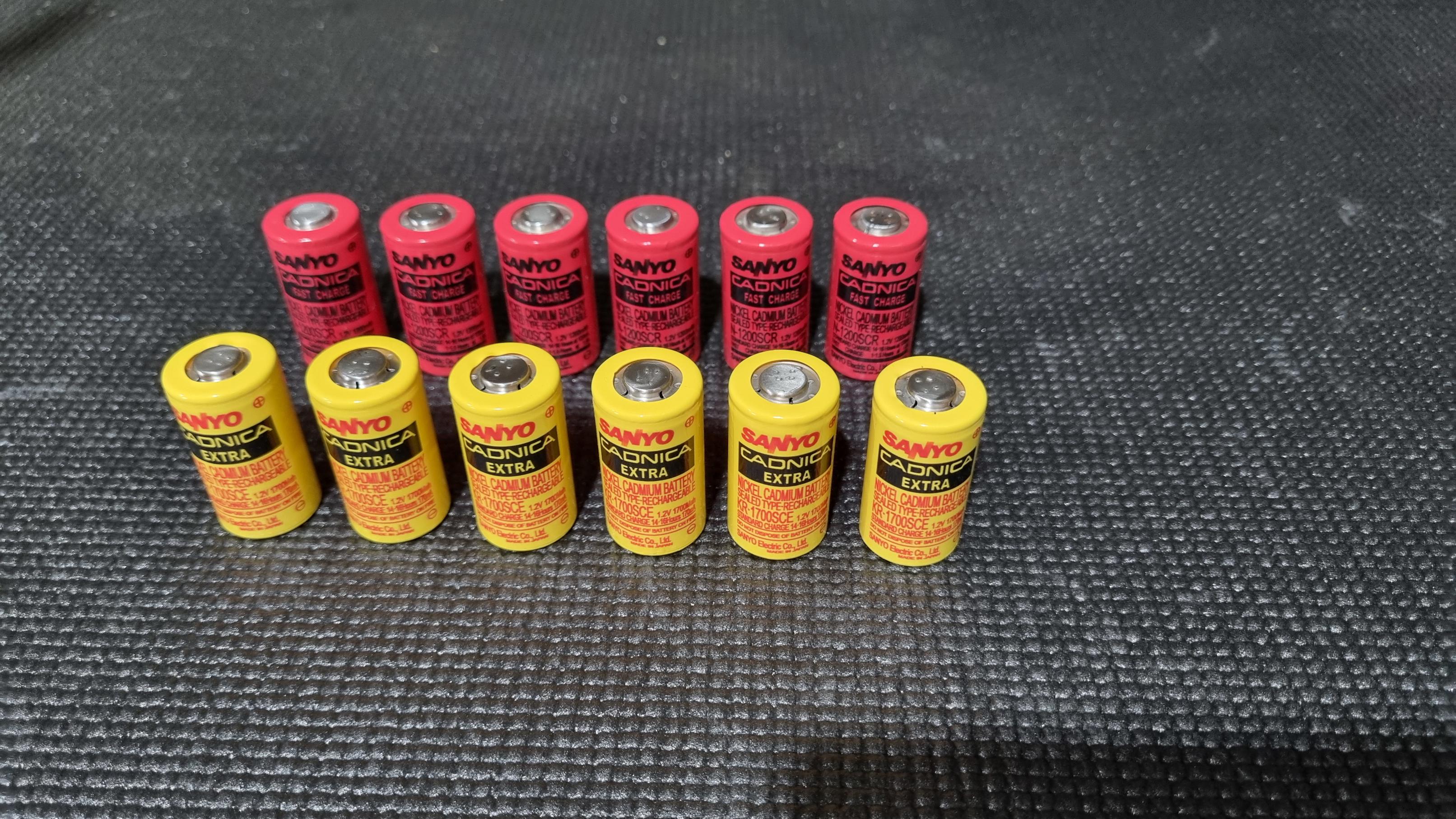

I just got some 40mm flat size and they fit perfectly. (2 to 1) Cut them to 50mm in length per cell.

They look nice, are those MCI decals on colored heat shrink?

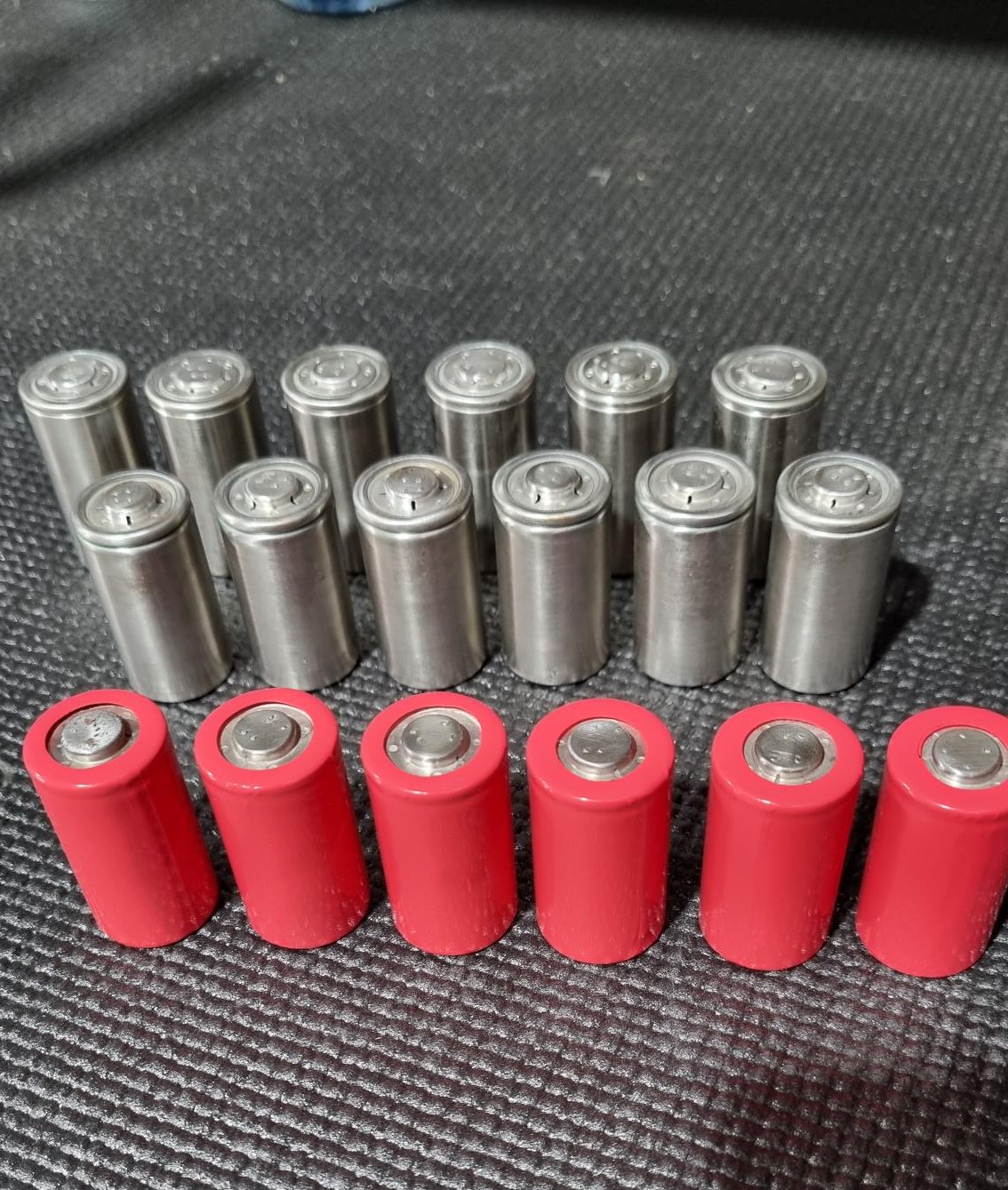

What cells did you start with?caesar wrote: ↑Fri Mar 01, 2024 12:52 am I just got some 40mm flat size and they fit perfectly. (2 to 1) Cut them to 50mm in length per cell.

There from a guy called César Velayos Enríquez on facebook. I just messaged him through there. Just colored heatshrink with decals.

Some old Nicads, you could use nimh cells (they are a touch longer)mtbkym01 wrote: ↑Fri Mar 08, 2024 1:55 amWhat cells did you start with?caesar wrote: ↑Fri Mar 01, 2024 12:52 am I just got some 40mm flat size and they fit perfectly. (2 to 1) Cut them to 50mm in length per cell.
