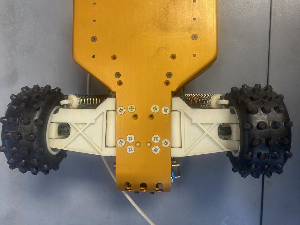

Does the original 2.25:1 stealth transmission just bolt in the 6-Gear tranny hold pattern on the gold chassis? NO MODIFICATION REQUIRED?
I've got a B stamp Championship Edition with the 6-gear. Dont want to drill the chassis. Looking at buying a stealth bc i want to run a faster brushless motor.

No. Unfortunately different screw size and different pattern.sbednara wrote: ↑Fri Mar 29, 2024 8:33 pm Does the original 2.25:1 stealth transmission just bolt in the 6-Gear tranny hold pattern on the gold chassis? NO MODIFICATION REQUIRED?

Doesn't the B stamp chassis have both the 6 gear and 2.25 stealth hole patterns?

I'm really sorry about that. I don't own a B stamp and wasn't aware they were holed for both transmissions.
So, we've both learned something new.
Edit: As it happens, there's a B stamp posted on ebay at the moment and an included photo clearly shows both sets of holes. I didn't notice this before.

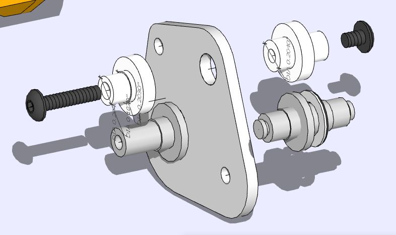

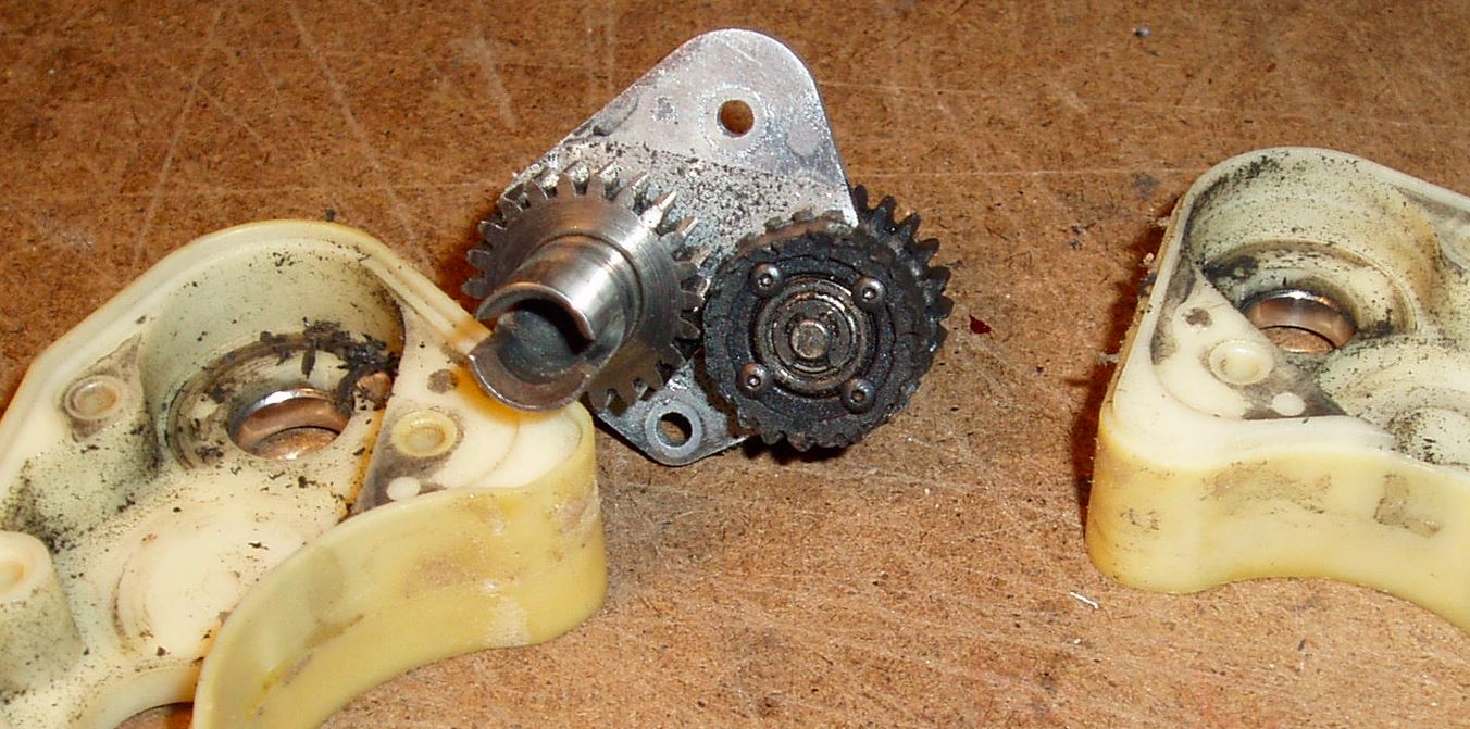

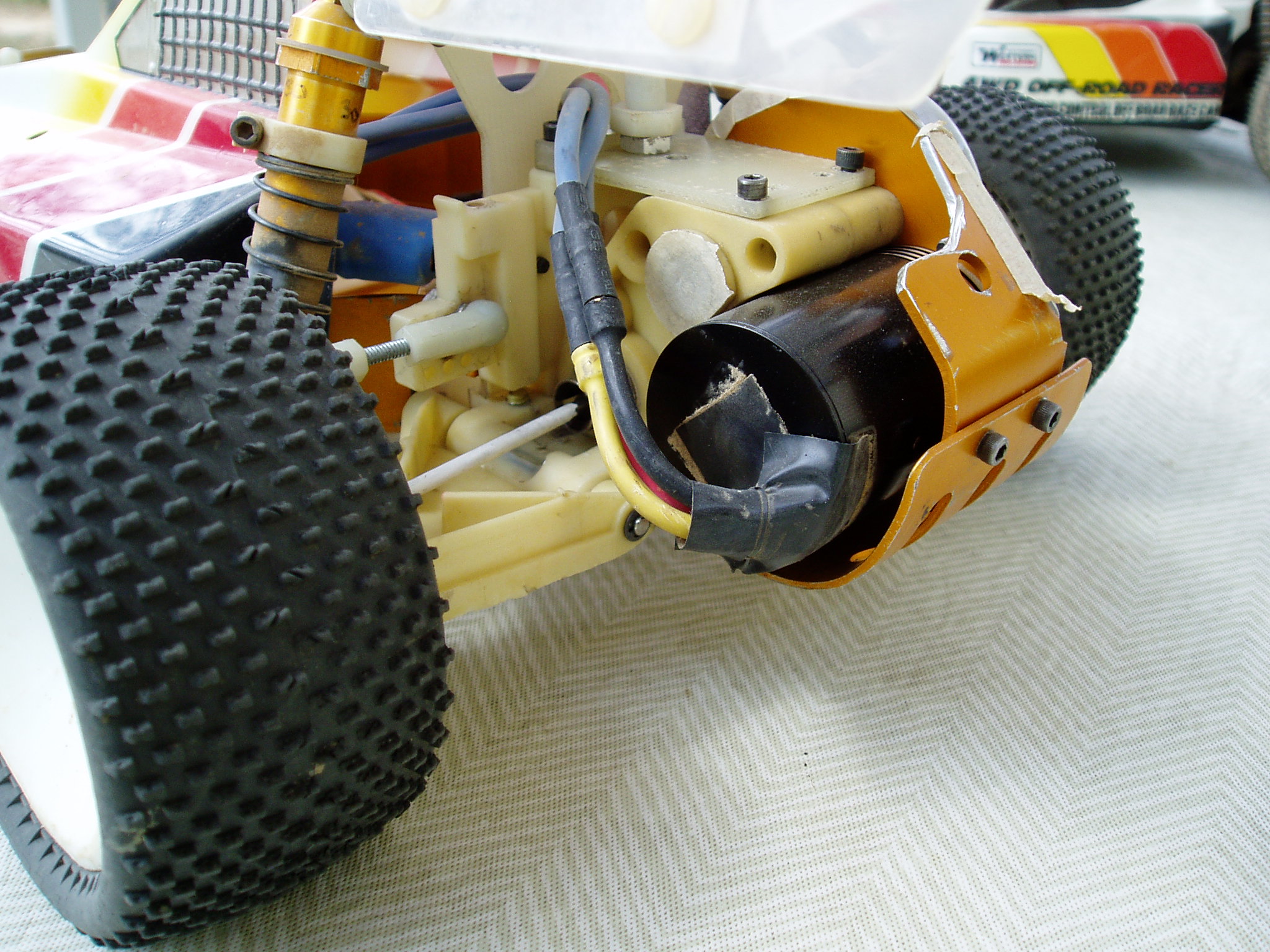

FWIW, I’ve been running this 6-gear short arm car with a Reedy 3500kV on 2s since around 2016…
…and the only transmission related problem came when the idler gear shaft E-clip broke. Apparently, the broken clip has allowed the shaft to rock in the spine plate resulting in stripped black nylon idler gears. In addition to the gears, the spine plate had to be replaced since the idler shaft hole had become elongated. I believe it’s possible that a worn spine plate actually caused the failure.
Anyway, I've made a replacement 2-part idler shaft from steel that is screwed to the plate. Since the repair, the car has completed several hundred laps and so far, it is holding together.
I reckon it’s easy to overlook the spine plate and E-clip and identify the nylon gears as the transmission's weakest components but the plate is soft aluminum and easily distorted and the bowed clip is essentially a spring that really doesn’t provide a positive lock holding the idler shaft tightly to the plate – certainly not as tight and secure as screw threads. Maybe a weak plate and a springy E-clip actually create the conditions for the nylon gears to fail.
A 6-gear can be made to endure brushless power but your most reliable option is to replace it with a Stealth trans or something similar.

A tiny amount of blue thread locker applied to each screw then, using a couple new hex wrenches, twist both screws together very tight so everything stays put.
