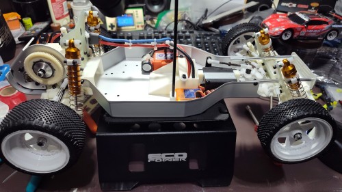

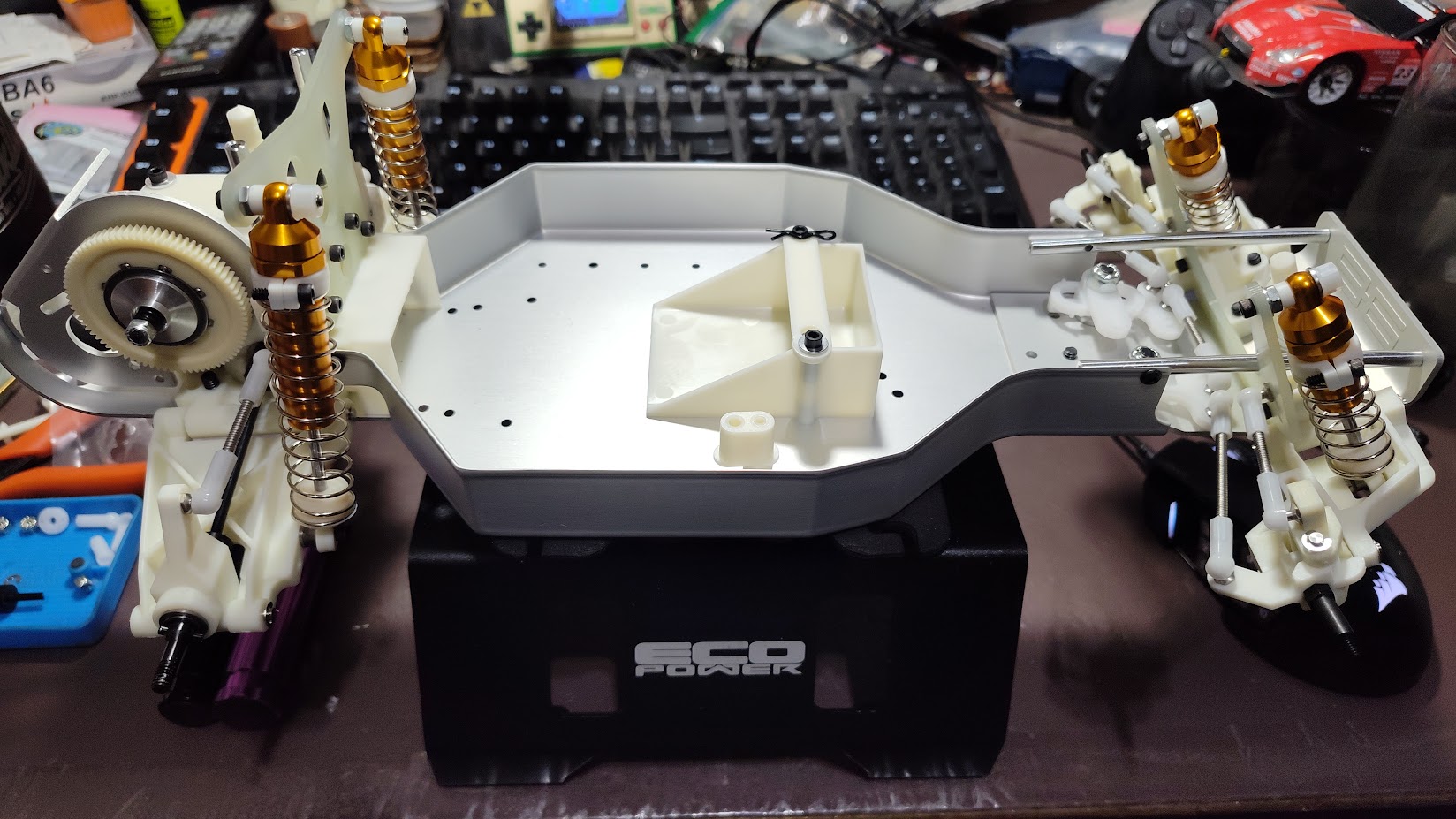

Got my 40th built as a runner. just need to add electronics and my wheel conversion.
Not gunna lie I kinda like how the ivory parts go with the silver pan kinda wish i had the silver shocks though.

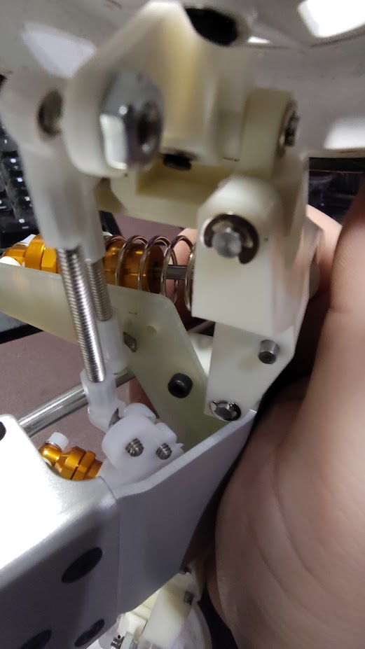

This is going to be used in the Silvercan Class so it's a Tamiya Sport Tuned, Novak GT7, and a Spektrum S6040 servo. This is stuff I pulled off of cars I'm currently not running. Also I've adapted the car to use Kyosho Turbo Scorpion rere wheels.
Couple things of note that I've found (these may be present on all short arm RC10s but this is the first I've owned):
  • You need to add around 0.5" of spacers and use the outside holes to the rear to keep it from drooping so much that the axles rub the arms.
  • Also needed to trim a bit on the front arms to keep the steering from hanging up on it when turning
