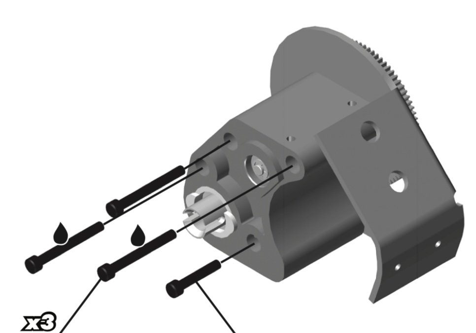

Ok, so now that we’ve hit the 40 year anniversary - Will someone please explain what the two holes are for on the top of the motor plate

same as some of our trailing arm parts, like the shock mounts with the 1/8" holes that are used to jig them up for drilling

Top Conspiracy theories:
1) weight reduction
2) rain drainage ports
3) chassis harmonic resonance tuning
4) aluminum conservation society requirement
5) top secret aerodynamic enhancement
6) 70/30 wt distribution
7) holy grail requirement
improved motor cooling
9) mounting holes for future super charger
10) make people ask “what these 2 holes for”

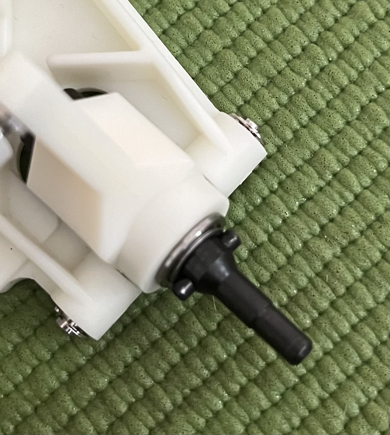

Just noticed that one of my rear stub axles is NOT threaded while attempting to install the rear tire lock nut.
3 of the axles are threaded, this one is smooth.
I opened an AE service request for a new axle and roll pin... will keep everyone updated on what they say.
VERY annoyed as this was the final step in the build and here I am removing e-clips and a roll pin and probably waiting 3 weeks for parts.
- Frankentruck
- Posts: 3808
- Location: Texas, USA
- Has thanked: 2604 times
- Been thanked: 2977 times
Re: RC10 Classic 40th anniversary
Do you know anyone with a tap and die set? Adding a 1/4-20 UNC thread (edit: actually 8-32 thread. Thanks Joseph!) wouldn't be too difficult. Very annoying though, yes. Someone else here had that happen with a Tamiya or Kyosho kit not long ago. I'm surprised this happens, but apparently it does. If AE doesn't get back to you quickly, I'm sure I have a stub axle I could send your way. Just PM me a shipping address.

Really appreciate that! Not tap and die set handy unfortunately. I'll give AE an opportunity to make things right first.... hope to report back with some good news.Frankentruck wrote: ↑Sun May 26, 2024 2:15 pm Do you know anyone with a tap and die set? Adding a 1/4-20 UNC thread wouldn't be too difficult. Very annoying though, yes. Someone else here had that happen with a Tamiya or Kyosho kit not long ago. I'm surprised this happens, but apparently it does. If AE doesn't get back to you quickly, I'm sure I have a stub axle I could send your way. Just PM me a shipping address.
- Posts: 1874
- Has thanked: 1243 times
- Been thanked: 639 times
The thread would be an 8-32 not a 1/4-20Frankentruck wrote: ↑Sun May 26, 2024 2:15 pm Do you know anyone with a tap and die set? Adding a 1/4-20 UNC thread wouldn't be too difficult. Very annoying though, yes. Someone else here had that happen with a Tamiya or Kyosho kit not long ago. I'm surprised this happens, but apparently it does. If AE doesn't get back to you quickly, I'm sure I have a stub axle I could send your way. Just PM me a shipping address.
The threaded part of the axle is far less than a 1/4.
