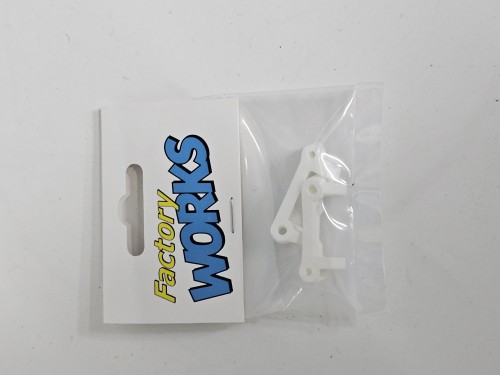

Several have asked about white parts. They are not as strong as the new pa12 black pieces, but it seems several are building cars for the shelf so I ordered in some white sla parts. I also added the front CVDs for short arm builds however they haven't arrived yet. The new platform won't require anything but the CVDs to use narrow arms now.
Still trying to get a checklist and instructions written up, but not getting far as I keep getting crazy orders that are consuming my time. Hopefully by next week we will have some documentation.
